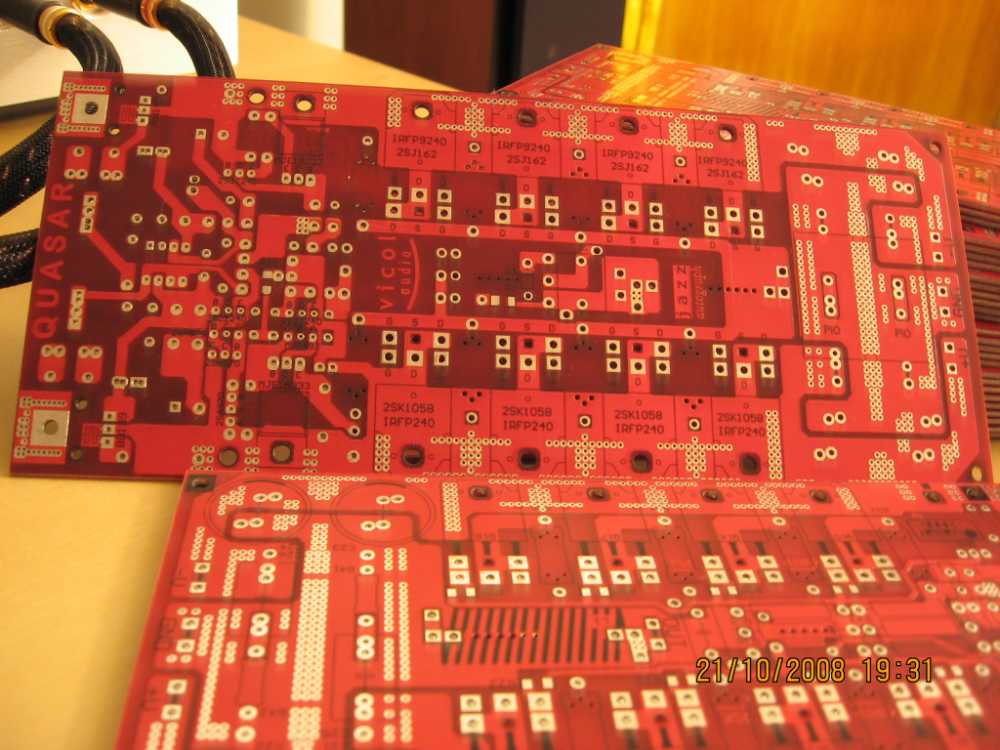

Re: New PCB
Hi Tibi!
Do you sell these?
My 405-2 is getting modded to death! 😉
Regards
tvicol said:Here is the new PCB.
Many Thanks to andiy !!! 🙂
Tibi

Re: Re: New PCB
Yes. PCB is 1,6mm double sided, with 70µm Cu and metalized holes. PCB's are quite large 210 mm x 91 mm.
PCB support SMD or DIL operational like LME49870 or LME49710 and a lage variety of components.
Can be made with vertical mos-fet's or lateral.
If you are interested, please see my web page and hit me a mail.
Tibi

Hi again Tibi!
I have re-read the thread a few times now, and have a few more questions.
1/
I would prefer the OpA to use the standard +/- 15V supply to enable easy replacement. Apart from changing the zeners, are there any problems with doing this?
2/
I would prefer to run at lower rails, around 45-50V. Any problems introduced by doing that?
3/
I was concerned by you mentioning thermal runaway for the dumpers. Is it possible to put them in class C to avoid this possibility (just like the original 405)? (I'm much more concerned about my unrepairable speakers being damaged than a little extra work for the class A stage!)
4/
I notice that you use two different symbols for grounding, but I failed to locate the resistor that splits small signal ground from power ground. How have you layed out the grounding for your amp?
Regards
1/
2/
3/
4/
Regards
Hello Patrick !
1. Change only zeners, but keep in mind that some opamps will sound better near maximum allowed voltage.
For me opamp search has ended since I found LME49870.
2. No problems with low voltage, just don't go under +/-30V
3. Thermal runaway can occur in class C as well. Bipolars will run faster. 😉 I suggest you to run this amplifier in class AB. It will sound sensible better.
4. A 10ohm resistor is between.
Tibi
Tibi
Re: Re: New PCB
Hej Patrik!
Just remember that these boards will not fit a standard Quad 405/405-2 enclosure.
Roger
