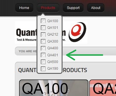

Is the product gone again from their website??
I went, instead of following the link, to products on their website and they only have Q400now!!!
What's going on??!
I was just there and found it with no problem using the regular product drop down.
What's going on??!
It's in drop down menu but not on the main products page ... Odd but seems they haven't updated that page yet
I just checked again for curiosity on my phone, which I can only see product page and no drop down menu, and still I don't see it there!!! I just don't understand what's going on with this product! Are they officially selling it or not?
It is there on the drop down list.
It could be your phone is not displaying the drop down list.
It's on the home page under products.
