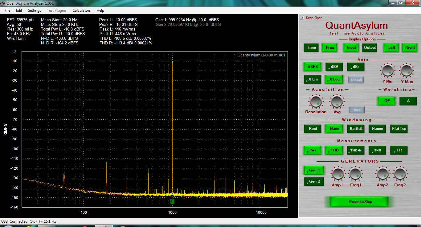

I am not talking about the analyzer, if I don't have any input, the noise floor is -130dBV, it's only when I connect the output to input and look at the 1KHz, when I adjust the 1KHz to 0dBV, then I can see 2KHz at -108dBV and 3KHz and -102dBV.
I think it's the generator that has the distortion, nothing to do with the analyzer.
The sweet spot for the QA400's input is about -10 dBFS.
The reason for the distortion is likely not the generator. The reason is the inherent increase in distortion in the ADC as the input approaches +3 dBV (i.e. 0 dBFS "full scale" or 1.41 Vrms).
In other words, to see the QA400's baseline distortion in loopback, set the generator(s) to -10 dBFS.
Attached is a screenshot of mine in loopback with both channels overlaid each other, tested one after the other from Gen 1. Notice the discrepancy between the left and right channel THD. This apparently is due to layout parasitics, according to QA themselves.
