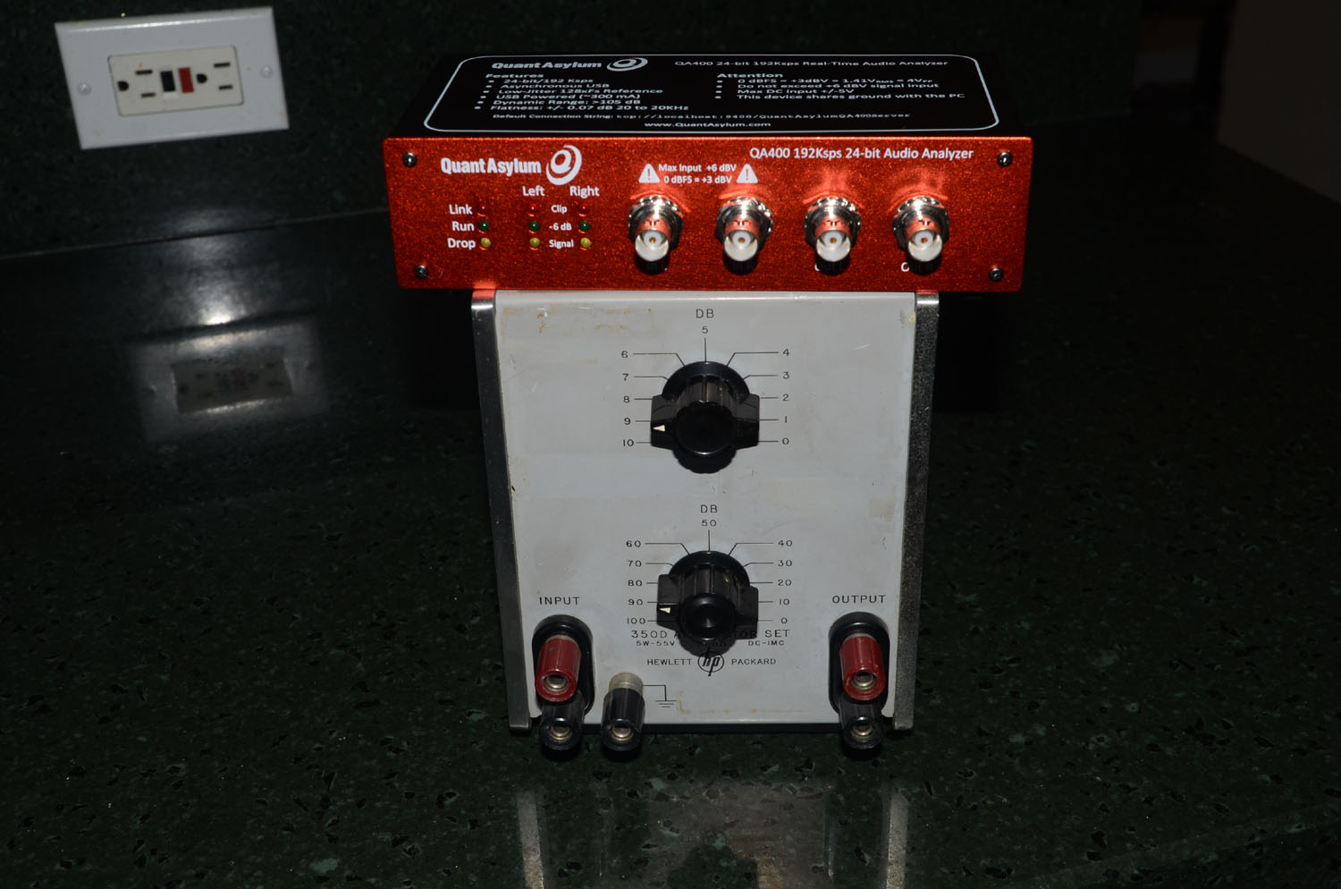

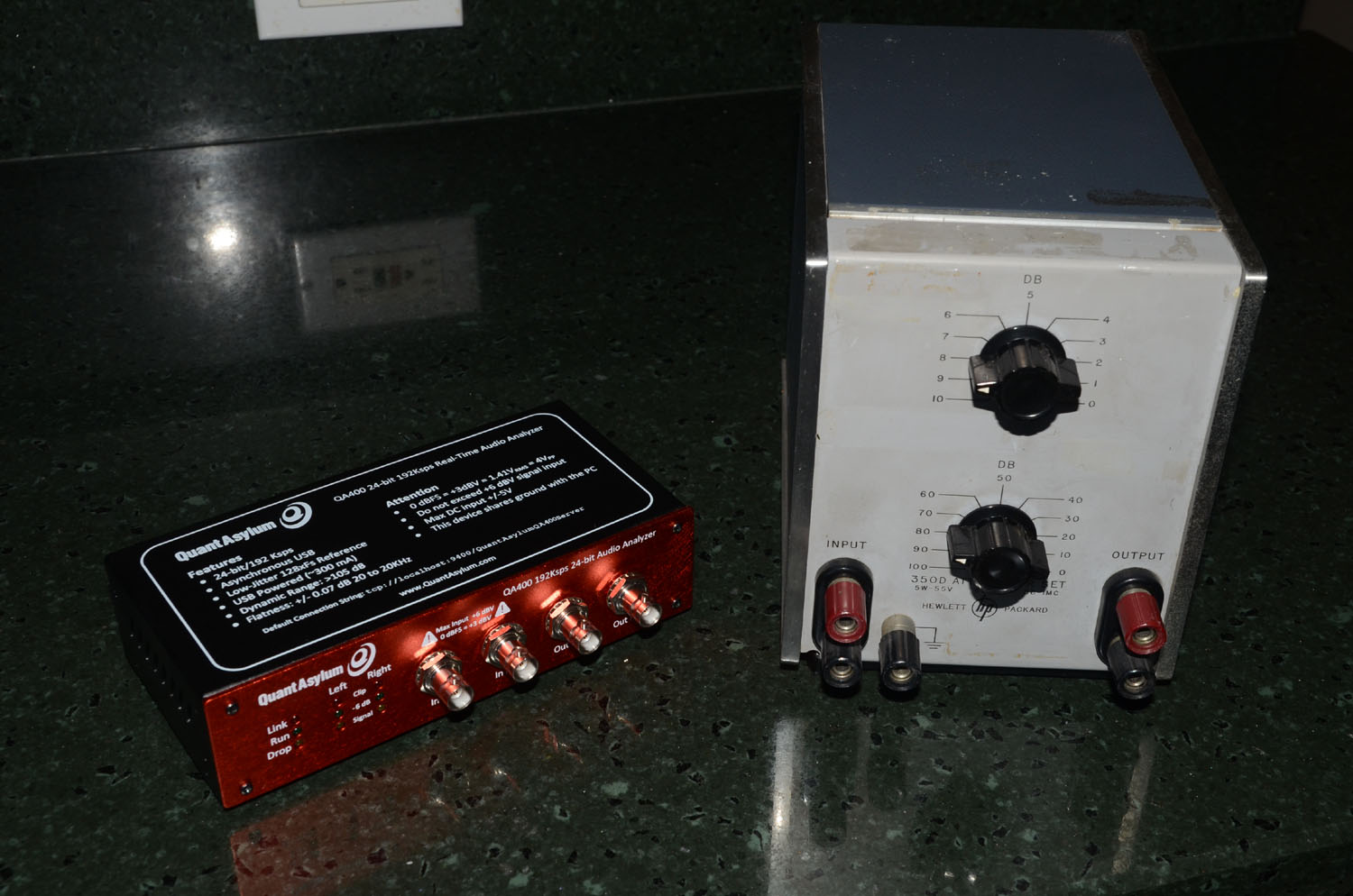

Received both, the QA400 is TINY!!! Not that it's important, but the picture make it looked a lot bigger and substantial. It's not any bigger than my Personus USB and the Personus chassis looks a studier and more expensive. Hope this works better than it looks.
I am surprised there is not CD or anything. am I supposed to download on their website? what to download?
Attached are pictures of my new babies to show the relative size with the HP which is quite small already.
I should be in business!!!😀
