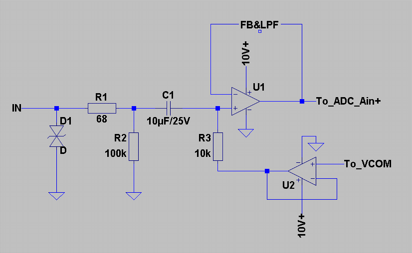

Actually no a 1 mega ohm could not be used. The resistor is connects to Vcom to bias the op amp input. The noise rises significantly with resistance. Mat tried it with higher value resistors but the noise is too high. They would have use 1k if they could get away with it.
It really depends on how you drive it and how you test the noise. If you really want to measure the noise of the QA400, you need to terminate the input with the normal source impedance before reading.
Important to note. You CANNOT look at the noise by leaving the input open. If you leave the input open, then you read the full thermal noise of the 1M resistor. Make sure that person terminate the input when reading the noise of the QA400.
The noise is calculate with the parallel combination of the source's output impedance in parallel with the input impedance. The point is if you have 1M resistor for biasing the input, you plug in a device with 1K output impedance, your noise calculation is 1M parallel to 1K which is just 1K. If one found using 1M increases the noise with device plugged in, something is really wrong.
Quite so. The input impedance is what ever the DUT output impedance is plus what ever
series Z at the QA400 input. But because of the Vcom bias arrangement the noise rises with the Vcom supply resistance and this is QA keep the value low. I worked with Mat on this a bit
just before the QA400 was officially released. The Vcom is extremely sensitive to the reactive and resistive load on it as well. It shapes the noise floor curve of the ADC. Any influence from input loading plays a part in the noise shape.

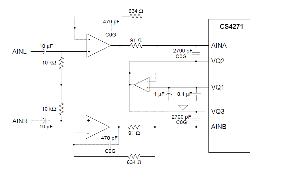

I don't understand what is Vcom bias arrangement. I don't have the schematic. But I cannot see any reason the input is nothing but a simple voltage buffer driving the ADC. Maybe you can explain a little more on what they are doing.

I actually looked at the data sheet of the CODEC CS4272 used in the QA400 in order to put this into some context:
http://www.cirrus.com/en/pubs/proDatasheet/CS4272_F1.pdf
If you look at Fig 12 page 32. Vcom is just the common mode voltage to bias the input of the buffer to some where in the middle between ground and Vcc because the CS4272 is running on single supply voltage.
The gain of the two buffer is just unity. the 91ohm and the 470p cap is just to prevent the opamp from oscillating when driving capacitor load. There is ABSOLUTE NO reason the two 10K resistor cannot be change to 1M. You even can extend the frequency down to lower frequency. There is no excuse on higher input resistance cause offset as OPA1642 has jFET input and offset does not matter for AC analyzing. Only extreme offset cause clipping on one side of the ADC, nothing more.
as I expected, this is a very simple circuit, just a simple buffer. I am surprised they did not bring out the differential input. Maybe, they want to sell the QA190!!!

I suspect whoever claim 1M cause noise, ran the noise reading with the input open. Then you read the full thermal noise of the 1M resistor.
The QA400 was designed to meet a particular price target. I can assure the people at QA know what their doing. There is quite a number of heavy weight industrial guys involved Motorola and Microsoft to name a couple. Like Demian said it was designed to target a market in China. Assembly lines as part of they quality control. As a side market it's offered to hobbyist. I pretty sure most of us here understand loading inputs when taking noise measurement. It's kind of elementary don't you think.
If you read the data sheet further you'll notice Crystal recommends not to exceed 1uF of capacitance for filtering on the VCOM pin. If this maximum value is exceeded the entire noise shape of the ADC changes. The noise increases starting at about 1kHz and rises with an upward slope as the frequency approaches 10Hz. Kind of looks like 1/f noise but it's not.
This effect has nothing to do with what op amp is used for a buffer and has nothing to do with input loading. It's inherent to the VCOM of the ADC.
I was in the beta testing group for the QA400 and I introduce the QA400 to the DIYAudio forum. I have substituted the 10k resistor for 100k resistor from the VCOM to op amp input and the noise went up regardless of input loading.

I really want to find out because with 10K, it is hard to do current limiting as you have to drive with low impedance. If I can get it to have high impedance, I can use a series resistor to drive the input and protect the QA400. I asked the same question to them also, they said they are planning to increase the resistance.

I forgot the VCOM is buffered by an OPA1641. You can swap the 10k resistor for whatever you want.
The code used is the CS4272. However QA used the recommended circuit fron the data sheet for the CS4271 mono codec. It the same codec as the CS4272 less one.
Substitute my drawing of the QA400 input circuitry for the CS4271 schematic as necessary.
Everything past the input caps of the 4271 schematic is correct.
The op amp QA used are OPA1642 and OPA1641 or 2 for the VCOM buffer.
