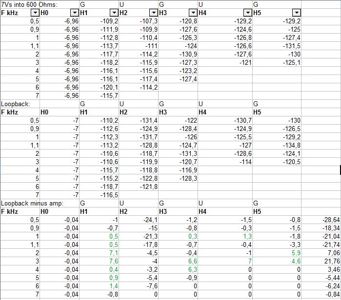

Just a couple of THD measurements I did with a QA400 connected to a headphone amp, they indicate quite clearly that the QA400 cannot realiably measure anything below -100dB as has been noted earlier in this thread.
The upper table shows the QA400 connected to a blameless-style headphone amplifier. The load is a divider made from a 560ohms resistor and a 39 ohms resistor. Output level on the QA400
was -7dBV; the amplifier has a gain of 16 and puts roughly 7,15Vrms into 600 ohms; the divider attenuates the signal to approx. -7dBV again.
Second table shows the QA400 in loopback-mode.
The third table shows the difference of each harmonic calculated as "loopback minus amplifier".
Positive numbers thus indicate that the harmonic coming out of the amplifier was actually *lower* than in loopback mode whereas negative
numbers show distortion that is presumedly produced by the amplifier. The rightmost column is just the sum over all substracted harmonics (note that @3kHz the amplifier output seems to have significantly lower THD
than the DAC that feeds it - now how's that possible?)
Amplifier distortion and internal distortion in the ADC/DAC seem to partially add or cancel. -120dBV would be a mere 1uV... I wonder if the QA400 can really measure that accurately.
The headphone amp has a class-A output stage and produces neglible distortion (<0.00001% @20kHz) in LTSpice.
I was hoping to verify its performance... maybe a bit naive to think that a $200 product would allow such
precise measurements 🙂
On to the next project then - a deep notch filter with a x100 gain amplifier to bring those distortion
product up to the QA400's usable range.

The problem with distortion cancellation which you sighted can just as easily happen with a $25k analyzer as with the QA400. The question is can any analyzer measure accurately at its residual. The answer is no. You can improve the accuracy of the QA400 by suppressing the fundamental by either the null method or a notch filter. The problem is not so much with the digital as it is with analog input circuitry.

Just did another test with the headphone amp replaced by a LME49860 "ultralow-distortion" opamp into the same 600ohms load. Same result: there is serious rise in harmonics at 1 kHz whereas THD at 2 kHz and 3 kHz is actually lower than in loopback-mode. At least this confirms the distortion is not from my amplifier.
