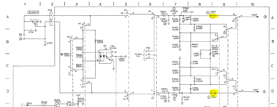

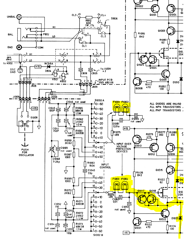

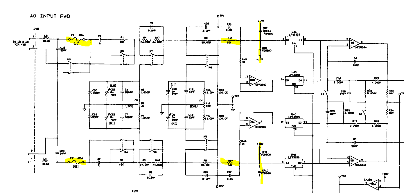

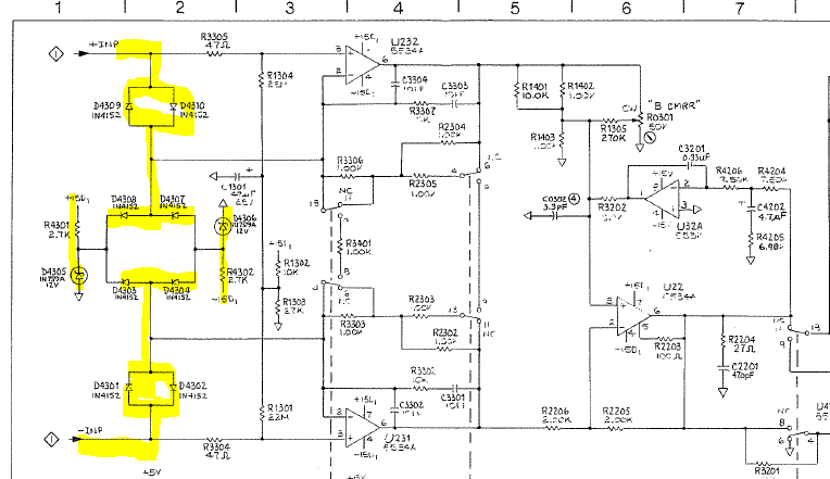

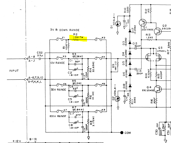

For reference I'm attaching four different input protection circuits to study. The Shibasoku uses a 7W resistor to handle the 100V max. The Boonton will work up to 300V and uses big resistors as well. The Amber and the AP use light bulbs as does the newer Shibasoku. The lamps are preferable because the cold resistance is perhaps 20% of the hot resistance making for lower noise in operation while not sacrificing the high voltage protection. The challenge is finding lamps for the application. Finding a 220V 3W lamp that is small is virtually impossible in the US today.

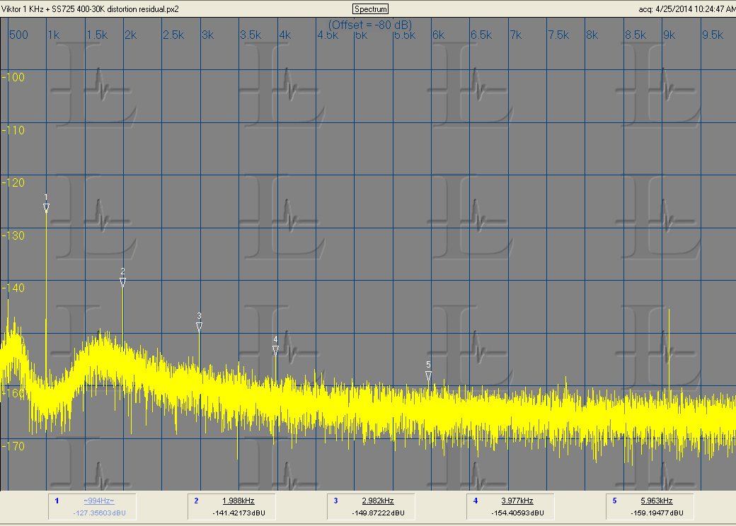

Accepting that the QA400 is usable to -100 dB that puts it in the same class as a stock HP339 (and even an AP1 per specs) and it has a good 10-20 dB dynamic range without really degrading the specs I think this is overdoing it. Especially when the input box is 4-5X the size of the QA400.

For a really good input current limiter see US patent 6970337. The cited references also provide good guidance on simpler (and not patent protected) solutions. Fluke too has several patents on this topic (e.g. US 5379176, US 5196980 and US 8582265), although more complicated and not necessarily suitable for low distortion applications.

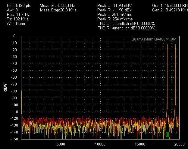

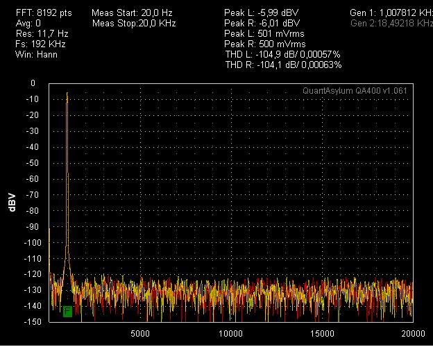

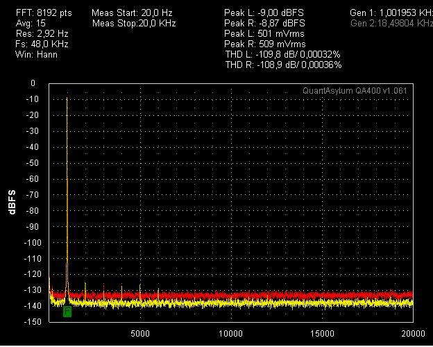

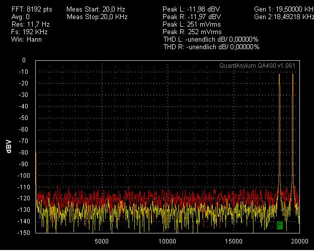

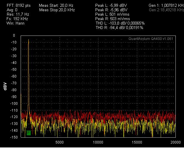

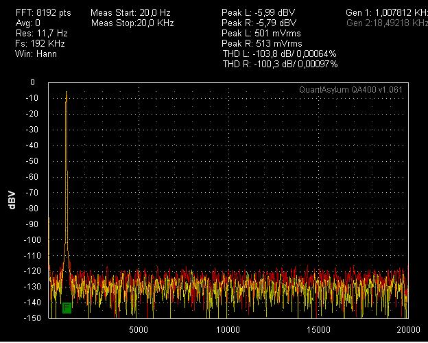

Here the results with 192ks.choco, perhaps run the same test(s) with the bandwidth up at 192, and avg = 0 and avg = ~10?
First two pictures show the QA direct wired in loop back.
Then the following pictures are showing the left chanel in direct wired loop back as reference and the right chanel with buffers and filter.
The results are showing the behavior at buffer output levels of:
180mVp (picture 3&4)
700mVp (picture 5&6)
6Vp (picture 7&8)
The input was always readjusted to provide 700mVp to the QA400.
They would be much more useful with the resolution turned up. I think 65536 will show much more low level detail. Your current setting gives an 11 Hz resolution bandwidth so the noise floor is much higher.

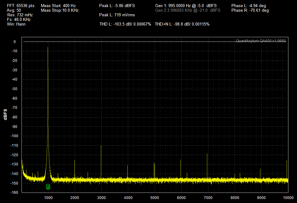

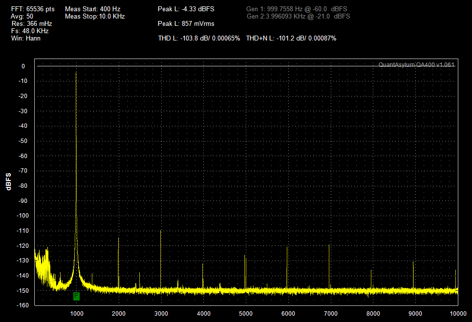

Here are the residual distortion measurements of my QA400
First is a selftest 48 KHz (left out to left in at -4 dBFS 995 Hz for all the measurements), 192 KHz selftest, 48 Khz using Viktor's 1 KHz oscillator and 192 KHz with Viktor's oscillator. Finally the same source through the Shibasoku 725 and captured with an EMU 1616M, scaled to dB below the full signal to verify that the source is much cleaner than the measurements (as Richard pointed out the residual distortions of the codec limit the system to around -100 dB to have confidence in the measurements).
I would expect most QA400's to get around this as a selftest. The cables that came with mine were an issue, the BNC's didn't quite fit so I ditched them and this was using a Pomona RG179 BNC to BNC cable.

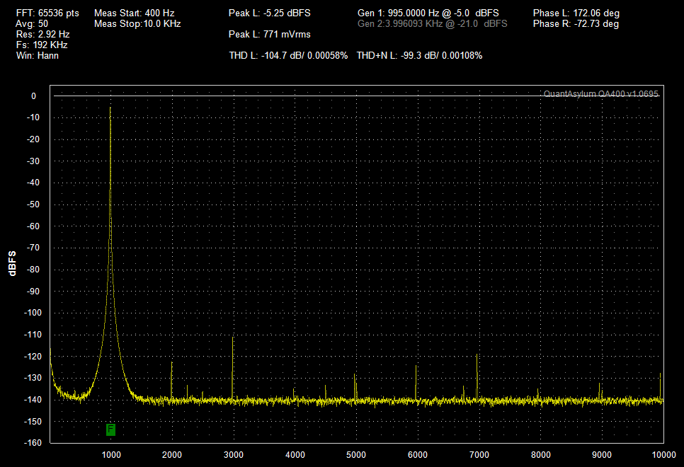

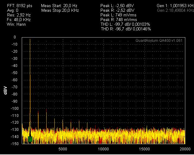

With such high levels (700...800mVrms) also my QA400 is showing similar distortion like yours. That's why I am using 500mVrms
Attached the loop back with Fs=48kHz with direct wiring.
First picture with 750mVrms.
Second picture with 500mVrms.
The 500mVrms, or better say 700mVpeak, appear to be the sweet spot of my unit.
So I am always adjusting to work with 700mVpeak, means for single tone the generator is 500mVrms (-6dbV or -9dbFS).
For dual tone each generator shall work at 250mVrms, means 350mVp, (-12dbV or -15dbFS) summing up to 700mVp at the highest moment.
How does your unit look at 700mVp instead over 1Vp?

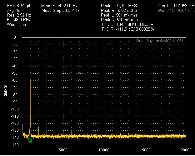

...averaging makes things less fuzzy. Sorry for ignoring that earlier.

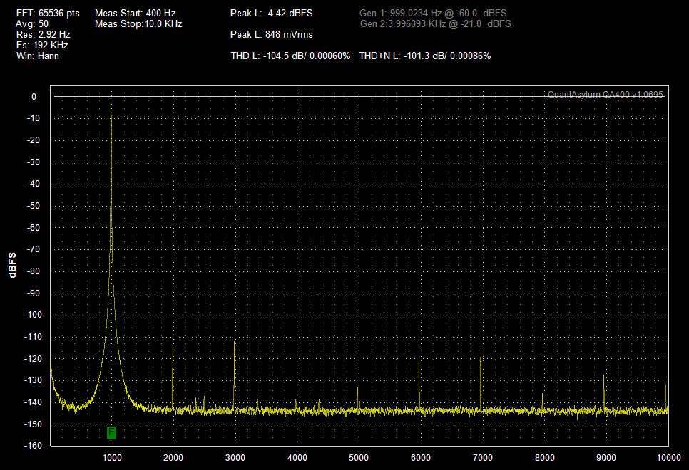

First picture the self test a 500mVrms with FS=48kHz and avg=15.
Second picture also 500mVrms, FS=48kHz, avg=15, left chanel selftest for reference, right chanel with buffers and filter.
I'm using 600 mV and have not seen a dramatic change with lower levels. 500 mV to 600 mV is 1.5 dB. Please try a higher resolution on your measurements. 8192 is really low resolution, useful only for very fast acquisition of a measurement.
What I see is that the noise floor is higher with the buffers (not unusual at all). If you turn on THD+N you will see the difference in noise. As long as the noise is lower than what you are trying to measure by 6 dB or more you will get accurate measurements.

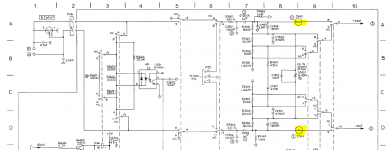

I used the PS transformer in the tube power amp and added a tripler to it for the high volt. Signal still came directly off the plates thru a coupling cap. Got a lot of voltage swing that way.... cheap. [And terminated the OP Transformer into a dummy R.] And, the signal was cleaner as it wasnt going thru an OPTransformer nor any audio step up transformer. . You could even replace the OPT with a resistive or inductors to make the OPT benign.
Here are some more rough idea generators -- example of what I was referring to..... you can use internal range selection, as shown, or use the range output ports to drive relays. Ports RA0,1,2 and ports shown as C1,2,3,4 would work as outputs to relay drivers to select attenuation.
View attachment Auto-scale 1.pdf
View attachment Auto-scale 2.pdf
View attachment Auto-scale 3.pdf

FFT accuracy --- pls see again line #505 and #520 and #594, 595 and 596.
Many such tests show the ADC in the QA400 isnt accurate below about -100dB. The specs from the company indicates -102 -105 max also.
