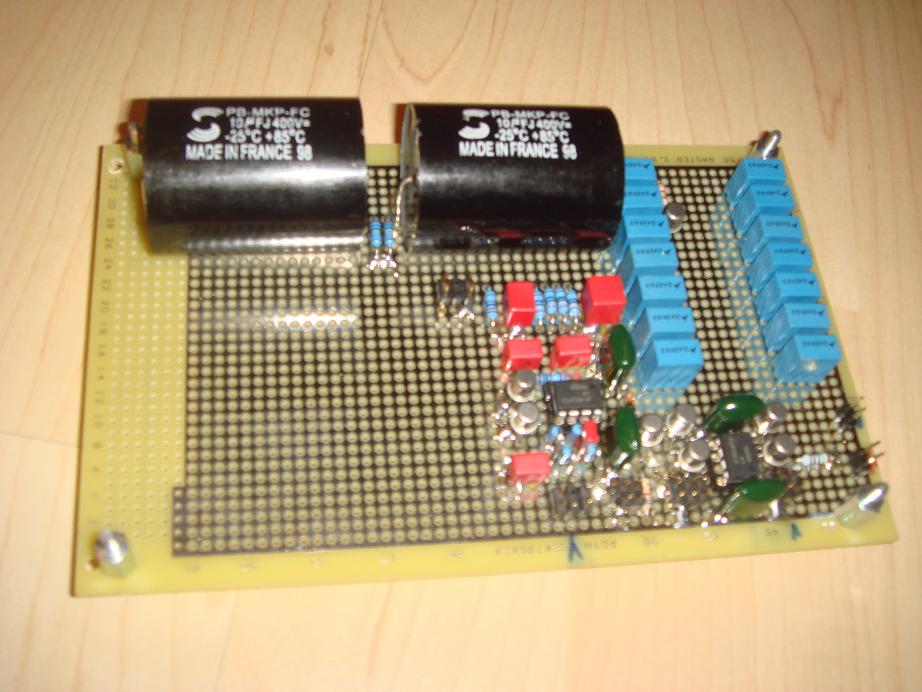

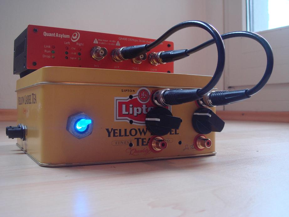

So I decided to build buffers and filters.
The output buffer allows a wide output range from zero to +/-5Vp without noticeable change in behavior.
The input filter is 5th order, flat up to above 50kHz, but fades 200kHz with more than -40db and 400kHz more than -70db.
It allows measuring signals from line level up to approx. 100Vpk.
The buffers & filter also protect the QA400 in case of heavy melt down events of the DUT.
Overall a slight worsening of the noise is there, but still fine for distortion measurements.

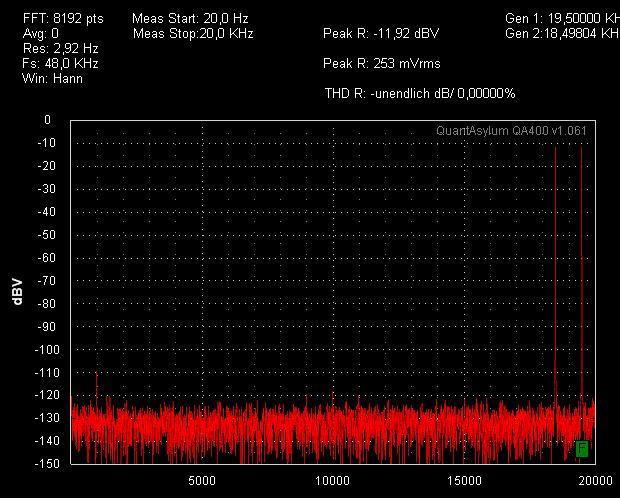

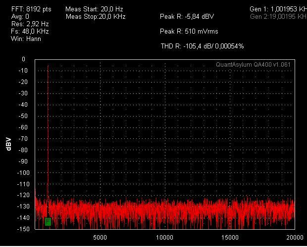

Attached some pictures and results.
The performance is stable over very wide ranges of input and output voltages.
...ready to measure future class D projects 🙂 ..

That's interesting. Care to share a schematic?
Of course I can share the schematic.
Very straight forward, nothing that I would call key know how.
Attached the most updated schematics, the filter function now fades out the 200kHz with -39db and 400kHz with -69db. Function is now flat at all poti positions.
In reality I used different OP amps. LM4562 for the output buffer and OPA2134 for the filter. But basically lots of OP amps will do the job.
Suppy is +/-9V from two 9V batteries.
For the poti of the output buffer one might consider a lower value, because the 1k resistor towards the OP amp impacts the log characteristic - but also with a 10k poti it is perfectly fine and I had it available. Also the 10k avoids unnecessary loading of the QA400.
But important is to use the right type of potis.
Funny thing: Some quality types caused k2,k3 around -80db, while some old low cost types turned out to be simply trouble free... 😛
Nicely executed. I like the casework. Is the input filter to remove stuff that might impact the measurements like switchmode amp noise? I noticed that you also have diodes at the inverting inputs of the opamps. That's a neat protection trick. Unfortunately inverting amplifiers are going to be low impedance and that can impact some measurements with devices that have high internal impedances. The pot is your primary input divider in this circuit. With an inverting amp at the input higher impedances may be possible with some scaling. Noise would be the downside. The input filter could be on the output of the opamp with the opamps you are using with few negative effects.
