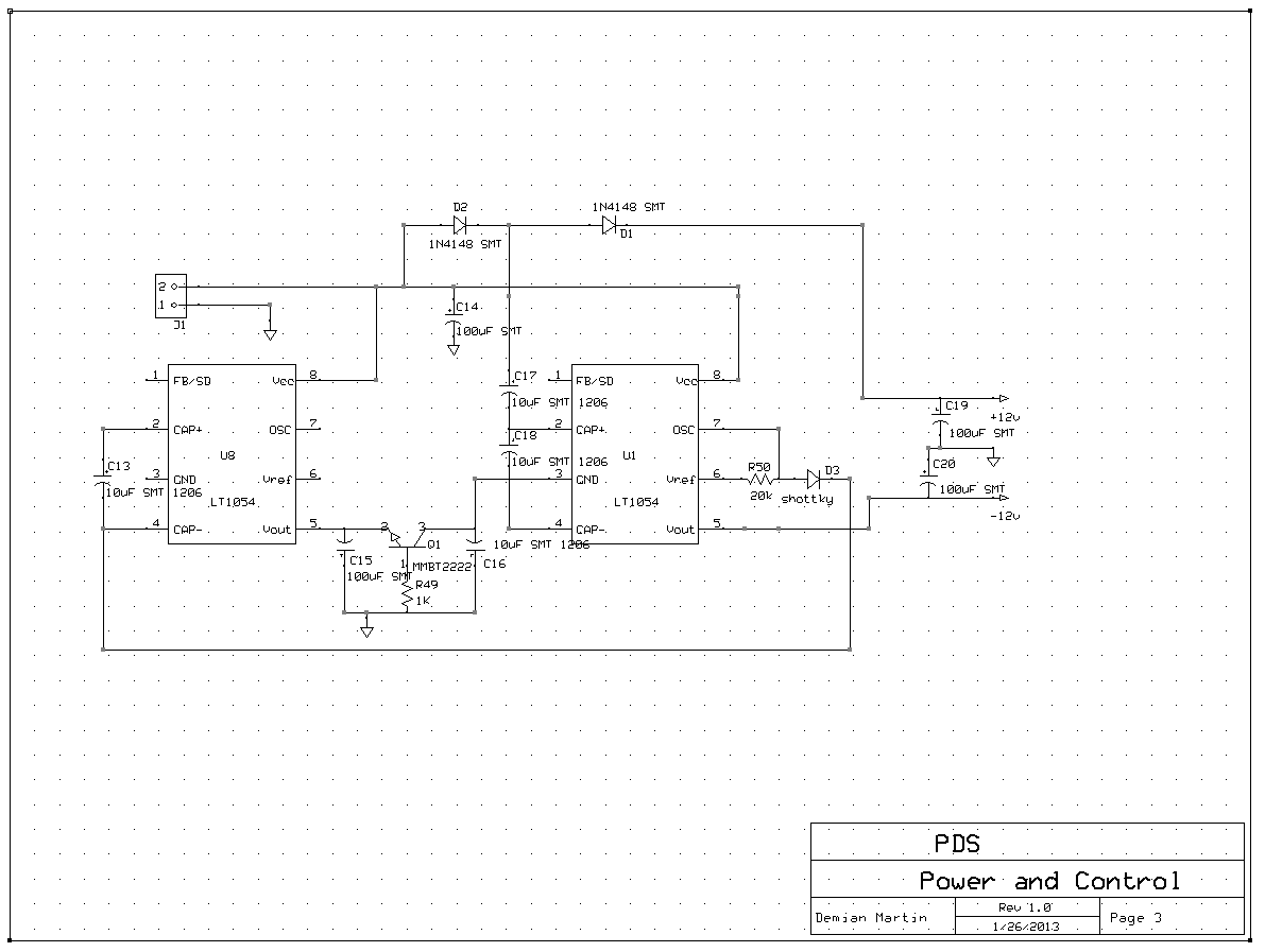

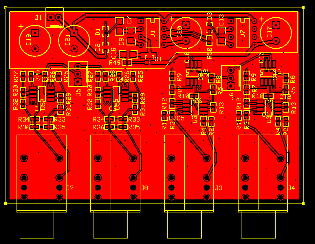

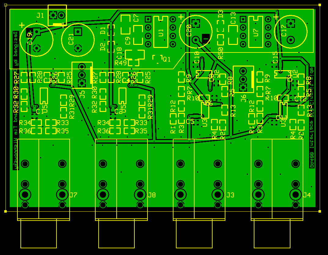

Attached are the expressPCB files for my new version. I have not fully checked these files so if someone else is up to the task it would be great. Expresspcb is not really easy for this denser surface mount stuff. Everything is connected and I don't think there are any shorts. If anyone else is up for loading the files into expressPCB and checking for mistakes I would really appreciate it. I will get a set of PCB's ordered in a week and see how successful I was.
This is way more complex and involved than the first gen. Don't feel bad if you find the schematic or the layout hard to follow. I also find this one challenging. I'm trying to use the latest ideas on ground planes, bypassing etc, even though they probably are not significant at the audio frequencies involved.
Just curious why you chose to use the charge pumps for the split rails? Are ripple and noise not a concern here?
In my testing and in the previous generation using a switcher the supply noise is not an issue. There is enough PSRR to meet -150 dB noise levels without a problem. Grounding is important or the noise can appear across the grounds. When I have boards I'll be able to verify that the noise of the charge pump won't couple back in.
The switcher on the first gen is too pricey ($15) and sucks too much power all by itself. That and simplifying is why I chose this solution. If there is an issue my fallback will be to use a clockable charge pump and lock it to the word clock. We will all know soon.

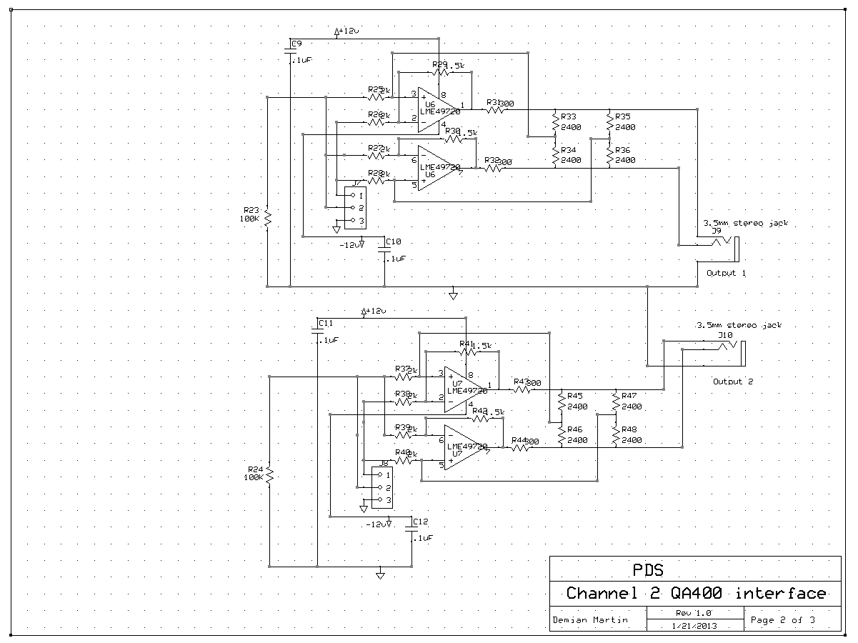

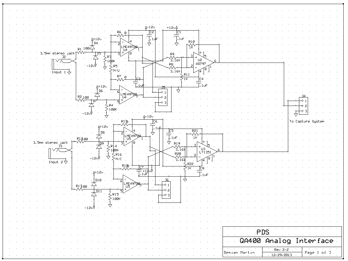

Demian,is it true that you use the different OP at both outputs at the 1st schematic?Attached are the expressPCB files for my new version.
That was never part of this. The adapter-cables do the scaling as necessary. Since the QA400 would not know about the autoranging you could get really confusing results.
From what Matt has leaked about his next effort it seems time to make the QA400 useful as is and wait for a more capable device if you want. Expect it to be 4X-5X the cost of a QA400.
My goal with this was to get differential inputs and self balancing outputs with higher levels that would be compatible with home audio levels. And to be able to fit it inside the box.
That's a typo. I'll be trying several devices to see what works the best and still is cost effective. Fortunately the footprints are common. I may rescale the impedances to lower the noise.Demian,is it true that you use the different OP at both outputs at the 1st schematic?
What happened to the input auto-ranging idea?
-RM
I have layed out a board with a small ucontroller to run a Boonton input board as autoranger. Just waiting for my next board order to tack it on.
The board also has an RMS converter and a small LCD so I can actually display RMS signal value and attenuation setting. I plan to use the Boonton overrange comparators (with modified thresholds probably) as 'too high' - 'too low' sensors.
