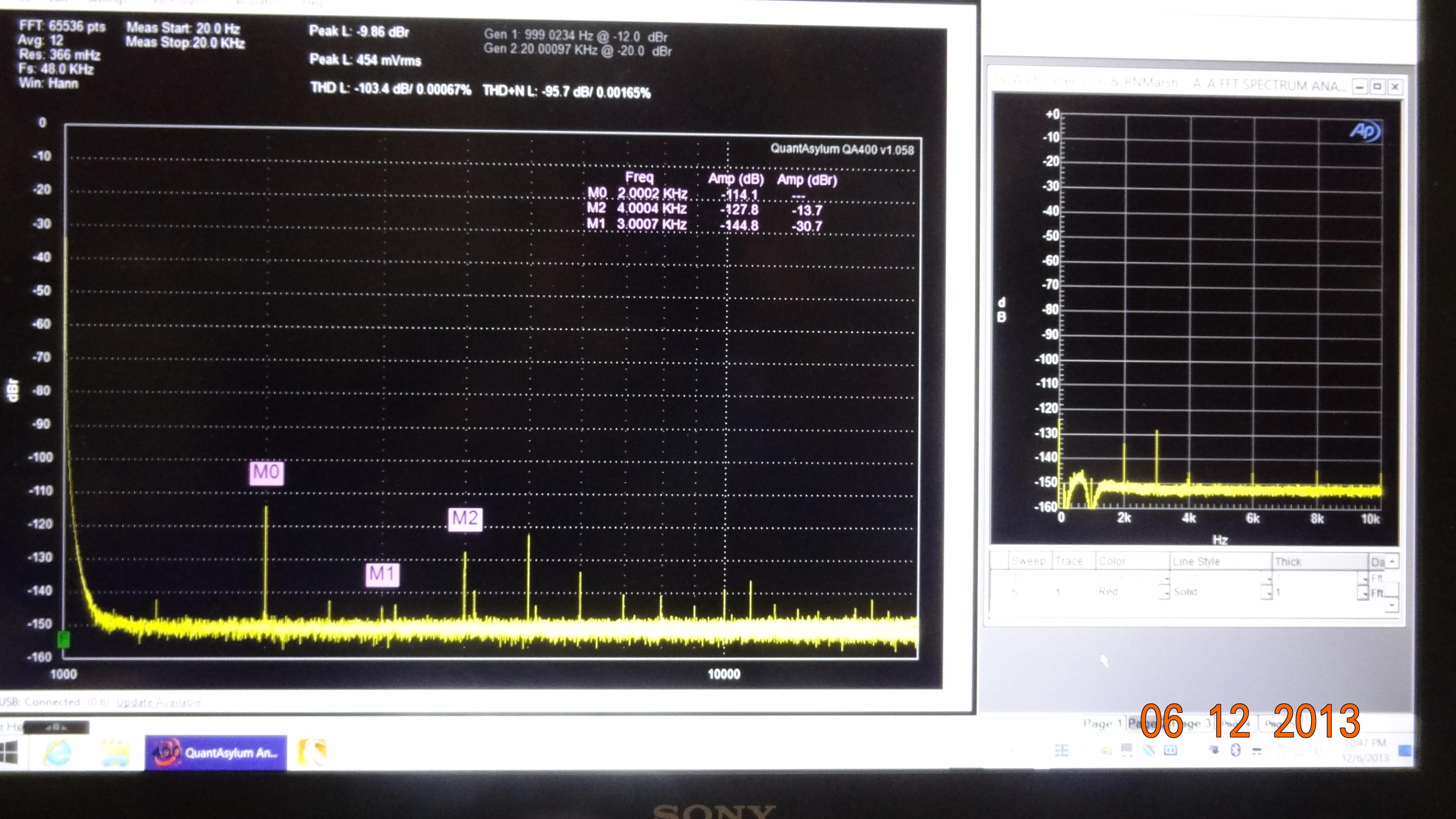

Then with a slight change in input level and you could get this --
With a nulled 3H. 😕😡

Richard, jou might see reinforcement or partial cancellation, alternatively, at these low levels.

Richard, you might see reinforcement or partial cancellation, alternatively, at these low levels.
Jan
yes, I believe that is the case.... for those using sound cards and QA400 etc... they need to take their DUT test data results below -100dB with a 'grain of salt.' Or, just ignore it. I would scale the dB's to only go from 0 to -100dB.
There are many improvements with the more expensive test equipment which do not have this affect until extremely low levels or not detectable at all... just noise contributions to errors.
I also suspect it is related to the notch filter in some way -- because the only comparative difference I see between the A-P and ShibaSoku is at very low levels and only to the 2H.

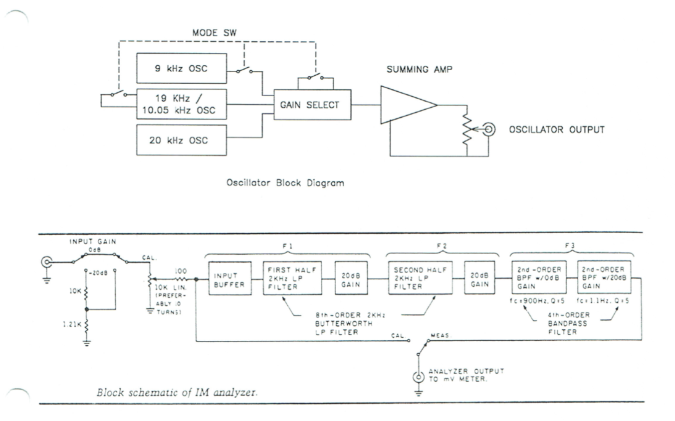

Getting parts for the existing units isn't necessary. It works as planned. I think I know how to get another 20 dB out of it, maybe more. Its all wirewrap construction and bolted together in a way that makes access to the PCB's difficult.
Below is a block diagram of the box.
It looks very do-able. Not much complexity to it.

The IM box I have is a breadboard. The project looks like it was slated to be an article for Audio Amature or something similar. Chucks documentation is really good.
The limitation I have found is noise, the sources noise swamps its intrinsic IM. Using two external oscillators I can get a residual from the analyzer of -126 dB, but I need a narrow band spectrum analyzer to see it. I'm hoping some tweaks here and there will improve the effective SNR of the system.
