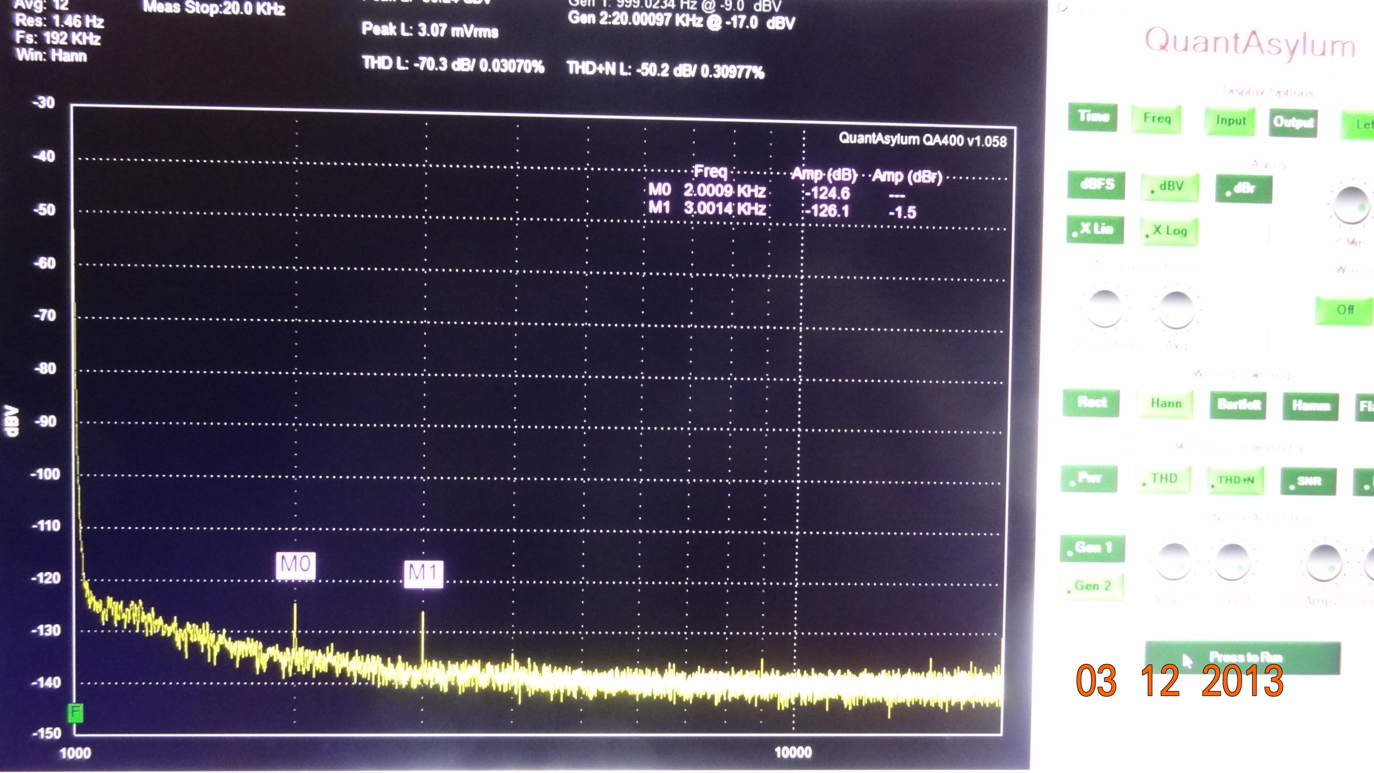

The 2H is always too high and stimulated and present at any level. The 3H is level variable. The 4-5H are minimal at lowest levels and continuously increases with input level.... those are not present in signal source. So it is a complex variable which might not lend itself to a simple error correction look-up table. Might be a combination of ills.
Here is an example at approximately .5 volt (no notch filter) of the complexity of the issue. The right is the source (ShibaSoku AG16B) as measured by the A-P and the left, is the QA400 harmonic data. --- not even a close approximation.
Later, I have played with the B&K 1607 as the notch filter with mixed results. Will try again.
Thx-RNMarsh

The datasheet for the codec only claims something like -95 dB distortion. I don't think you can expect a lot more.
Demian

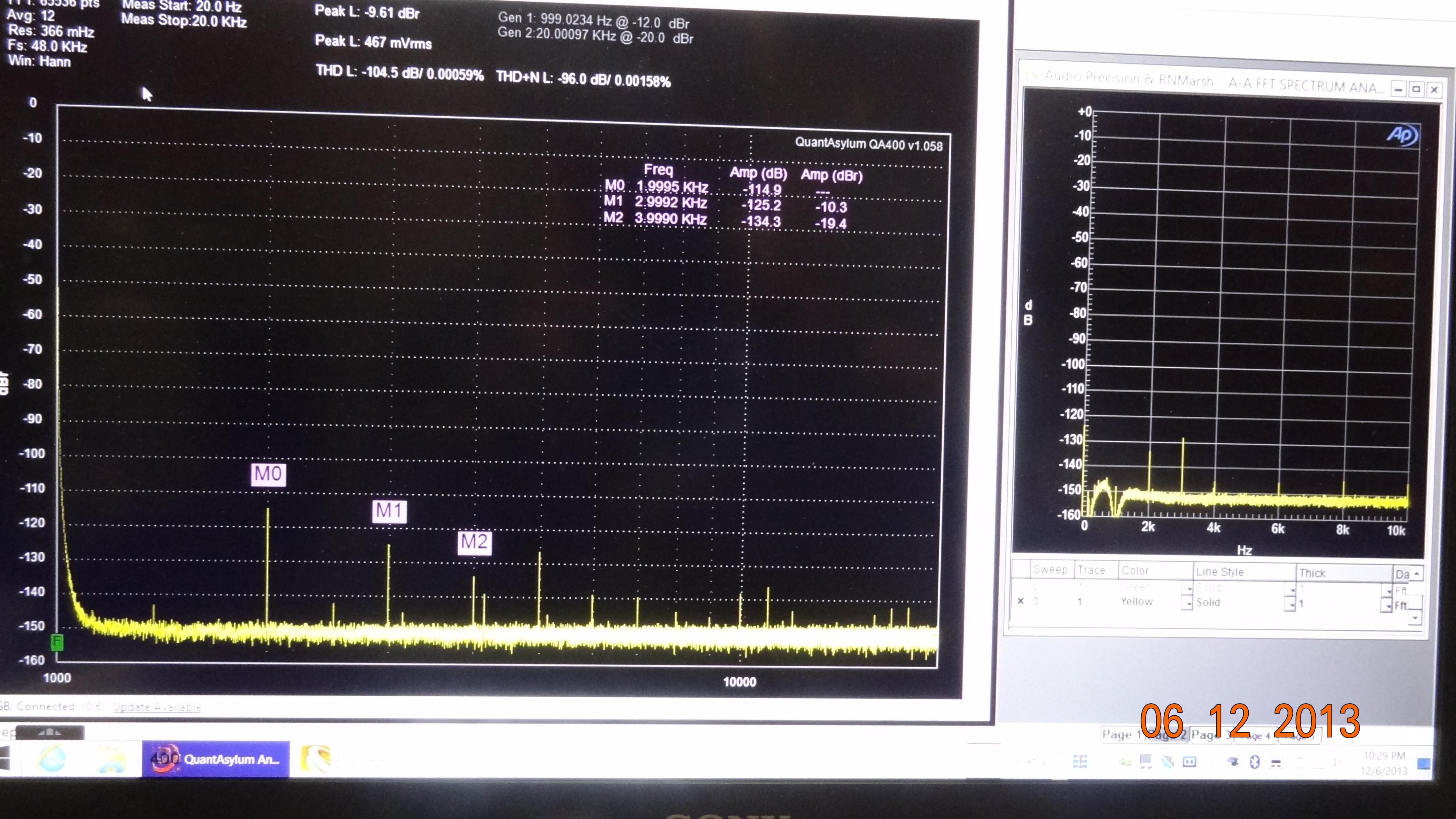

That doesn't surprise me... Do you think buyers of the QA400 know that? By my measurement, I said that I wouldn't use it below -90 and not with an input greater than -10dBv.
Next up--- who make the best sound card using the best codec? Is the e-Mu 0404 one of the best? The noise floor might be very low --- is it accurate has been my question.
With a notch filter, as A-P and many here and else where have done, it can be better. AND, that brings us full circle back to the features of a notch filter...a few fixed freqs or auto-tune or variable? These are options for the DIY'er. Having used all these types of notch filters, I would not be happy with a few fixed freq BUT it would be the cheapest. It would still have to be checked for accuracy at low THD levels.
I bought two QA400 a long time ago and found it not to fit my quest. It has not been my interest to use a QA400 since it does not go below-100dB accurately. But just to help others and show the true limits of its' capability....in terms of accuracy.... I did some tests regarding accuracy for them.
For many it is fine without a notch filter....as are many 'sound card' type products. I like the software integration which makes it P-N-P to use. Though I had problems with it initially. Those issues in software seem to have been resolved.

How about using both QA400 channels for one test and get some noise and distortion reduction? isn't this something QA people has info on?
-- or what about using a stereo ADC and doing a sum or difference with it? Like in Cirrus Logic AN331? Can this be done by mod'ing the QA400?
