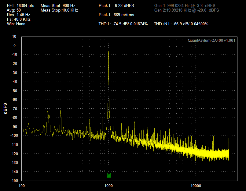

Some QA400 measurements
Here are some measurements of my QA400 under different conditions.
The source is my tweaked KH4400. At present when measured with the 725 at 3V out the second harmonic is at -127, the third harmonic is at -136 and the rest around -145. I have some more ideas for it but its good enough for now.
Fist the QA400 is running from my laptop. When the charger is connected its not to useable. As is obvious the noise floor jumps a lot. I tried several grounding tricks with no success.

more measurements

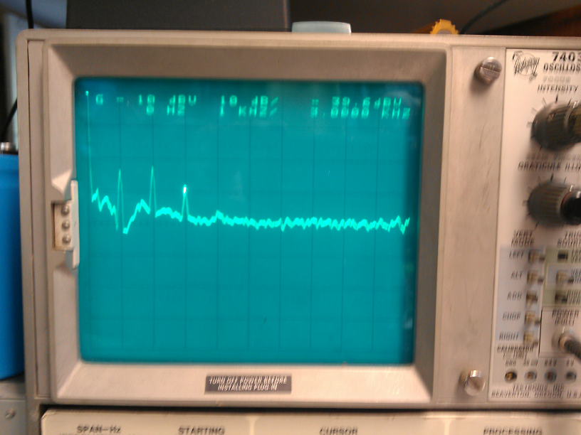

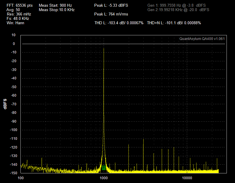

Here are three more measurements. The first a high res plot from KH4400 to QA400. The second, with a seperate ground connection from the QA400 to the chassis of the KH4400. And the third the KH4400 when connected to the QA400 measures by the 725.
1) use a separate ground connection (removes a fair portion of the junk).
2) The QA400 residuals are low but the analog limits are significantly lower.
3) not shown, the distortion increases a little (3rd increases 3 dB) when the source is 50 Ohms over 600. I don't think this is significant.
Scaling on the scope photo- top line is -100 dB. 10 dB/ vertical division, monitor out from the 725.
Next up, in a while will be inserting the interface board prototype.

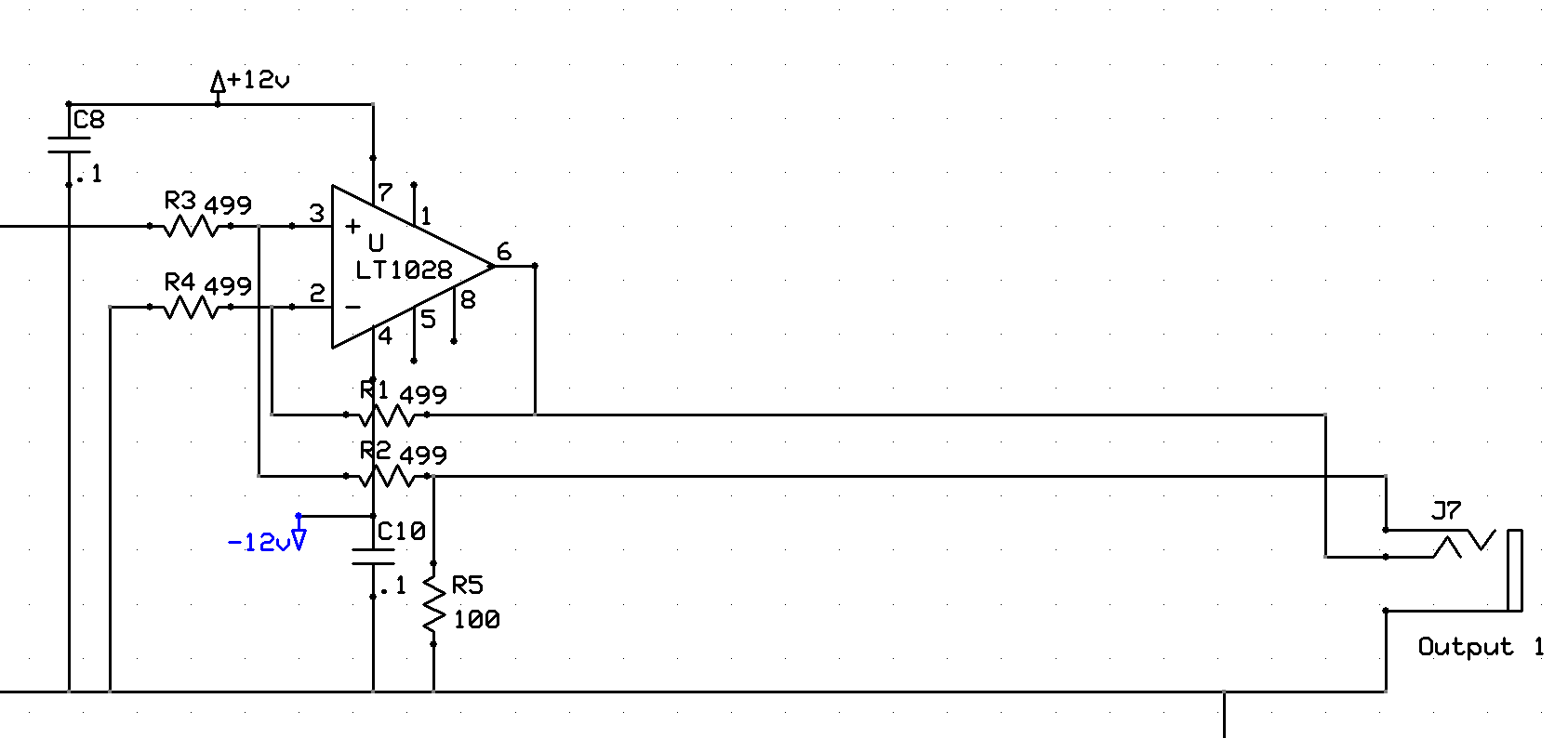

Interface board issues
I'm testing the prototype of the interface board and a key issue jumps out- operating the output at 1.5V we run into noise issues. The 25K resistors on the input of the output driver limit the noise floor. With 10V out its at the -100 dB level, however at .7V in the SNR turns into approx 80 dB. Not enough. Back to the drawing board for this. I may need to do it discretely. The other option is to put the 20 dB of gain back in and attenuate the output to get the SNR back.
Doing it with separate parts requires 3 opamps and 10 precision (.1%) resistors. Using the integrated driver really simplifies the problem. But any level below 3V will have noise limited measurements.
The sketch below shows my proposed work around. it uses 4 precision resistors and the output gain can be adjusted through the resistor ratios. It follows the load through a form of remote sensing on the return line. This way if there are ground noise issues between the chassis it should work around them.

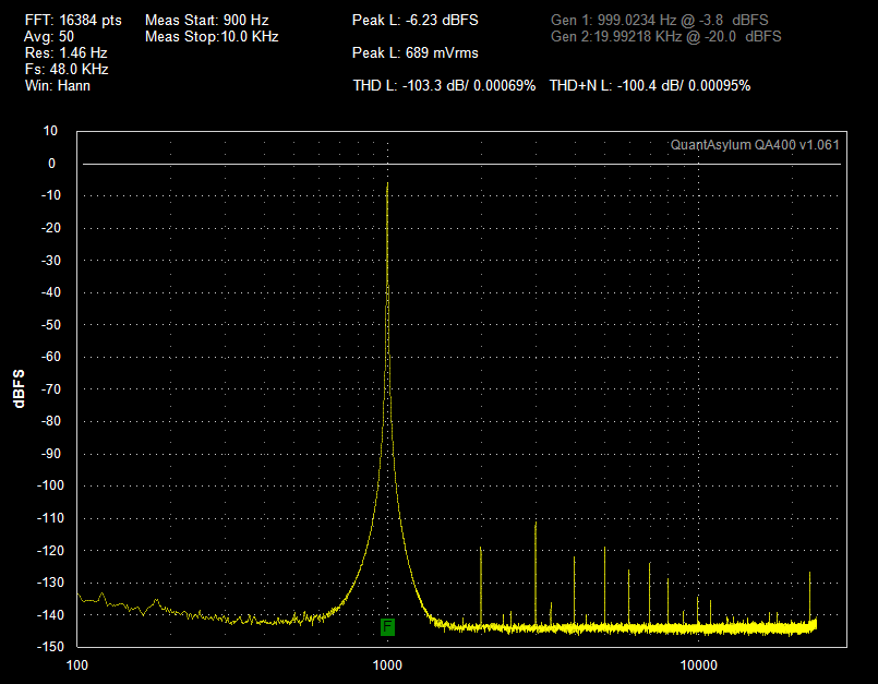

Now that I have my A-P 2722 up and running very well now... thanks to some help from my friends..... I can get Harmonic measurements with the QA400 with and without a notch filter in front of it to see how good it an be... finally.
