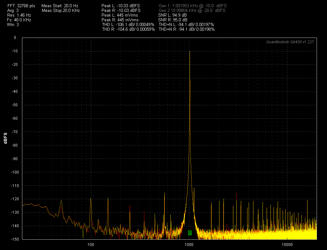

Hi quantasylum QA 400 users!
I have got this analyzer but could not find the software to get it run. Does it work with the QA 401 software too or have you an idea where I can get it.
thanks from germany

You should still be able to get it from the web site. I don't think the new software works with the older hardware. If not on their web PM me and I'll send the most recent version I have to you.

I have got the software. I asked quantasylum support and they loaded it up. I have got the manual too, but it´s not to easy to work with. For me it´s difficult to understand the level settings for example in the FR measurement modus. What is the output level?
Second problem: The QA 400 is made to work with Hi Z inputs. But they write in their manual an output impedance of 68 Ohms, which is quite low I think. Is it possible to measure low impedance studio gear with input impedance of ca. 2kOhm?

Sorry I missed this. The lowZ source and High Z input are really optimum. You can always pad the source impedance up if needed and load the input with a parallel resistor if you need to see the effects of loading on the devices output.
