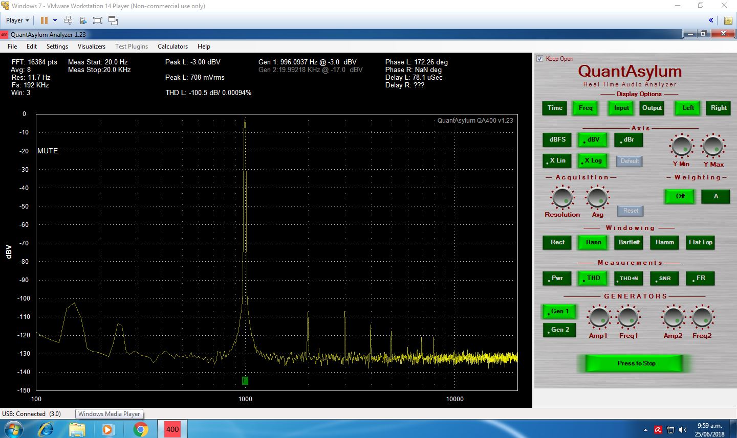

Anyone needing to support QA400 with the Windows 10 driver issue... I have today installed VMware Player (it is free) and created a Windows 7 virtual machine then installed the QA400 software into that. It it working nicely and I won't need to worry about driver issues going forward.

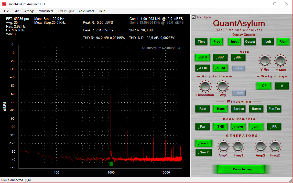

QA400 in my case... Well I can only say that in my case it is working perfectly, just as it did when functioning correctly under windows 10 with direct hardware connection. The only part that didn't work was calibration. I overcame that by copying over the cal file from windows 10.
The measurement accuracy for level is spot on and the loop back test THD and noise is just as it was under windows 10.

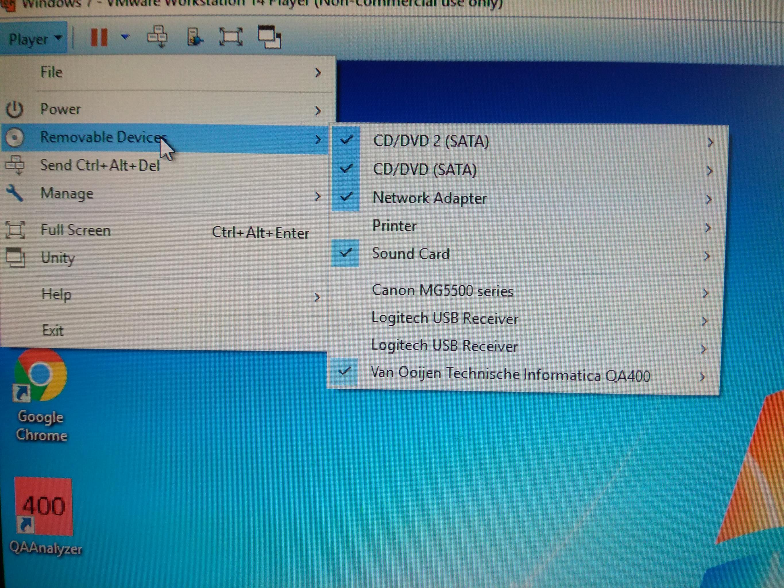

I am running in VMware Player using its USB 2.0 virtual interface, connected to a USB 3.0 hub which runs off a USB 3.0 port on my computer with 192khz option in the QA400 software.
I can also run it via a high speed USB isolator which sits between the hub and QA400.

I can only speak for my setup with latest VMWare Player and Windows 7 Ultimate. Running on an Intel based Windows 10 host with latest Win 10 updates.
Host machine is 64-bit Win 10, VMWare Player is 64-bit version, guest Win 7 is 32-bit install, with all updates available through Windows Update installed.
