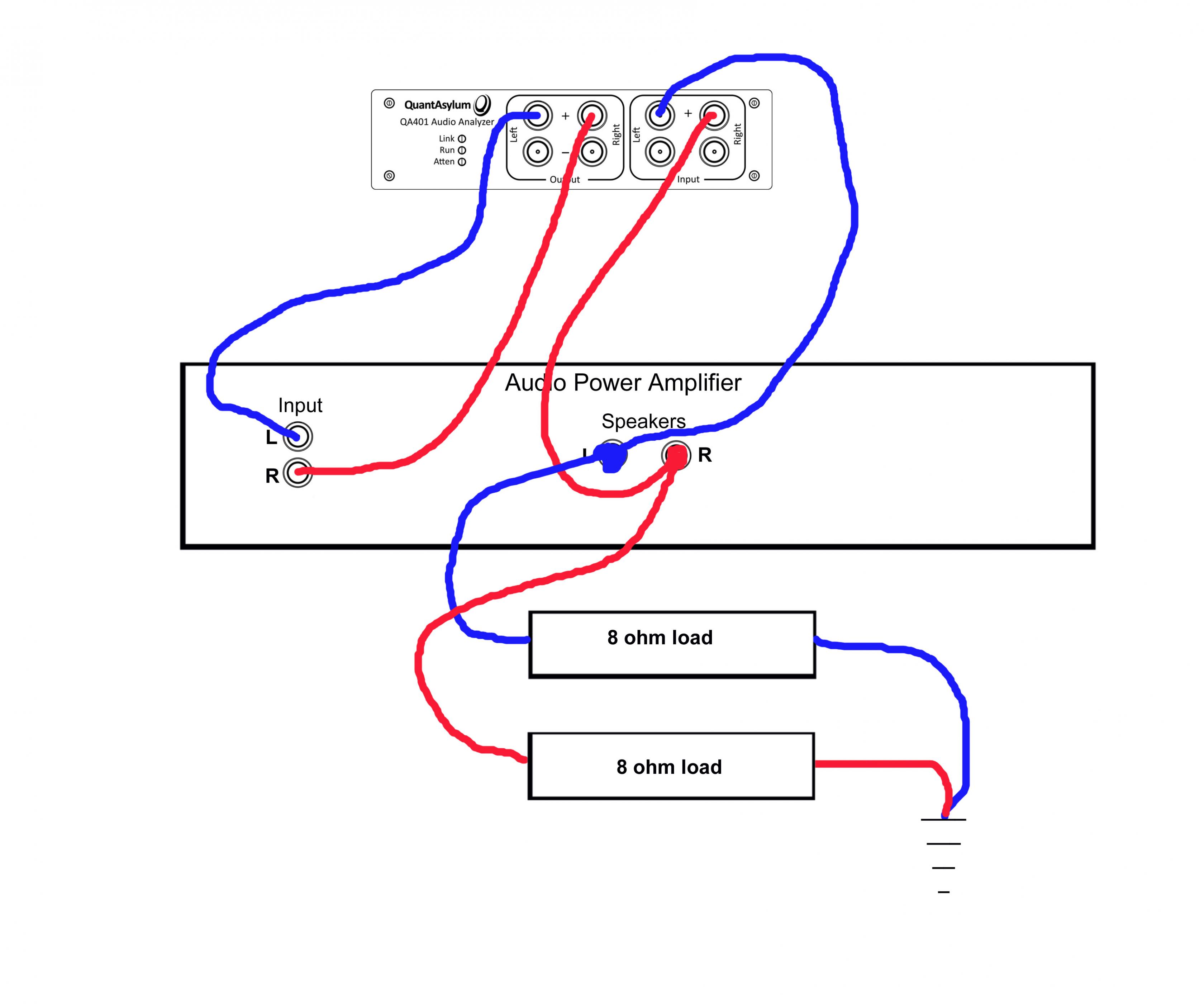

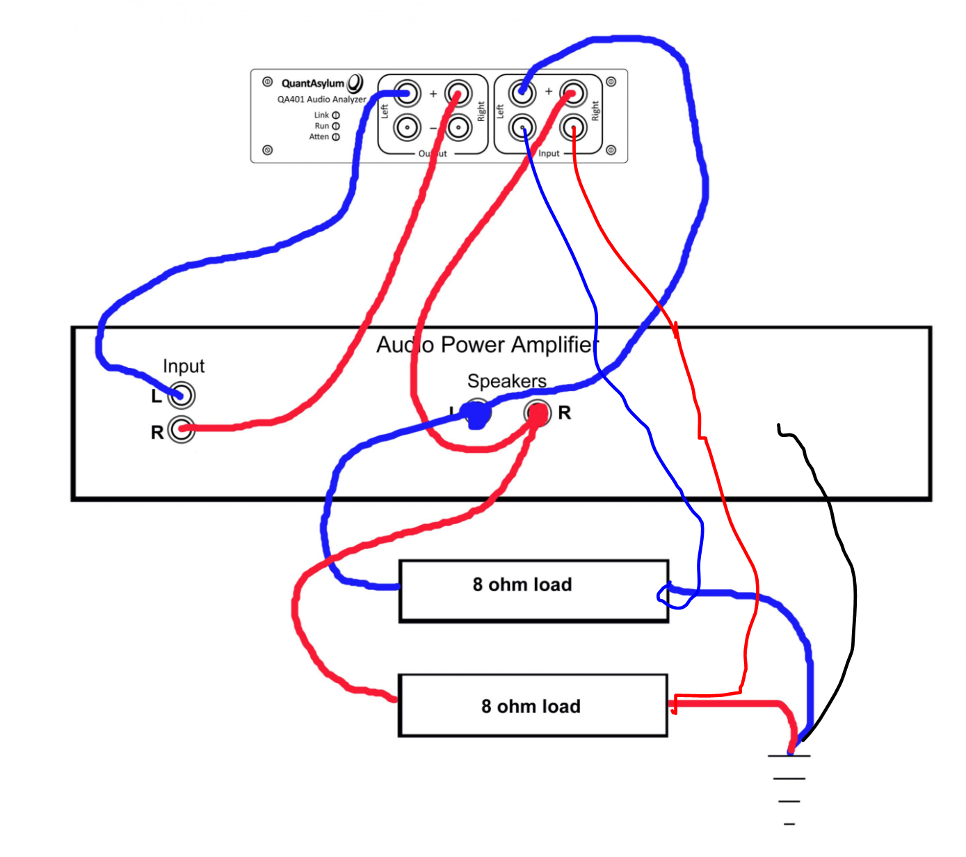

Small revisions in drawing.
1) Use differential connections for the output of the amp
How so? Redraw diagram. Confusion grows...
You can place 8 x 1 ohm and only take the potential from 1 ohm to get lower distortion results.
Yeah, and lower signal results. The QA401 already has the necessary pad built in and will handle 30VRMS as Demian mentioned.
The ground scheme on the modified drawing might be a little confusing, but it's correct. There's no ground connection to remove, per se.

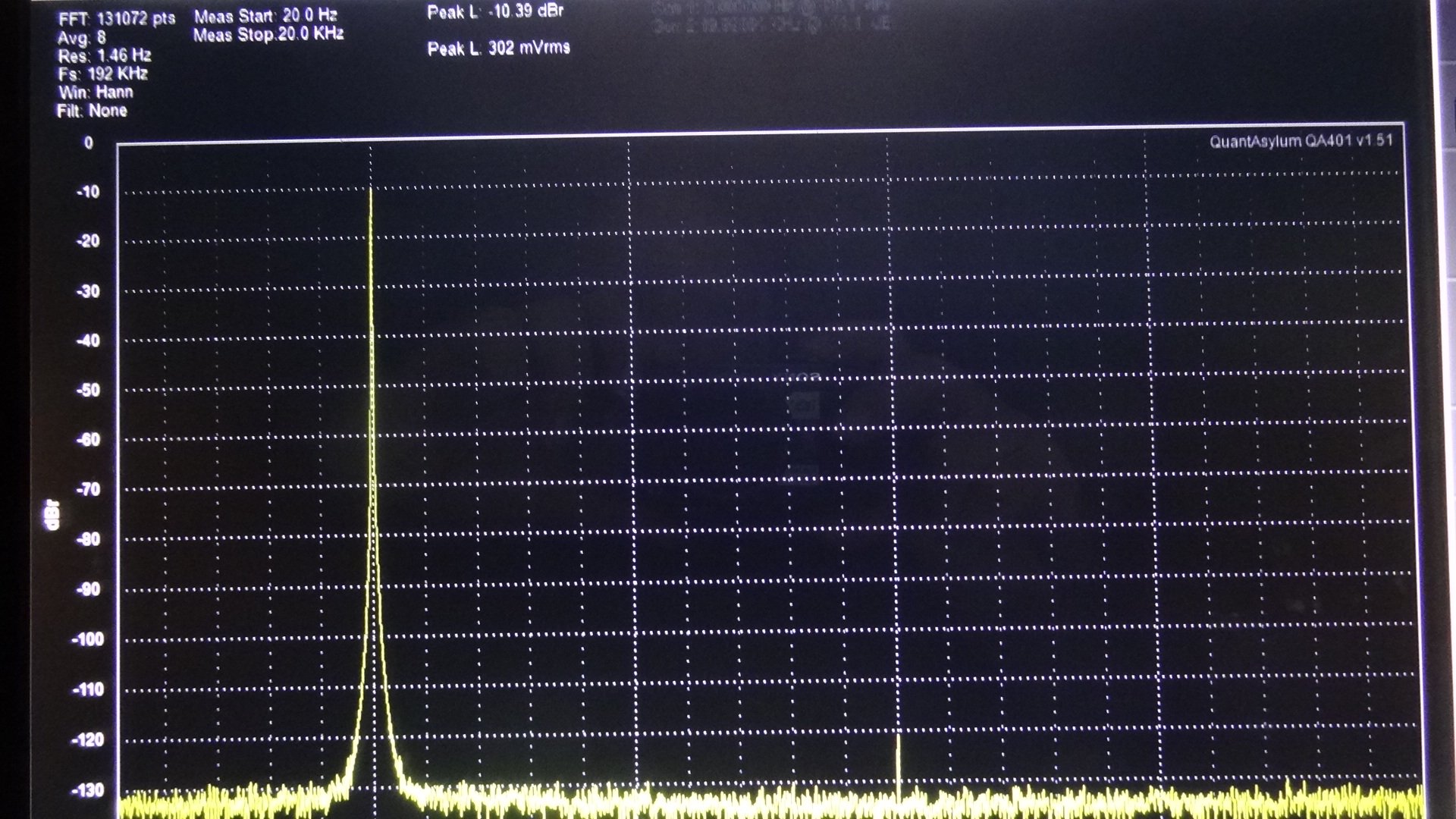

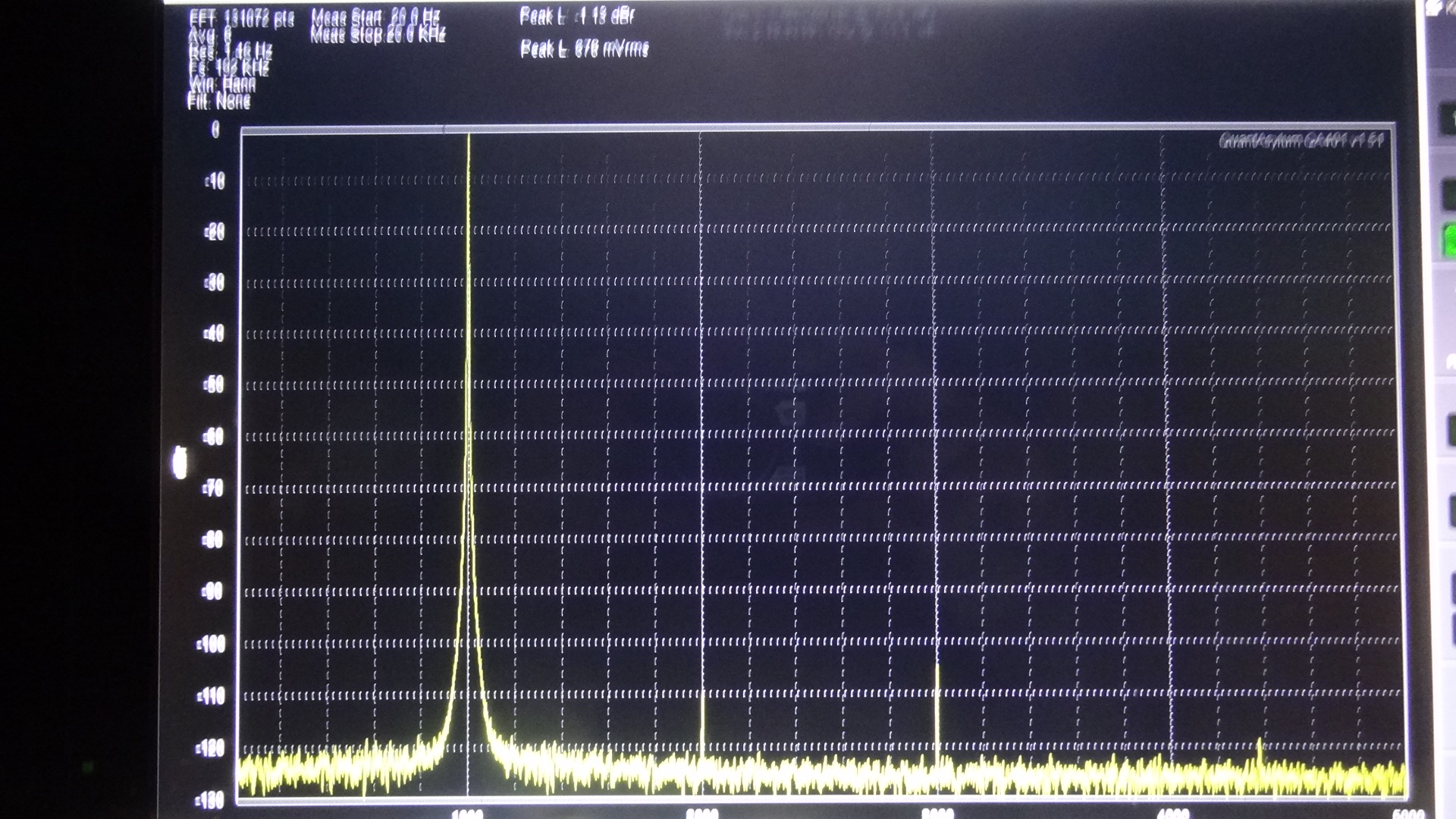

Like most ADC - when you get to -100dbv and below, the accuracy starts to fall apart -
Same with QA400/401
Without pad, at 0dbv, the 2H starts to show from the FFT analyzer.
and with -10 input --
Whereas, the 2H and 3H are actually about the same with more accurate analyzers;
The AP 2722 and ShibaSoku 725D both show the 2H and 3H at almost same level with this generator source.
Anything below about -105 should be ignored as an absolute with QA . However it is still much better ( approx. 20db) than some popular sound cards at same level.
THx-RNMarsh
