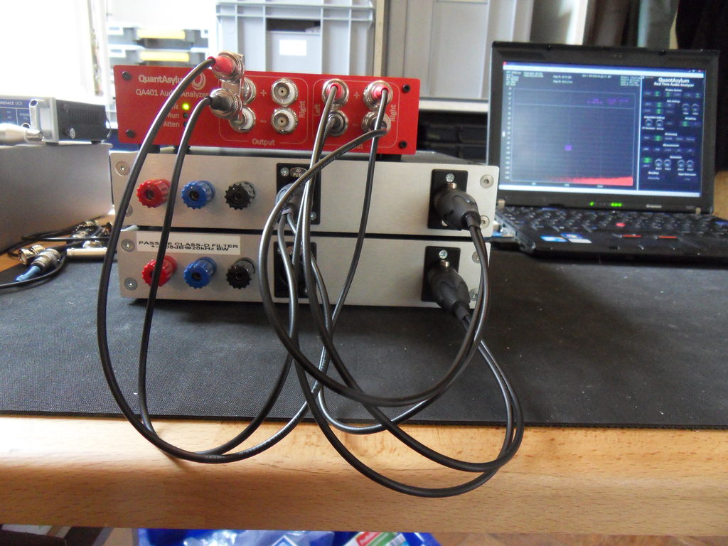

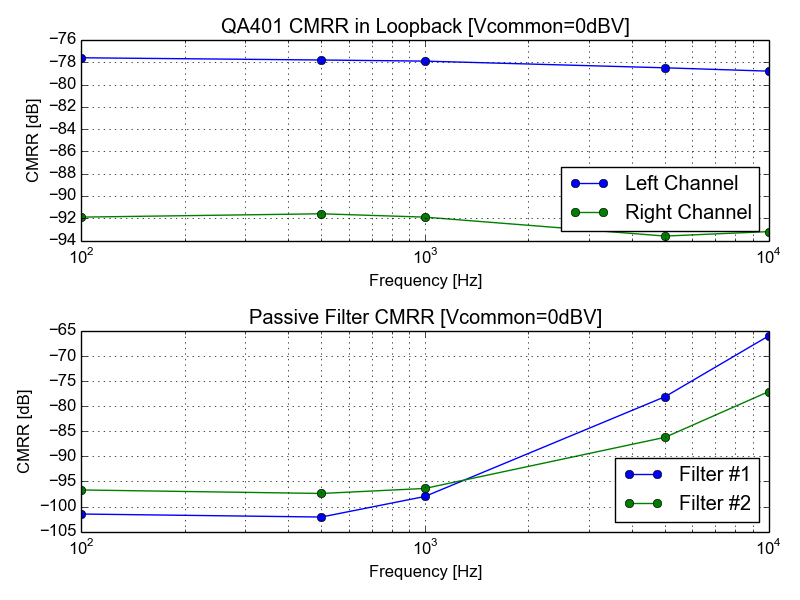

Finalizing my passive lowpass input filters I had a second look at CMRR of the QA401.
Test setup:
attachment.php
Results: (Only the left channel is sweepable in the QA application, so I had to tune in each value manually.)
attachment.php
Obviously the right channel of my QA401 has a much better Common Mode Rejection. I will have to send some more time on the trimming of the filters.

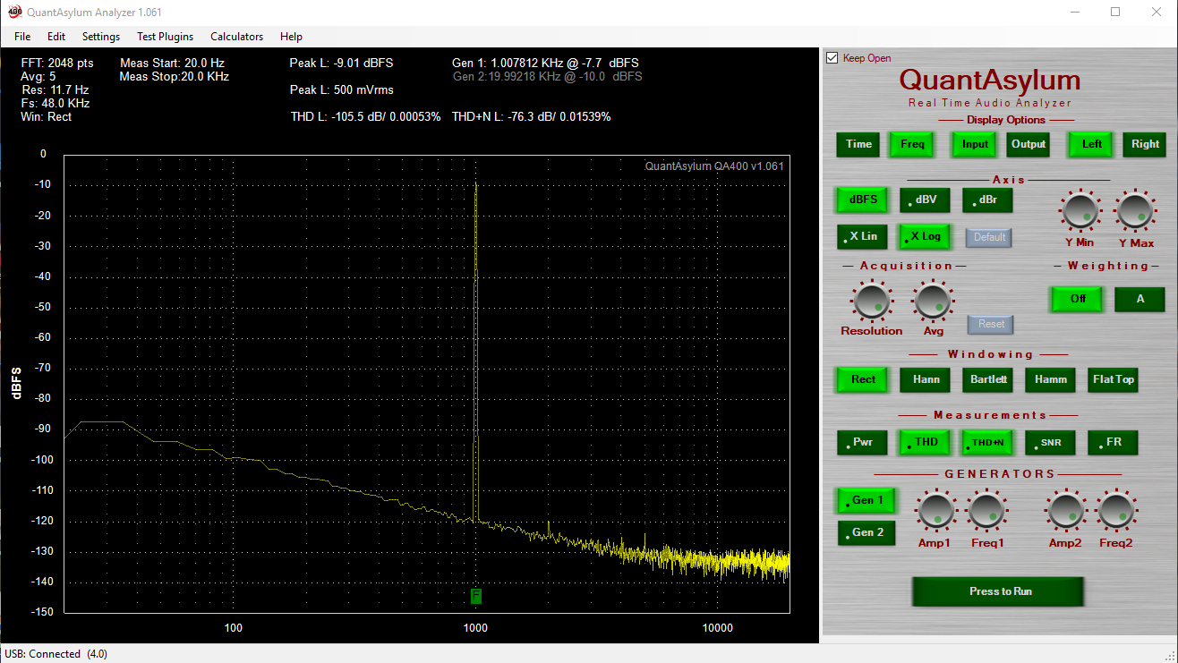

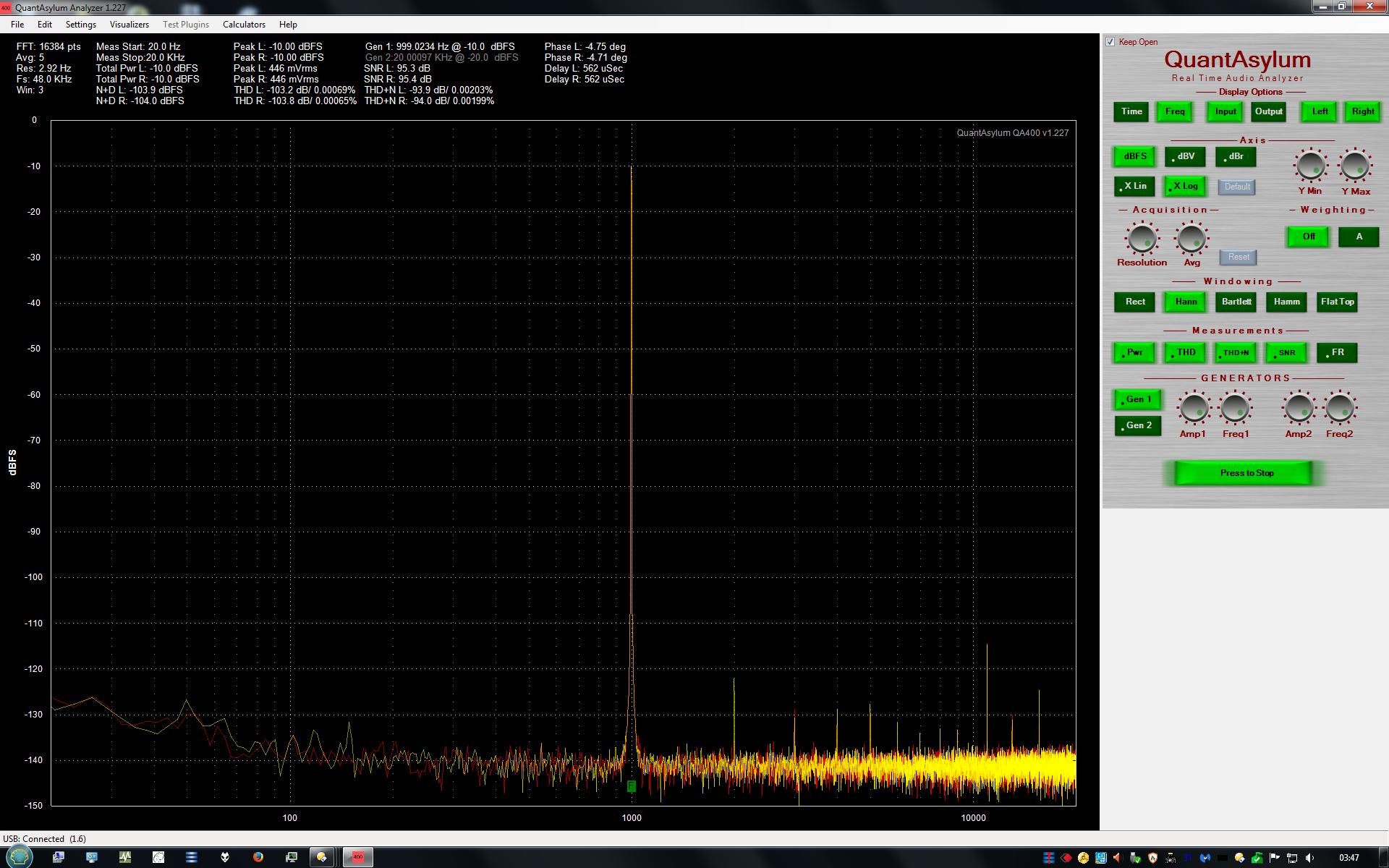

I need to take some accurate measurements of the output of a power amplifier I built. I used a differential to single ended interface using an op amp (TL082), in front of the input of my Q400 distortion analyzer.
So I put in a loop to see what the distortion was at the output of opamp at 6V. I used a voltage divider at the output and the op amp circuit has a gain of 12 V/V. My issue is that the typical THD for the TL082 is 0.003% at 6V out, from it's spec sheet, yet I get much lower distortion. I calibrated the Q400 per instructions some time ago. Just wondering if I can trust these distortion measurements? Anyone know if the TL082 can measure this low? Or does it indicate a problem with the Q400? Maybe needs to be recalibrated?
The measurements look valid and are what you can get from a QA401. The TL072 is much better than its spec sheet. The specs were written in the late 1970's originally I think. .003% was SOTA and really at the limits of contemporary test systems then. Once specified you don't change specs or you may have problems with customers who need exact equivalents.
John, you could alter your TL082/TL072 distortion test circuit, so that it has continuously variable amounts of distortion. For example, you could modify the voltage divider on the opamp output.
You could connect (a 1 Megohm potentiometer, in series with an 1N4148 diode) in parallel with the top resistor in the voltage divider. When R=1Meg, distortion is minimal. When R=zero, distortion is huge.
Try it and see whether this gives you confidence in the QA401, or whether it confirms your suspicions that something is very wrong.
Thanks Mark, I think it is okay. I've taken distortion measurements of a number of circuits with it and the Q400 shows the distortion spectrum well, at different voltage levels too. Just thought there might possibly be a calibration issue, but given 1Audio's comments it is most likely fine.
