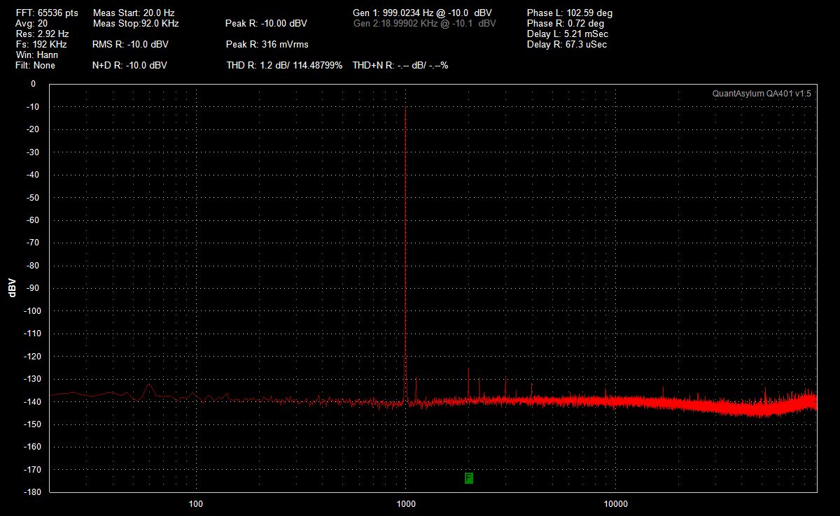

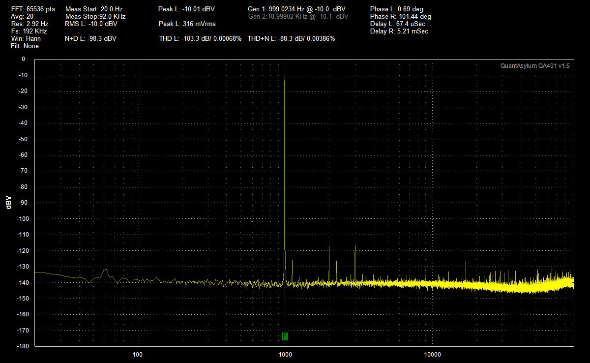

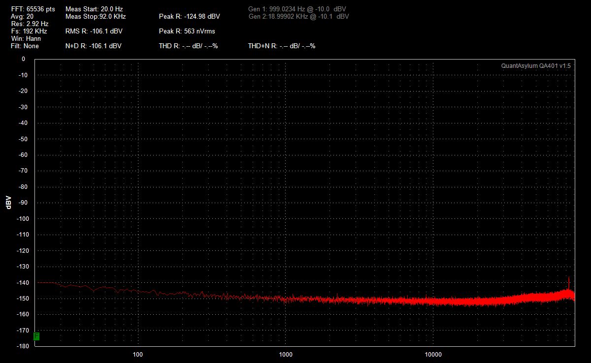

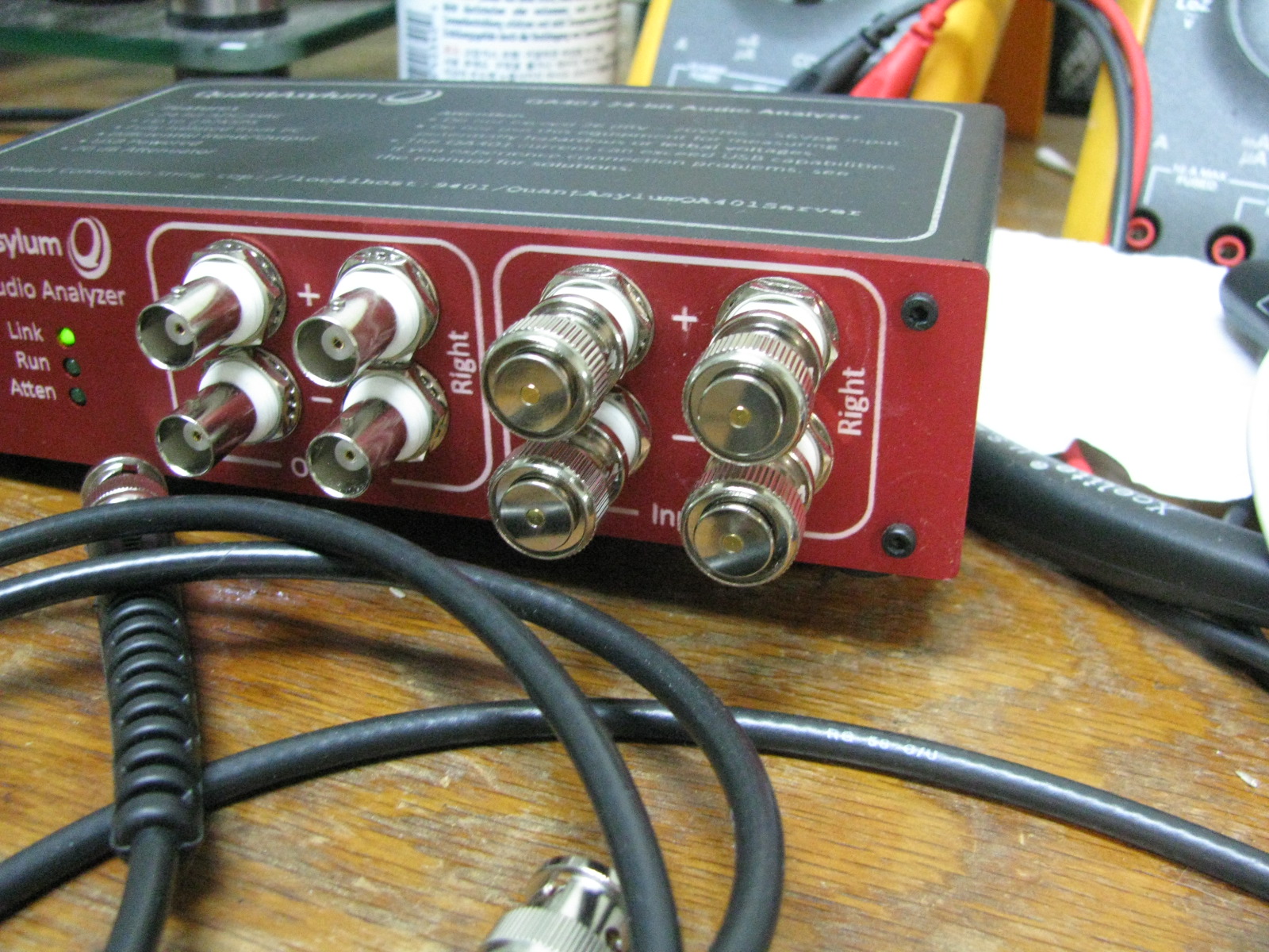

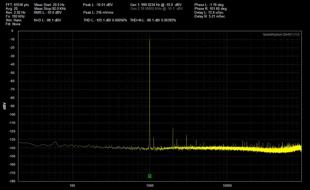

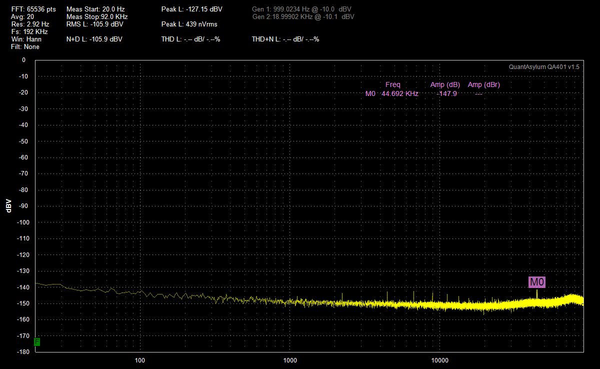

I was doing some testing with the QA401 tonight and ran into a couple of things.
In the first photo below I had forgotten to put a BNC shorting cap back on the inverting input of the left channel. I had it set up to do singled-ended tests using that channel. Look at all the junk that shows up! Then in the second photo the BNC short is replaced and all is well. So there is a mistake to watch out for. 🙂
The next set of photos and tests is pretty interesting. This is now with all 4 QA401 inputs shorted. The only difference is that the first plot, which shows the 1KHz line, has the QA401 internal generator on at a level of -10dBV @ 1KHz (also in the text at the top of the plot). The second plot has the generator turned off. So there is that much internal leakage from the generator to the analysis side, even with all of the QA401 inputs shorted. Looks a lot like that USB conducted noise mix-down tone in the QA blog post above, except the noise floor doesn't seem to change here.
Click on the arrows in the lower left corner of these to enlarge them.

It looks like you only have 125 db of isolation at 1 KHz. How utterly useless. (Just try to get that in normal practice with almost any audio device).
Its really good given that they share both power and ground. I would have liked the output and the input to be isolated from each other but that may be some future version. This was with the new software?
Lol! 🙂 True, the surprise here is probably that the bleed-through isn't a lot greater, given just a $450 device. I am using that latest V1.50 software.

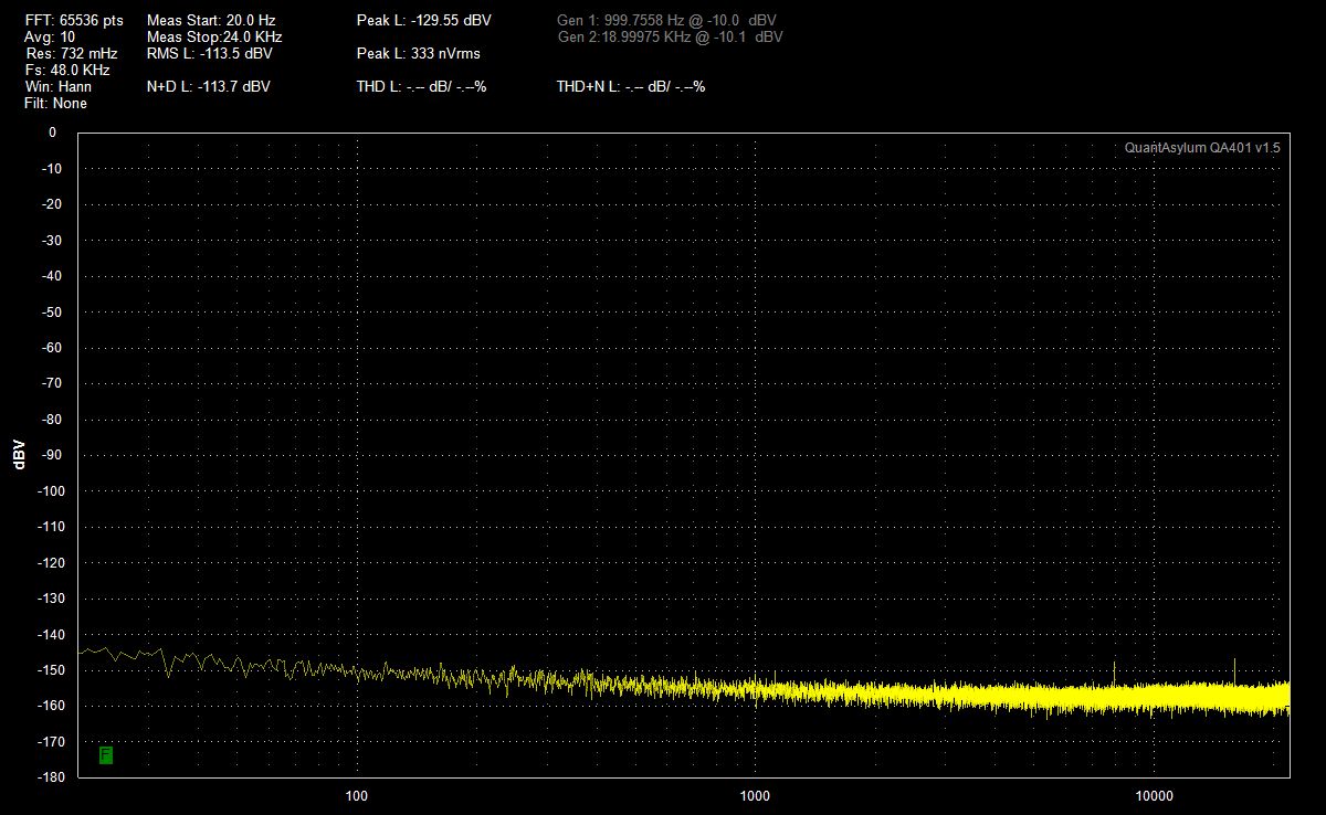

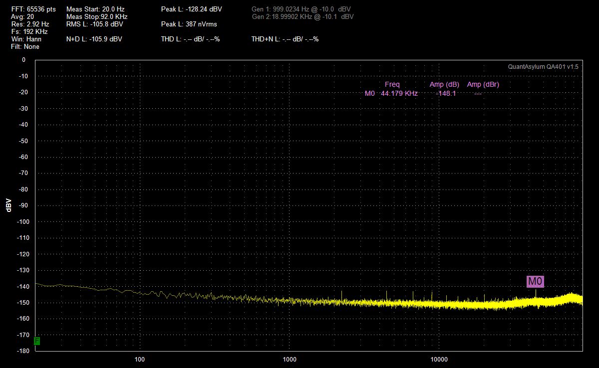

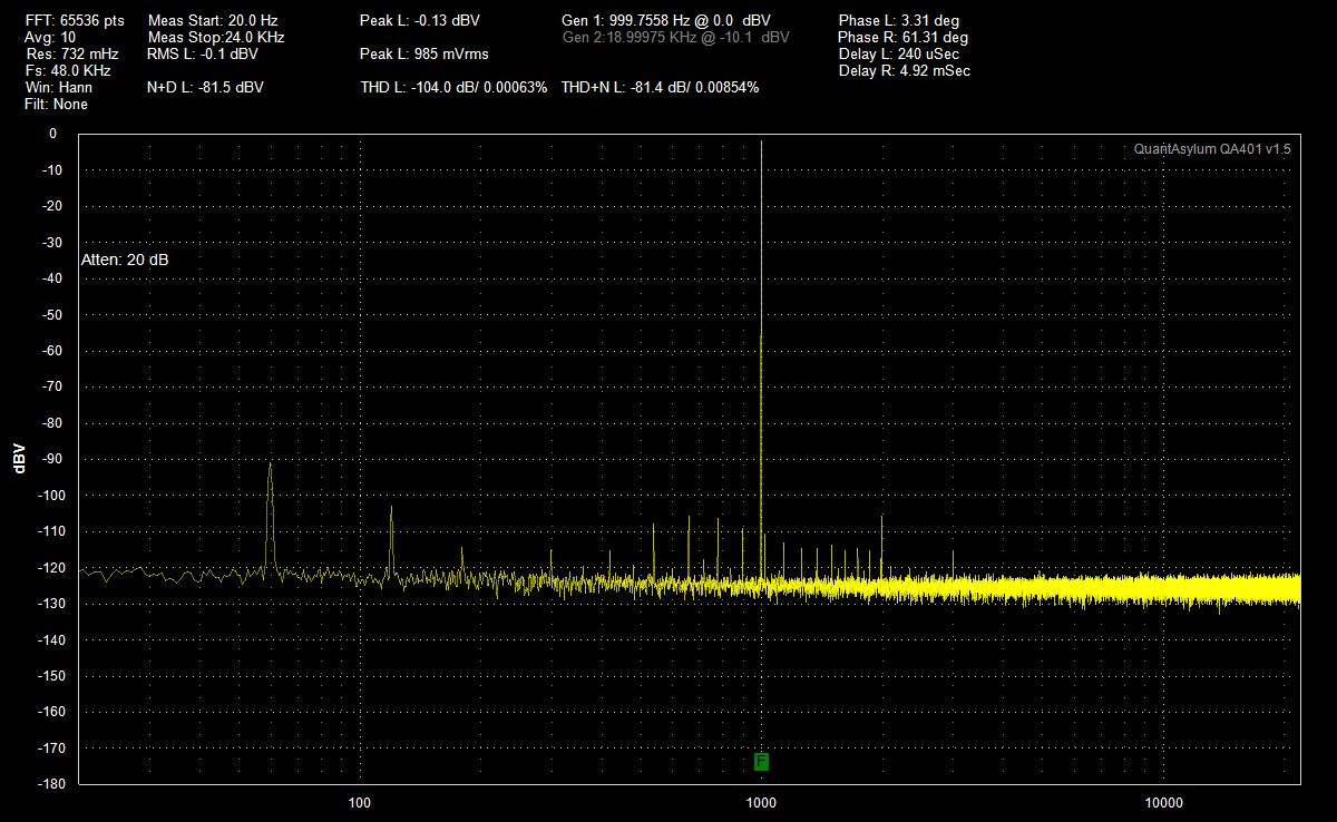

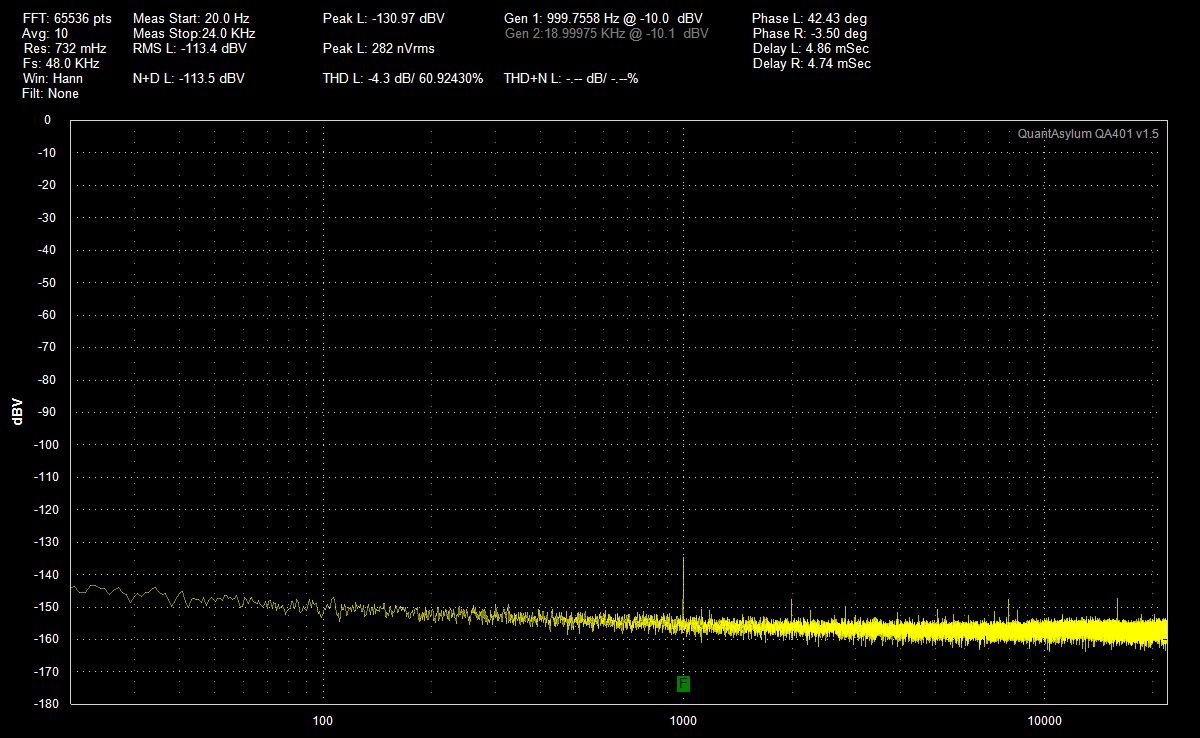

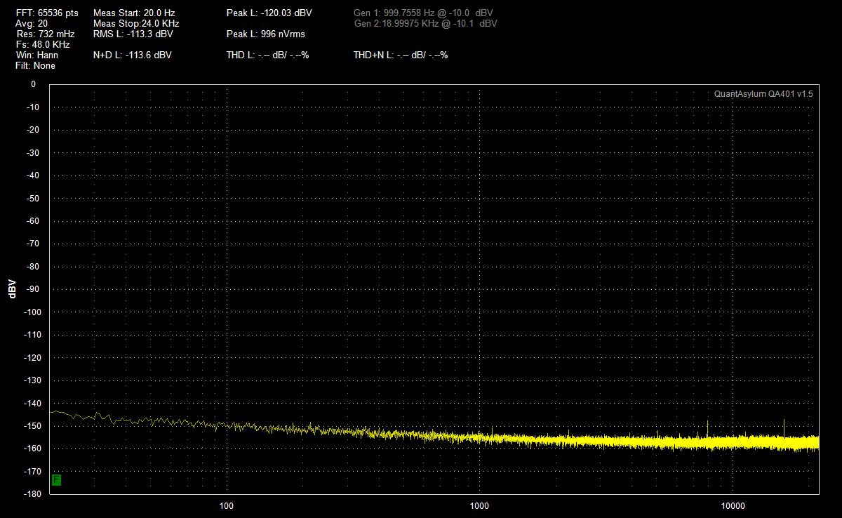

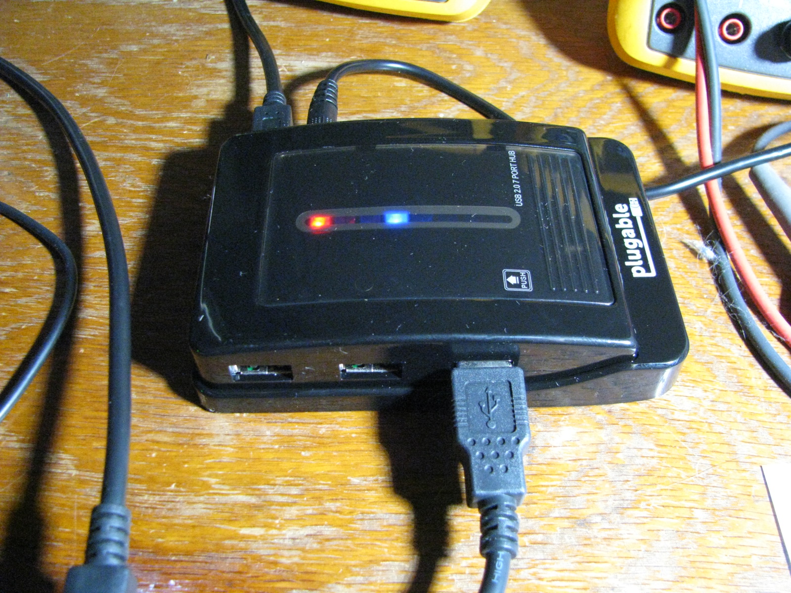

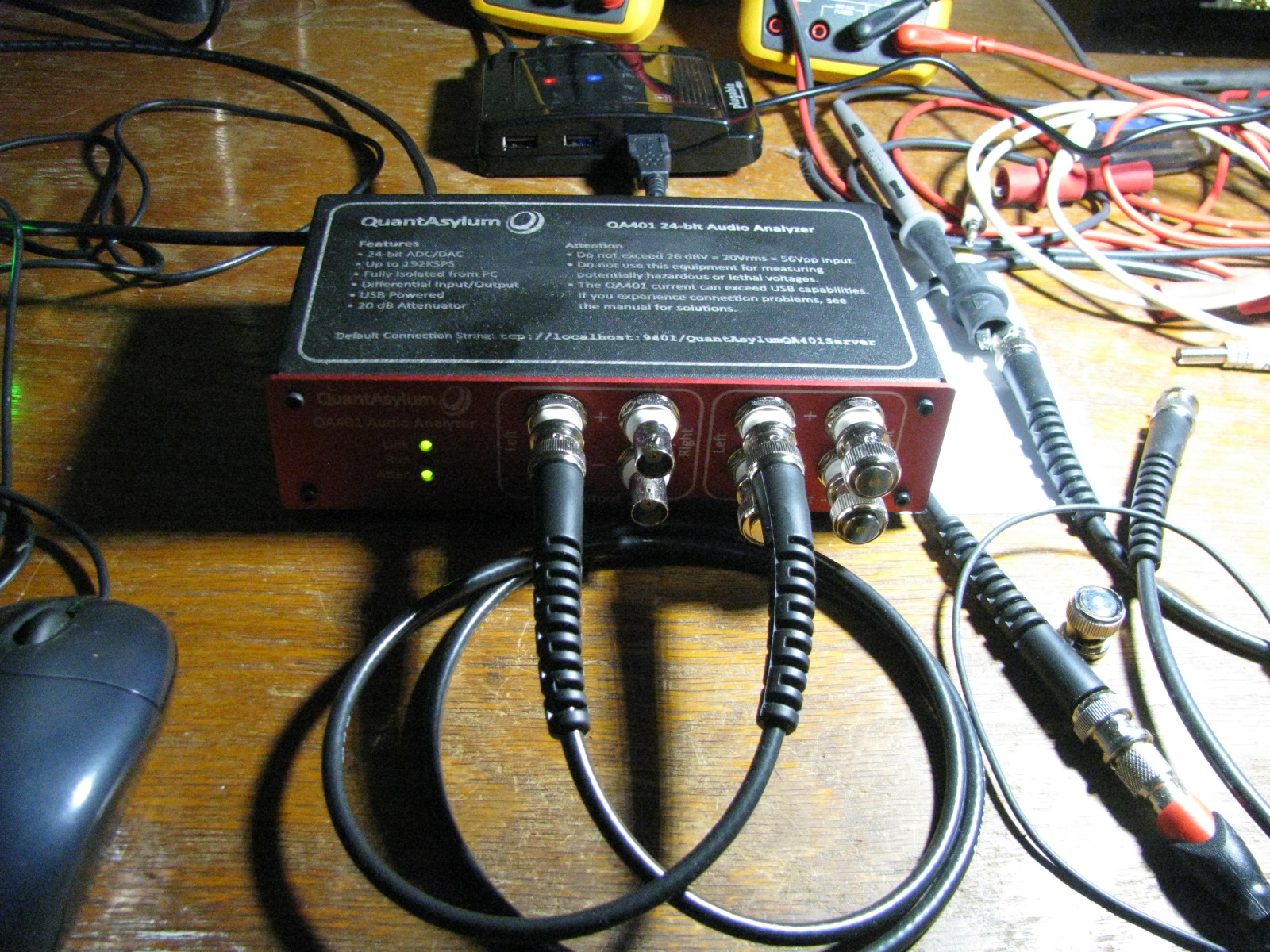

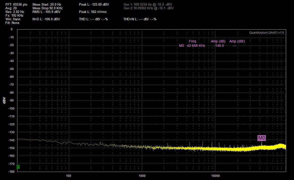

So here are some tests with the powered USB hub in the link in the previous post #2345. Another small addition to the body of knowledge about the QA401. 🙂
Well the good news is that the powered USB hub didn't make the measurements any worse by any significant amount. It would be a viable hub to try if someone is having USB noise bleed-through problems with their PC, as per that recent QA blog post above.
The "bad" news is zero improvement of any kind. In fact the 48Ksps plot directly fed by the laptop USB port might be just a tiny bit lower noise floor on the upper end. But then again, I wasn't getting any noticeable noise problems from my USB port to start with.

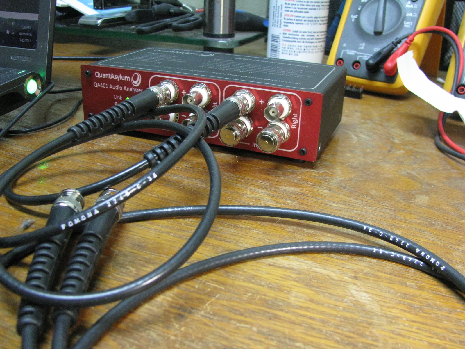

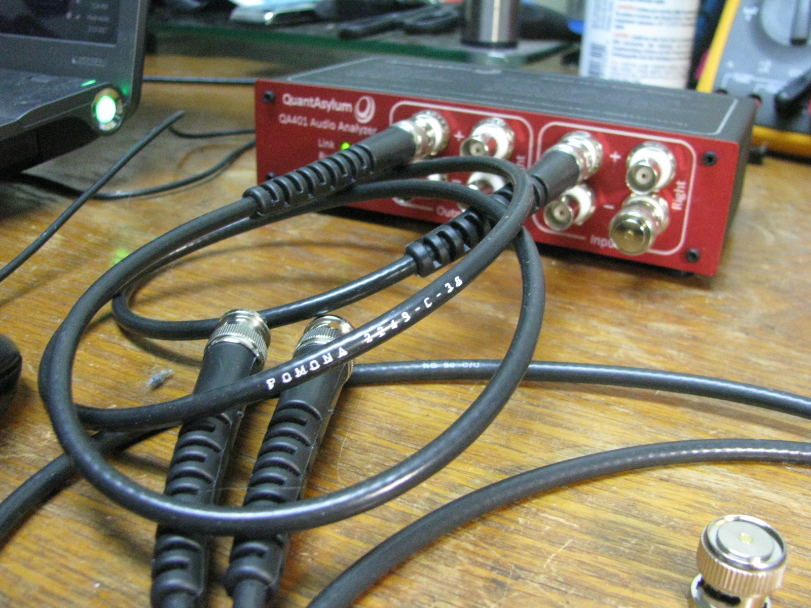

Photos:
* First two are the test setup, with the powered USB hub behind the QA401. The hub comes with a 5Vdc plug-in wall adapter and the USB cable that connects to the PC. I have BNC shorting caps on all 4 QA401 inputs for all these tests.
* The first plot is with the QA401 plugged directly into the laptop USB port, powered by that port. 48Ksps with averaging set to 20. All the parameters are listed in the top left of the plot.
* Next is the same thing but now with the USB hub connected to the laptop and the QA401 plugged into the hub. The QA401 drivers were found just fine (the intial Windows auto-install) when the QA401 was plugged into the hub for the first time.
Comparing these two 48Ksps plots I just see nearly zero difference, better or worse. If I stare at them long enough it looks like the noise floor of the upper frequency half might be just a hair lower with the direct connection to the PC.

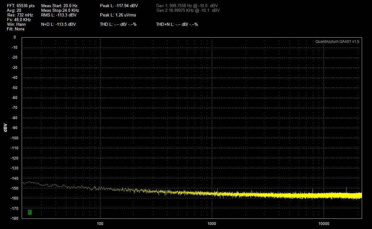

* Next is back to the QA401 plugged directly into the PC USB port. Now with the QA401 set to 192Ksps and the x axis and THD range set for 92KHz.
* Next is the same as above but with the QA401 now going through the powered USB hub
Comparing these two 192Ksps plots I just don't see any difference at all, not even a tiny one. I don't know where that small 44 KHz peak is coming from, but taking error bounds into account it is exactly the same level in either case.

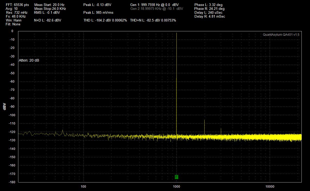

* The last 3 are loopback tests with the QA401 generator now turned on and set to -10dBV. The first is directly connected to the laptop USB port while the second is going through the powered USB hub. The 3rd harmonic seems to have decreased, but it isn't clear to me right at the moment that could be related to the USB hub (?). I'll have to ponder that a bit. Most likely I didn't wait long enough for the averaging to settle.
Clicking on the arrows in the lower left corner will enlarge these and hovering over them with the mouse will bring up the title.

Powered USB hub loopback again, right channel
I had forgotten in those last 2 posts in #2346 above that the left channel in these QA401s is "harmonically challenged" when running at 192Ksps, as per QA and earlier posts in the thread. I don't use the higher sampling rate that much.
So here is a repeat of the loopback test using the right channel of the QA401. The first photo is with the QA401 laptop-powered, the second photo going through the USB hub. No significant difference at all that I can see.
Don't believe the THD, THD+N numbers at the top of the graphs, they were bouncing around all over the place. Couldn't lock onto the small levels of harmonics, I guess.
