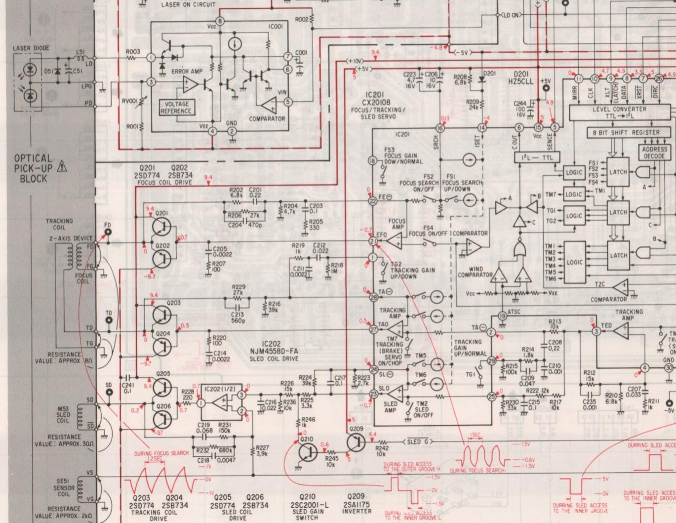

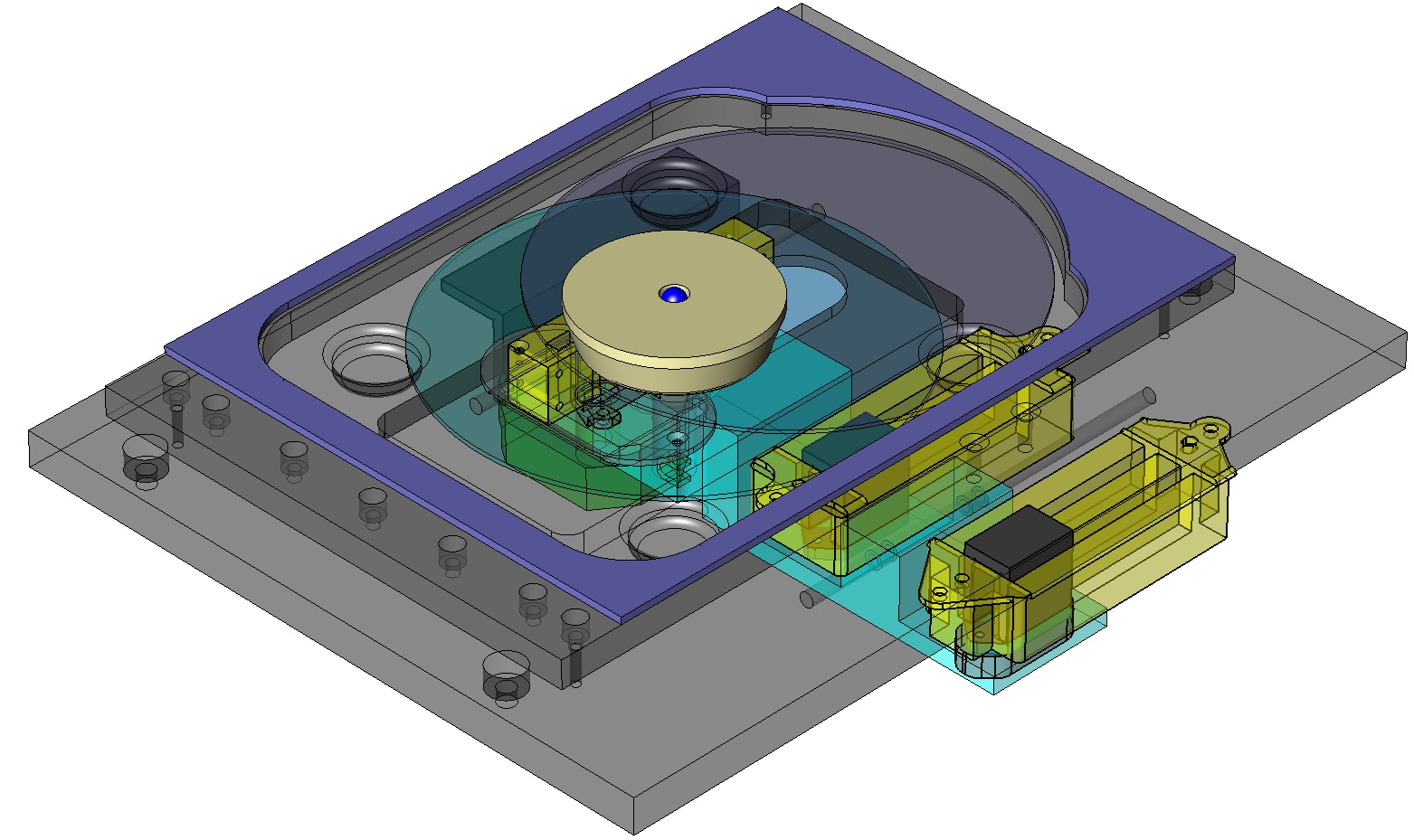

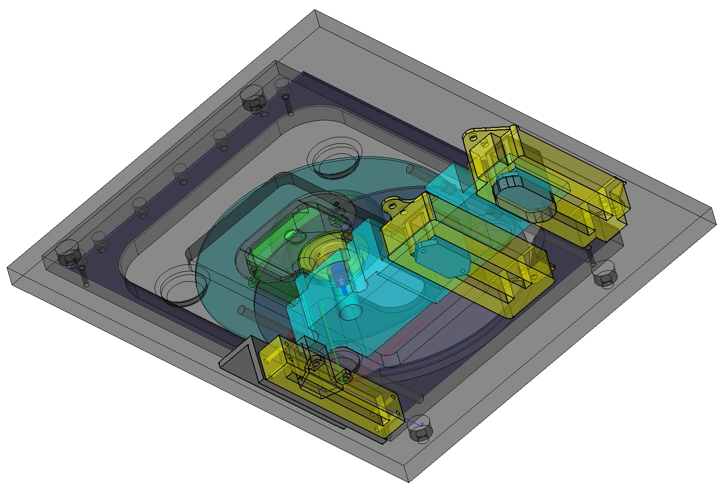

Here we go ... first draft.
Besides the clamper / stabilizer. all parts are drawn transparent,
this might be annoying, sorry for that.
But one might get an idea.
The CD is moving, the laser is fixed.
The drive is based on the BU-1 mechanism. and could be built from them as a start.
I have two of BU-1, in a CDP-103 and CDP-502.
It was fun to have them disassembled and reassemble them
(not very much parts) and see them work flawlessy.
Why the heck did Sony give up on that? You´ll probaby remove
10 screws and the mech is dissassembled. No flimsy breakable washers to remove from gears
to get access. Rugged and simple.
Good for diy: Only the rails fo the laser have to be accurate.
The diver/sensor coils and the magnets allow a little play.
But coils and magnets are weak, as mentioned by others before.
As a test, I switched the player on, while frontplate was facing upwards.
Thus being placed vertically, the laser does not move at all.
I assume the laser weights something between 80 to 100 grams.
Horizontally, the laser moves normal of course.
But with a fixed pickup and moving CD, the mass to be moved by
the magnets will be probably three times as high:
Brushless disc motor, the CD and stabilizer.
This will weight around 250 to 300 grams.
Therefor, I put in two moving coils.
I assume, a second sensor coil is not needed.
Even though the mechanical parts of the two players are the same
(Mechanism-chassis are not, metal for the CDP-103, plastic for the CDP-502),

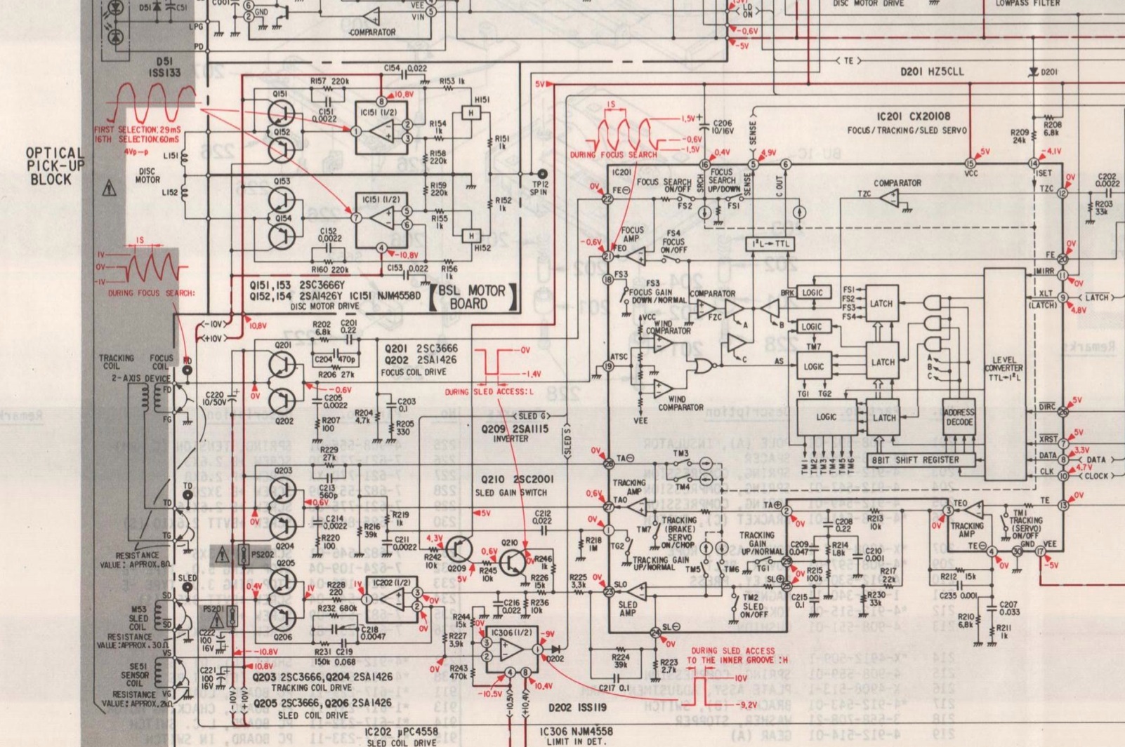

the servo circuitry seems to differ a bit. I would need to add two trannies to
move the second coil, any advice on this? Schematics attached.
The drawing is not finished yet, rails have to be placed, and the spindle Motor is not detailed yet.

Hi Salar,
Just repeat the op amp forward using the same feedback coil connection as for the other one. That should work without loading the original signals.
What do you mean by disc stabilizer? It is a magnetic type, isn't it? If so, the CD can use the pie plate and normal clamper as one wishes. You might be forced to use the normal magnetic clamp used by most.

Again, could someone please make a quick
drawin how two driving coils instead of one
are connected?
The mech of a BU-1 is simple. Can be rebuilt
from scratch. It is just magnets and coils.
Circuity can also be rebuild, I assume?
are connected?
Hi Salar,
Ring magnets are the most simple and effective ways to clamp a CD. Almost every junk CD player has one of these just waiting to be plucked for use.
Duplicate the circuitry and connections from IC202, pins 2 and 3 on forward. Connect the same as IC202. You only need a single op amp.
