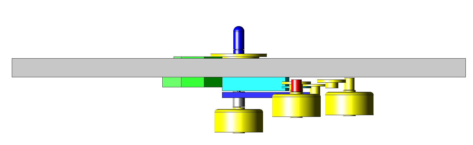

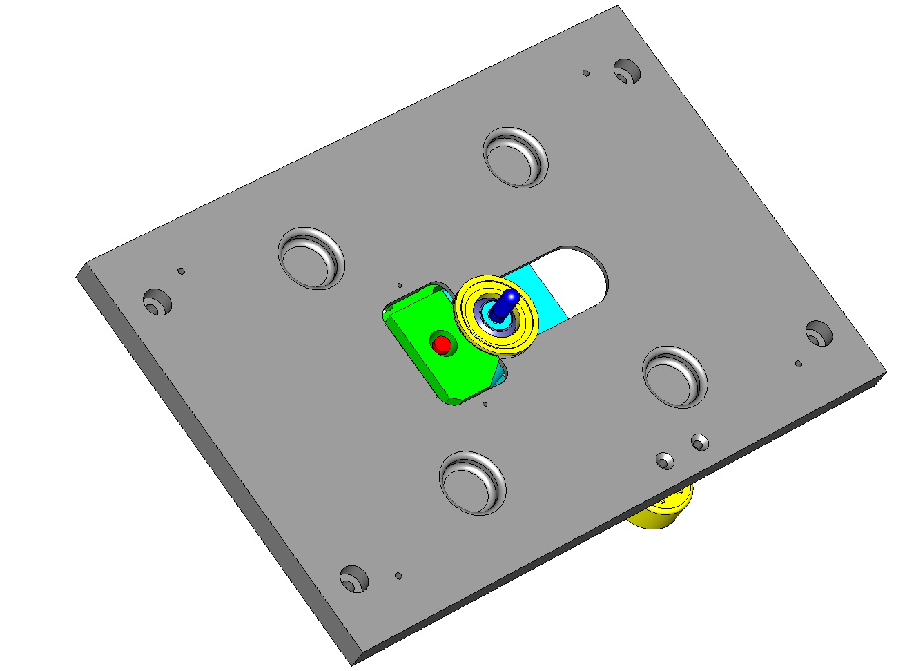

Concerning Mark's sketches of a sled:
I think they basically look good. I'd prefer the use of linear motors for track access, but for a sled that incorporates a motor and stationary optics, it looks quite good. This is what I consider to be a positive contribution to this thread. Thanks Mark.

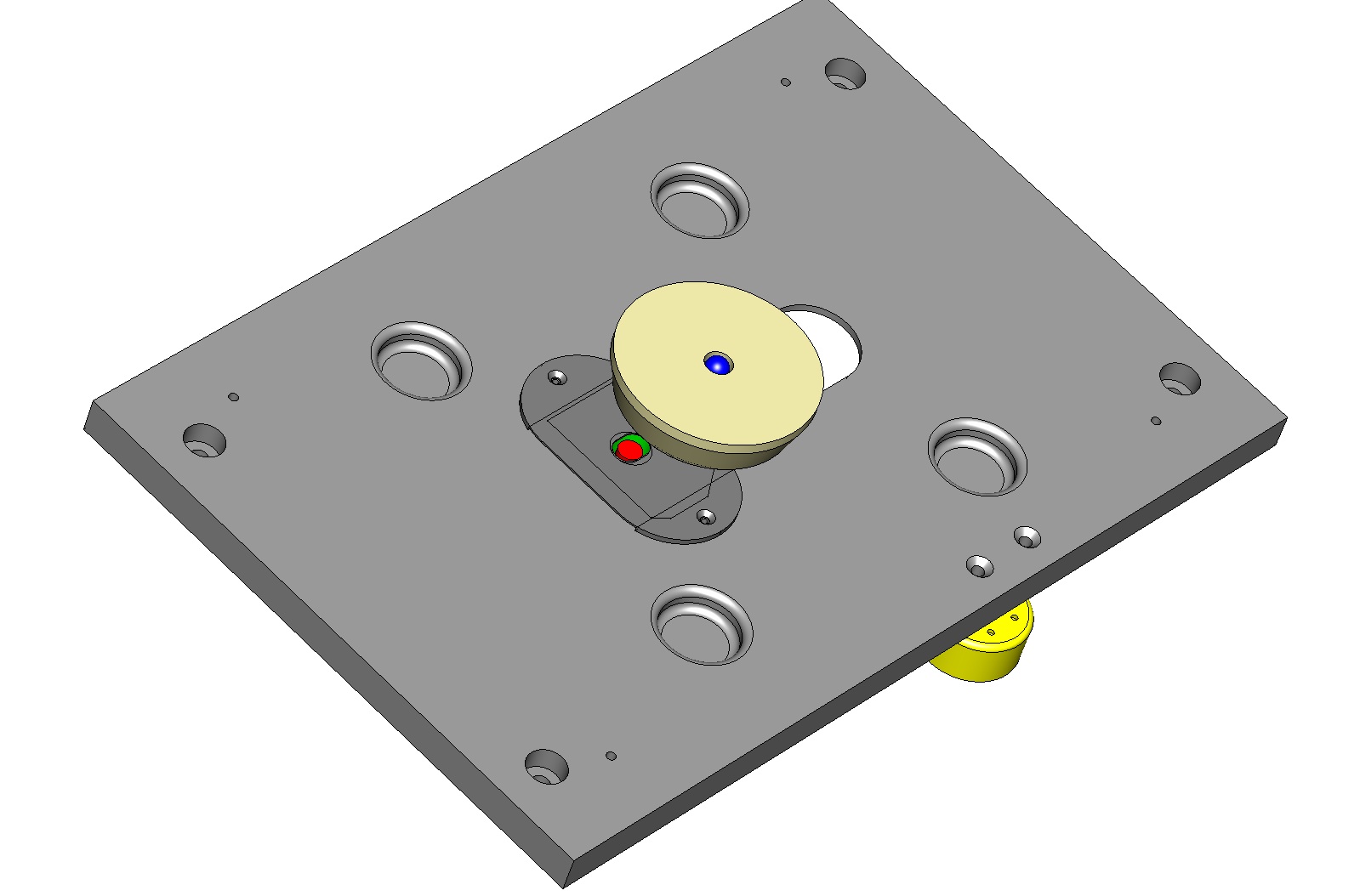

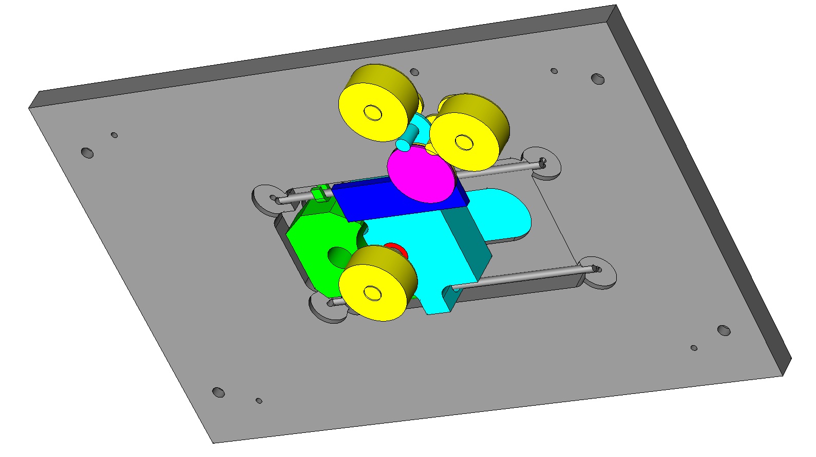

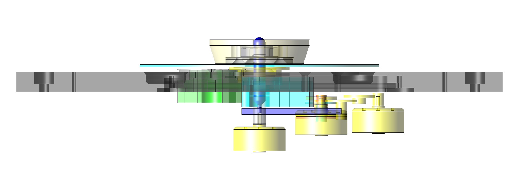

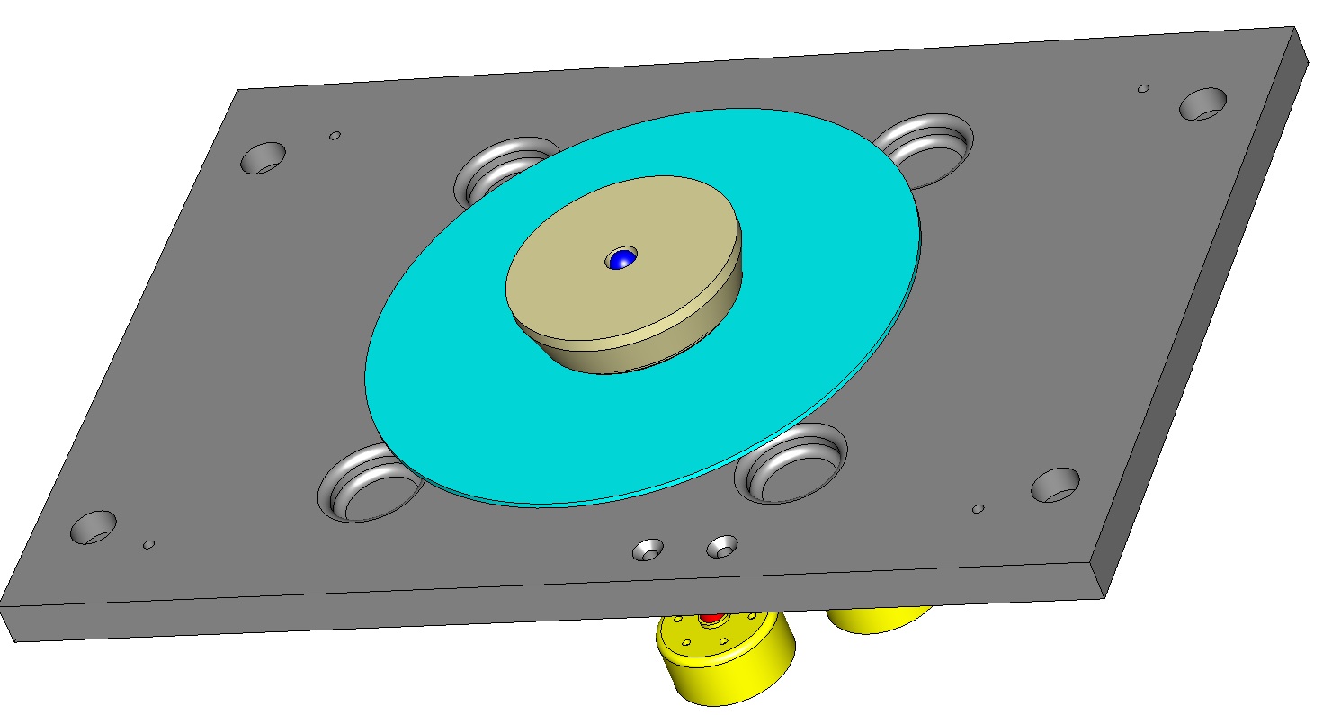

The drawing shows nothing new besides the design
needs we already know: Disc motor "upfront"
to fit contemporary lasers, three point bearing.
My design will basically not look different, so I can't
wait to read "i was the one who brought up the design"
in post 852 🙂

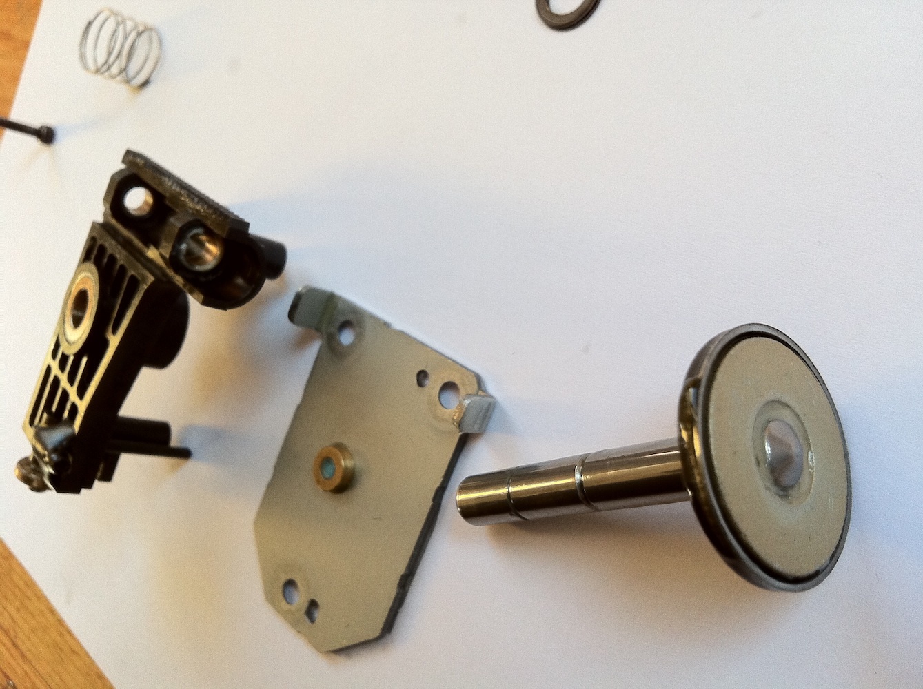

I am sorry that I gave you the impression that I am in any way preventing this from being build. I haven't stopped anyone from proposing/posting designs. I am just trying to supply some information. What have I said that is incorrect? Or, do you only want people here that agree with you all the time?
How could I have posted it earlier? you only recently posted these goals. And, I did not post it as a "solution", more like a very small first step.
Then there is time to show you that modyfiying an existing design leads to nothing:
This I made based on a Sanyo DV-34 mechanism. CD is moved. Only the fixtures for the motors and the spring-based cone for centering the CD are missing in this drawing.
A 0,2mm steel plate needs to cover the laser, because Sanyo even did
not care to mold a cap protect the laser from dust. And where is Sanyo now?
Bought by Panasonic and no sign that this mech is still being produced.
This, I mentioned in the very beginning, We can´t rely on the companies.
Stated this in the beginning, 80% of the answers ignored this fact
We could have built great mechs from ROM drives around 2000. The first gen.Pioneer/Apple DVD drive I own still runs. Rhe rst has failed, including a CDR-F1 from Yamaha.
So, 1 week of measuring and drawing to find out that the supply from Sanyo is not secure.
BTW, I will need at least two weeks for designing a linear mech. Will take the measures of the permanent magnets and their fixtures from the BU-1.

Hi Salar,
What a nice bearing with plenty of surface area to spread out the forces. I really like that one! Is that a magnetic clamp on the flapper by chance?
You can spread out the mechanical adjustments a bit. The height can be dealt with in one area, then the three axis alignment in another. If you have the service manual for the OMS-5 / 7, they have an excellent alignment that corrects for every possible misalignment. The best part is that they use springs and special washers (shoulder washers - brass) that allow the mechanics to stay aligned while adjustments are taking place, sliding on the surface. Once the alignments are adjusted properly they screw down to lock the position. Then there are the more permanent screws that really fix everything into place. Without the spring-washer setup, alignment would be difficult making perfect alignment impossible. The nice thing is that once aligned, nothing moves out of place.
I see the wheel on the sled. What can happen with those is that they tend to roll over any debris, fixing it in place. Maybe a small brush at either end would clear the track without posing too much of a load. Hair and dust move easily before being rolled over, but not after some times!
You have my full support on this design Salar. I think you have a real winner here.

Hi Chris!
The drawings in post #546 are based on an existing Dv-34 mech.
Nothing serious. Linear will be the way to go. But a thick shaft of 6mm
magnetic clamper (or 80mm non magnetic clamper) will stay.
Again, 2 weeks needed.
Is three beam really the way to go? Fear alignment of diffraction grating. any other one- beamers besides Philips? Forgot this in this long thread. Have the One - beamers OMS7 and a Toshiba XR-Z70 to check.
Hi Salar,
Go magnetic clamper please! A pressure clamper doubles the outside world's influence on the CD, and it has bearings also. Too much mechanical stuff to go wrong. A magnetic clamper detaches from it's holder completely, leaving only the motor assy to connect to the CD as it plays.
Any new head ought to be a three beam setup. The single beam models trade the diffraction grating in for an oscillator and on-purpose mistracking. They must swing the laser back and forth slightly off center to each side and center by having the same amount of beam fall-off on positive - negative swings. You will see the ~ 600 Hz signal on the tracking coil. The single beam units have another advantage too. Because there are fewer optics involved, the energy emitted has higher efficiency as the loses inside the head are lower. In the past that mattered, but with today's highly efficient laser diodes, it doesn't matter.
Single beam systems have disc defects that they don't handle well, as do the three beam systems. All in all, at least the three beam system use the extra two beams to keep the main beam centered on the track (E and F, remember E-F balance adjustments?). I'd rather not have the tracking to find track center affecting the main spot.
I wonder if a number of used heads could be found that need a new laser diode. That suggests that you could breathe new life into a dead head (sticker on a Cadillac - sorry). Couldn't resist the bad joke. The KSS-123A is not a contender due to the sticky guide post issue. Too bad the OMS-7 heads couldn't be found (I know, single beam), they are the best heads I have ever seen. Large though. Any other suggestions? There is probably a warehouse full of completed or castings for a popular head in a warehouse in the far east somewhere.
Why is the Nak OMS-7 the best head? Because the optical path is set up like a laser lab would do. All the adjustments are there with a plastic dust cover giving you access to everything. So all the internal adjustments can be done. I'm sure that any high quality head would be wonderful in the transport that allows complete adjustment in free space. That was Nakamichi's secret. You adjusted all the errors out in the transport. You could do the same with an SF-90 Sanyo, or the deplorable HOP-M3 piece of garbage. The HOP-M3's biggest problem was the all plastic construction. Fix that and I'm sure we would discover another defect in design. The SF-90 types used bars to support the lens and run current to the coils. The solder connections would go open (Also allowing the lens to slip out of place). That one is a no-go as well. I just used the worst two I could think of as examples.
Reinventing the optical path for any new head is something we should probably avoid. Any reasonably priced production head would leave you ahead in this game I think.
