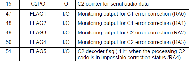

Attached is some terminals/pins of the Samsung DSP I talked about earlier which relates with C1/C2 handling. Why do you think C2 pointer is not sufficient?
Yes, perfect. That chip can be monitored nicely. It may simply be that the other chips label the pins "factory use", or "internal connection, do not use" or something similar.
Simple. The C1 flag tells you when error correction is invoked. You can then determine how much you are relying on error correction whereas the C2 flag only tells you that error correction has failed and further action will generate valid data frames, but the original information has in fact been lost.
If you want to gauge the quality of a transport, you have to look at the quality of the data coming off, not how many times it was too large a loss to reconstruct.
It's like looking at a car's steering. If it went around the corner, it could be said that the car steers fine (Mark), but counting the corrections necessary to keep it on course will tell you there are problems if there are constant course corrections required. You would need to know this before buying a car for example.
That's why such software as posted by Mark do not work for "ANY" drives (or any chips).
I think it is more basic. It depends on whether that memory can be peeked or not.

What I meant was (*), look at the Samsung chip. It has 5 terminals (FLAG1 to FLAG5) to monitor the flow of error correction (C1 and C2). These can be used to monitor how many times an error occurred. The other terminal (C2PO) is used for interpolation, which is not what you want.
(*Note: I'm a programmer and I was a bit confused with the interchangeable use of the words "pointer" and "flag". In programming, "pointer" usually refers to a "position", e.g. in a memory. So, I prefer C2PO to be expressed as C2FLG).
I wish we have some proposals for the chipset right now, so we can look into that chip in detail. You have mentioned your preference for Sony or Sanyo. I think I don't like Sanyo, just because of bad experience with certain servo chipset from this brand.
