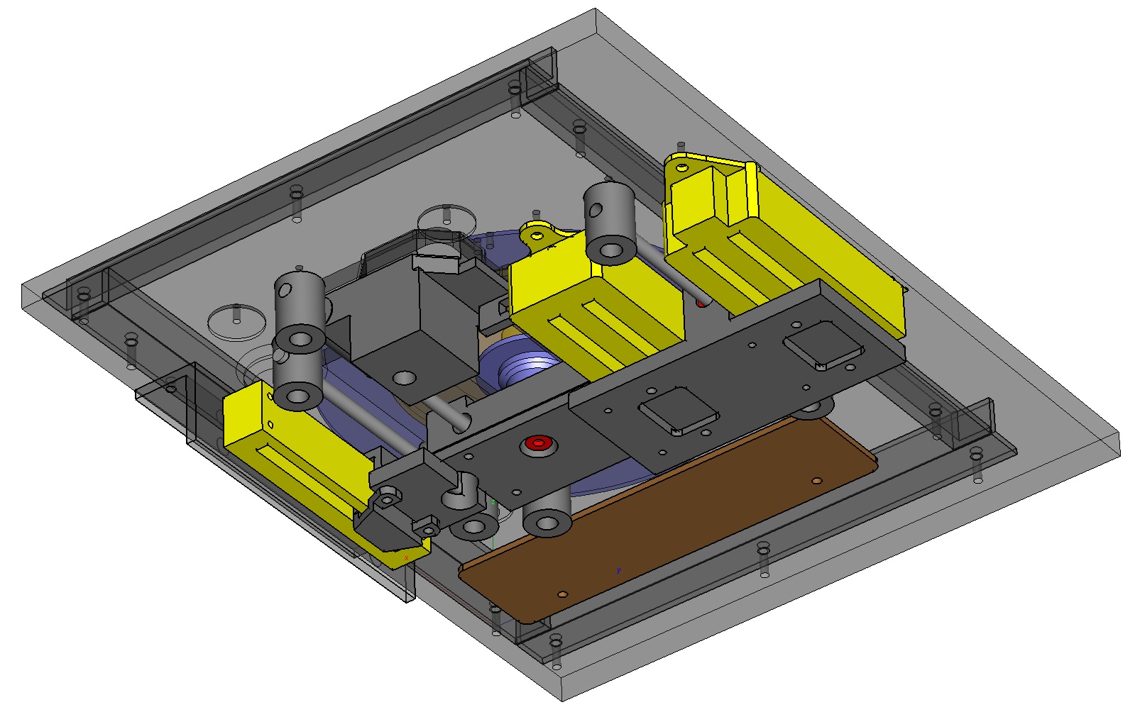

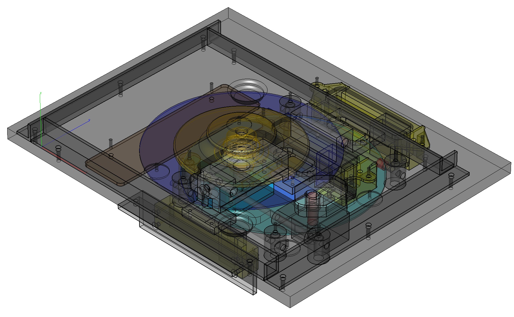

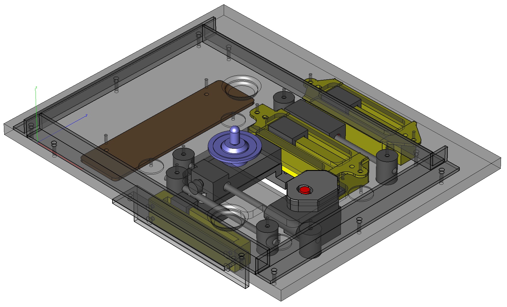

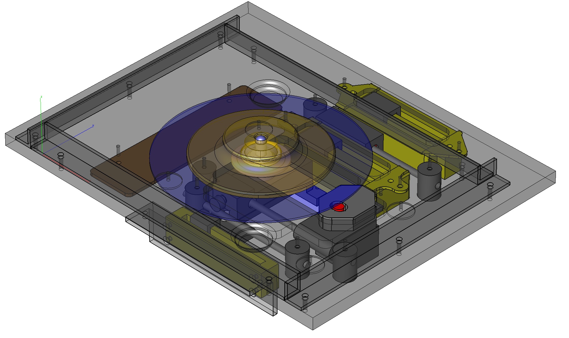

Here we go - almost finished drawing of a "Frankenstein"- Drive -
Built from a CDP-103 / 502 and CDP-X5000.
Does not look much different from earlier drawings, but is based on real world measurements -
hell of a work, sometimes 3 hours besides regular work, sometimes up to 12 hours in my spare time.
Must have been 10 days now working like this since the first draft
Could be milled right away. New parts are a traverse for the disc motor,
base plate and poles for fastening the rails. Stabilizer and Teflon inlay.
The rest is already there but had to be measured very carefully to make things fit and interact.
What is still missing are drawings some off the shelf spacers and fasteners.
That´s all. Maybe one or two bores to be repositioned.
About the "organs":
The X5000 will provide the BSL-motor and laser.
Magnets and colis from the CDP-105/502.
Laser is a KSS-273A. It has the RF-Amp on board.
All the best,
Salar

Hi Salar,
There's a song about a guy who built a Cadillac like that.
The P/U head. Didn't you want to leave that as simple as possible? Using one with the RF amp built in forces you into that head, and only that head. Forget making them on your own.
-Chris
-Chris
Hi Chris!
Any head can be put in later. This is why the CD is being moved,
you don´t have to redesign the traverse.
As this is #606 already, I´ve got to start with something.
This drive is to check whether moving the CD with magnets is definately possible an reliable.
And I do not have to cope with APC-circuits and RF Amps but only need too adapt the outgoing signals.
The baseplate has a thickness of 8mm, enough material to bolt in almost any head later.
But I will need help in gluing the electronics of the X5000 and CDP-103/502 together!!!
The X5000 Servoboard has more or less to drive coils now.
Disc BSL-motor and Laser coils will be kept untouched.
BTW, anyone with access to 3D-Metal printing appreciated!
All the best,
Salar

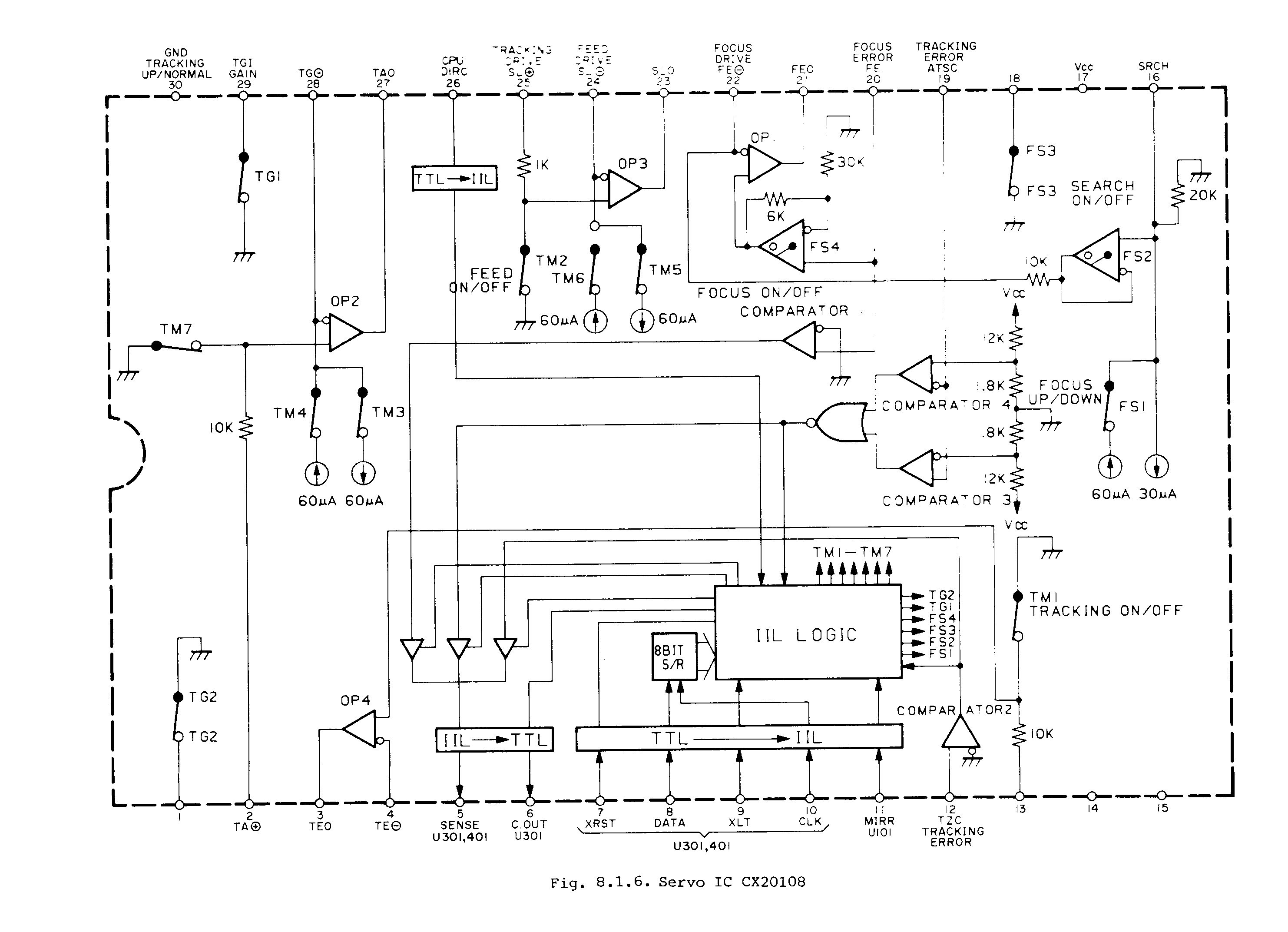

Well, those have to be made fit:
For driving the the sled the fifth generation CXD2515AQ
servo control IC of the CDP-X5000 will provide the sled signals for the linear drive instead of the first generation CX20108 of the CDP-103/502. I assume
sled signals have changed...?
Datasheets attached...
Manuals are to be found here:
SONY CDP-X5000 Service Manual free download, schematics, eeprom, repair info for electronics
SONY CDP-502ES 620ES SM Service Manual free download, schematics, eeprom, repair info for electronics
