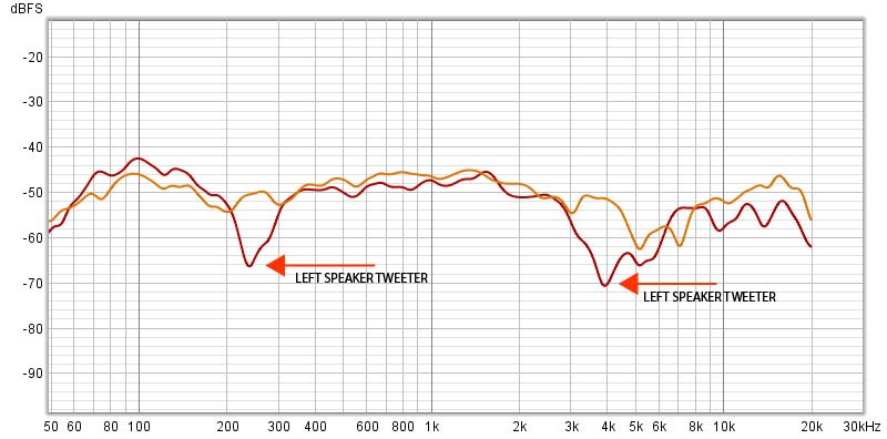

I've done some very close-up measurements (at 1cm). My final measurements I promise! They just might throw some light on the problem. Of course, my home measurements might not have much value. REW files attached. (in two parts as one file was too big)
Even so, it seems to me there is quite a lot of inconstancies between the panels, particularly the tweeters.
I can't understand why the tweeters are not rolling off at the bass end. Perhaps there's leakage from the bass panels. Despite being measured at 1cm from the grill.

First, I see 2 discrepancies in the tweeter panel of the left speaker. There are 2 large dips in the SPL. One in the low frequencies and one in the high.
The first is at 250 Hz, down 20 dB, the second is at 3.8 kHz and is down 25 dB.
You can also see the difference in the tweeter panels in the step response. The one in the left speaker has a very large overshoot.
Very very careful conclusion: The tensioning of the Mylar on that panel is too low?

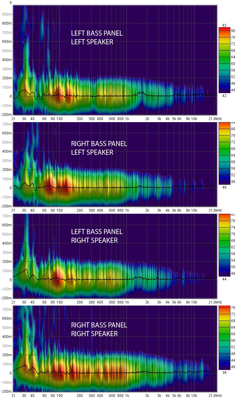

Second, I see much more energy in the right speaker right bass panel over a much larger frequency range than in the other 3 bass panels.
Don't see much difference in the SPL on the bass panels, but there is definitely something going on in that right speaker right bass panel.
In general all bass panels are not very much in line energy spectrum wise I think, but the right panel in the right speaker is off the most.
No conclusion here. I see the differences, no idea what might cause them.

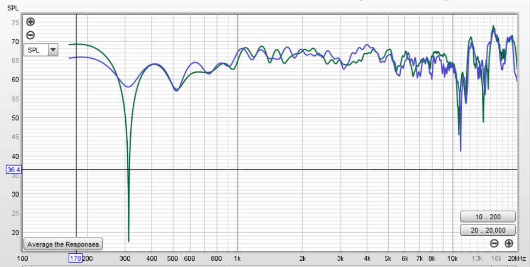

I try to do some analysis to the first measurements you provided and got rid of harmonics due to room circumstances and got this. Left in green and right in blue. Then i can see the dip at 311Hz in left speaker... this is now with no smoooting. Done by editing your measurement in REW
From your step response, it's clear the tweeters are in phase, but the L one has about 2x the output of the R one (3dB).
Assuming the mic to tweeter distance in both cases is the same, and considering OTA's meticulous craftmanship, there's a possibility the 2 tweeter panels are different, as is the case with the bass panels.
