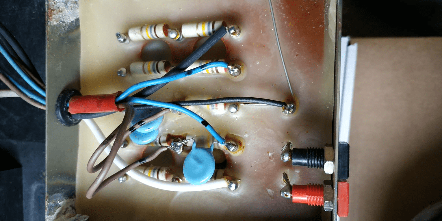

Hey, I can answer my own question: OTA installed a protection board at the left. The red wire goes there from the Rear Treble turret, the other wire is not visible, but should go from the Front Treble directly. Only you can check it.Hello, I annotated the photo of your trafo bottom. Please check if each wire goes where it should. And where does the thick red wire go from the RT turret? (RB = rear bass, FB = front bass, RM = rear middle, FM = front middle, RT = rear treble, FT = front treble)
Hello, the other red wire from the clamp board goes to the next terminal to the right of RT as marked in your photo. Not direct to the treble FT.The red wire goes there from the Rear Treble turret, the other wire is not visible, but should go from the Front Treble directly. Only you can check it.
Regards, to the markings you made on the crossover circuit and thank you for that. The bass connections were correct until I reversed them to put the bass panels in phase with my right-hand speaker. So perhaps that speaker should have been changed? With regards to the tweeter connections you can see from the photo that it is not possible to see if they are wired correctly.

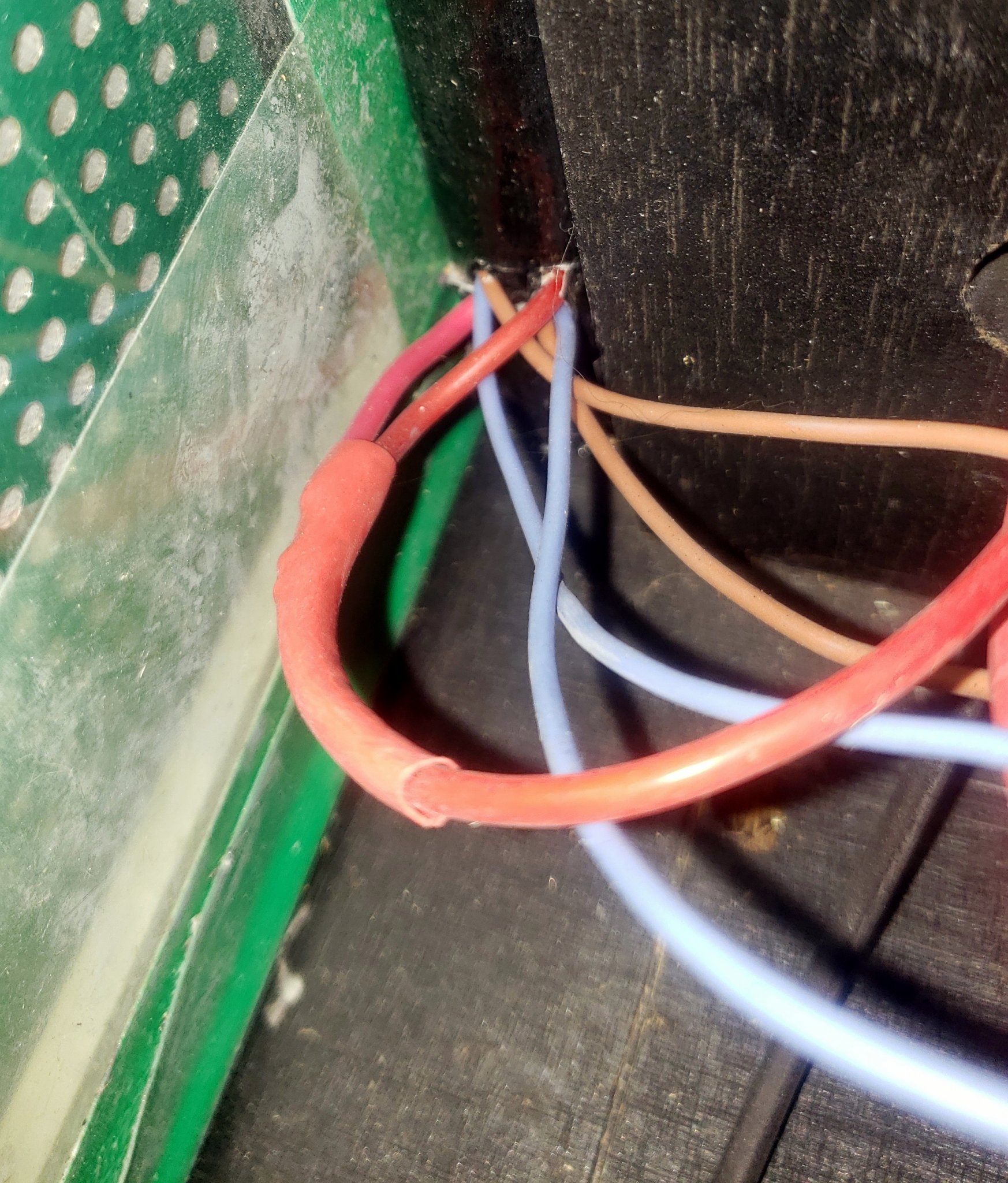

But before that, use the opportunity to visually check the wiring: from your pic "Tweeter connectons", it's very easy to see which wire is front, and which is back. I use a sharpie to mark the wire transformer side, it may take a few wiggles.
Also, check all other wirings for consistency.

I checked both brown and blue wires on both Quads very carefully and they are correctly wired. It is only the bass panel wires on my left speaker that I changed around to make the speakers sound in-phase when the red & black's are connected correctly to the amp.it's very easy to see which wire is front, and which is back.

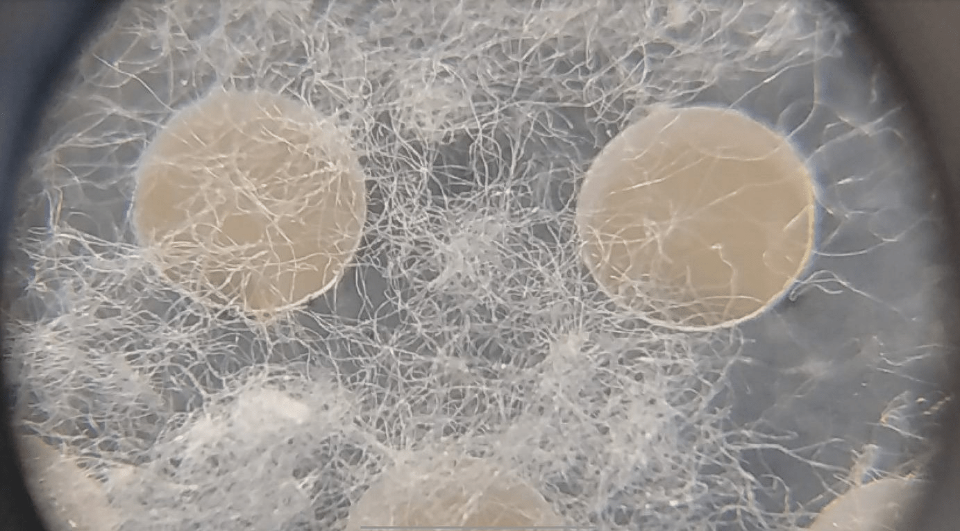

OT, but I can't resist: here's one the delights I found in a bass panel I bought off eBay, advertised as "serviced, new wiring, tested. perfect..., in excellent condition".
As an extra bonus, they left a blob of cotton between the stator and the dust cover!!!
Not good.

Wow, can you provide a link to that ebay listing so I can be sure to avoid it?OT, but I can't resist: here's one the delights I found in a bass panel I bought off eBay, advertised as "serviced, new wiring, tested. perfect..., in excellent condition".
We should know about that.
The forign crud in the speaker isn't great, but it's super easy to have something trapped somewhere in the original quads. Those wooden dust cover frames are often quite roughly cut wood and can easily grab hairs, bits of paper towel, etc. As long as the crud isn't conductive, the speakers are surprisingly forgiving. Don't forget they weren't made in a cleanroom, they were made in a pre-war style factory and cranked out as cheaply as possible. So I wouldn't be too hard on the rebuilder for an occasional screwup, what matters is that the rebuilder quickly and crisply rectifies their problems without a lot of bullsh1t. This tread exists because this rebuilder didn't fix his screwup after a second try.
