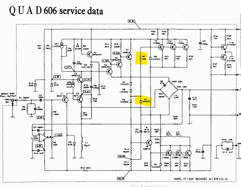

I have a few questions on the Quad 405 that I am struggling to understand and that I can't find answers to. I have built two Chinese Quad 405 clones (LJM), of a Quad 405-1 revision. I have implemented some of Keith Snook's and Bernd Ludwig's suggested modifications. Some of which were successful (e.g. the non-inverting Opamp configuration lowers the noise) others not so (the 'ring of two' class-A output stage with the feedback capacitor C8 returning to the emitter of Tr2 not being HF stable). I have limited means to measure absolute distortion figures (PicoScope 2000), so with some modifications, I have to rely on what others have tested and published. I am also looking at the subsequent Quad 306 and 606 to see if there are any other modifications that could be beneficial to the 405.
My questions are the following:

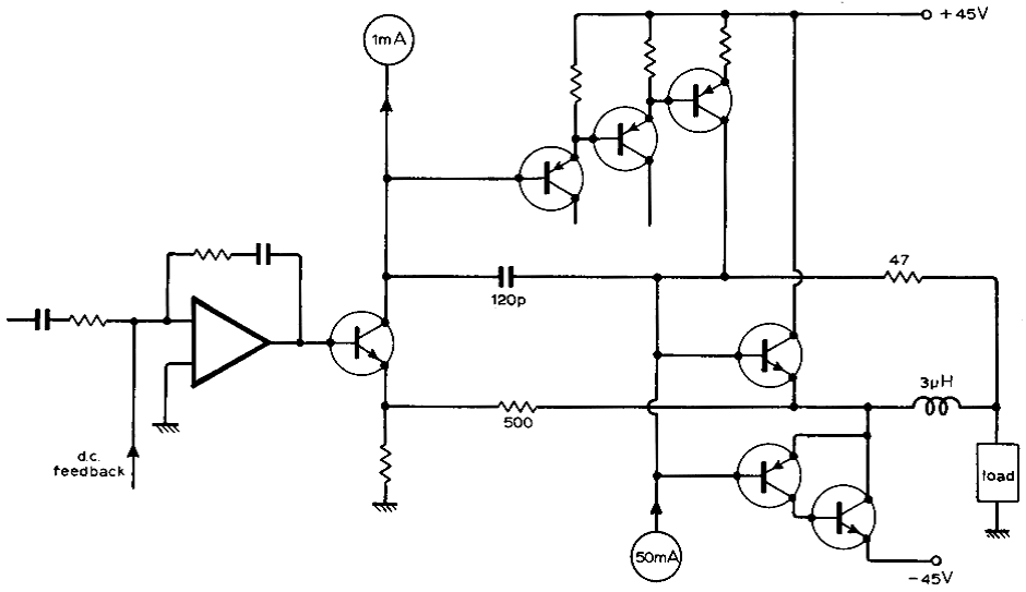

- Walker's papers show a current source for the class-A driver of 50 mA. In the 405 these are resistors R30/31 setting the current to 50 V / 2 x 0.56 k = 45 mA. The closest you can get to 50 mA with the E-12 series. Fair enough. In the 306, these resistors are kept at 560 Ohm, while the supply voltage is lowered to -38 V, lowering the current to 34 mA. I am planning to run my "Quad's 405" on + and -42 V. Is there any benefit in lowering R30/R31 to 470 Ohm, as this would bring the current back up to around 45 mA?
- Snook shows a base stopper resistor of 10 Ohm for upper dumper Tr9. Quad introduced this in the 606 where there are triple dumpers (R7 in the 606 schematic). I suppose to promote better stability. However, for a single transistor output, 10 Ohm seems much too high to me as a single TO-3 output transistor suffers from significant beta-droop at higher currents. Wouldn't 2R2 be more sensible, if at all necessary?
- In the 306/606 and further revisions, Quad introduced another diode in the dumper section (D7 in the 606, D8 in the 306). It anti-connects the base/emitter of the upper dumper(s) (Tr9/10/11). What is the purpose of this diode. Would there be any benefit in implementing this in a 405?
The diode protects the emitter junction from excessive reverse voltage. The base-emitter reverse breakdown voltage is low, typically 5V, and can easily be exceeded e.g. in case of clipping or shorted output.Quad introduced another diode in the dumper section
Thank you for your answer. Pardon my ignorance, but would you know why it was only added to the upper dumper, and not the lower one?The diode protects the emitter junction from excessive reverse voltage. The base-emitter reverse breakdown voltage is low, typically 5V, and can easily be exceeded e.g. in case of clipping or shorted output.
It was added between them, not to either one or the other of themThank you for your answer. Pardon my ignorance, but would you know why it was only added to the upper dumper, and not the lower one?
And I have no belief in the protection theory advanced here. The Quad documents state that it was added to ‘correct the response at 20kHz’.
@ejp you are right about the extra diode to reduce the dead zone (D15 in the 405-2 schematic). My question was on D6 in the 306 schematic. Since I have never seen such a flyback diode on an emitter/base junction, I think I will not implement this.
As for my first question, I will test the amplifier at both 50 V and 42 V, with and without altering the current source R30/31 for the 42 V supply, and try to check for differences in harmonic distortion.
For my second question, I will not go with a base stopper for the upper dumper unless I see HF instabilities, and then I will max. it at 2R2.

I believe that seeing it as 'errors being detected' when the dumpers switch on is not useful for understanding.Before the Dumpers switch on, there is exists linear feedback, from O/P to I/P on the class A amplifier.
5. When the Dumpers switch on, additional to this feedback is the error detected by the ''Bridge'', which is monitoring; effectively, the difference between the input signal to the Dumpers and their output.
What happens is whenever a dumper current changes, the feedback factor changes to take that into account. It is a continuous process, there's not really two different situations. There is only one situation and a dumper current that varies from almost-zero to some value; the total feedback factor depends also on the dumper current and this is a continuous process.
For analysis it may be help ful to consider the situation with dumper current = zero and dumper current = xA, but the operation is continuous.

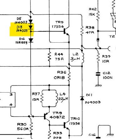

No. @jan.didden has already covered this. The process is continuous. There is no need for the dumpers to be 'past their non-linear region' (which is itself ill-defined). Whatever the dumpers do to the output signal, the Class A part will correct. That's hos the bridge works.However, my understanding - rightly or wrongly, remains unchanged, but very open to persuasion. For the Dumpers to 'Overlay'' the class A section accurately, they must be 'Triggered'' into the on - state very quickly, and at a point where they are well past their non-linear region.

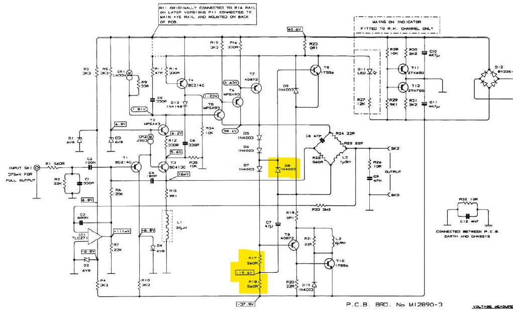

There is no D15 in any 405 schematic. I was referring to D13.@ejp you are right about the extra diode to reduce the dead zone (D15 in the 405-2 schematic).
D6 in the 306 schematic is in the same position as D6 in all the Quad 405 and 405-2 schematics.My question was on D6 in the 306 schematic.
D6 is not a 'flyback diode' and it is not connected between any emitter/base junction. There are two flyback diodes in the 306, D9 and D10, and they are connected between collector and emitter of T9 and T10. There are no b/e-connected diodes in the 306.Since I have never seen such a flyback diode on an emitter/base junction, I think I will not implement this.
Accuracy please.

You are right, it is D13. Typo on my side.There is no D15 in any 405 schematic. I was referring to D13.
You are right. I meant 'D8' highlighted in the schematic.D6 in the 306 schematic is in the same position as D6 in all the Quad 405 and 405-2 schematics.
There is, it's D8. My question was on D8.There are no b/e-connected diodes in the 306.

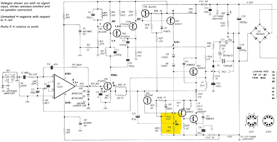

BTW, I conducted tests running a 405 on +/- 42 VDC with both the class A resistors at the original 560 Ohm and at 470 Ohm at 8 and 4 Ohm loads (including capactive loading) and did not see a difference in harmonic distortion or profile, so I kept these resistors at 560 Ohm. I did have to install a 5 Ohm base stopper in the upper dumper to control oscillations in my set-up.

The transient which occurs when the dumper starts to conduct is short lived as the bridging network feeds the class A amp, which quicky; because of its gain, switches the dumper on at a level which coincides with the class A output signal - adding current to the output voltage of the class A. Speculation - any distortion which occurs at that juncture, will be reduced by the increased feedback from the dumpers, adding to the fixed feedback of the class A amp; after the transient has driven the dumper on.
Beyond time zero, this is a continuous process with the dumper transients, being shaped; my belief, by the bridge and fed to the class A input, along with the feedback proper from the class A amp and that from the now operating dumpers.
Perhaps it is the way my brain is wired, but that is the only way I can see this working. The bridge is rudimentary and indeed it was claimed that component tolerances were unimportant to the design. For it to work otherwise, time constants relating to the dynamic loop gain would be crucial to ensure at the very least they conformed to some factory standard.
Yes, there is no question it is a continuous process. However, I believe the error signal is a combination of conventional feedback from the class A, and the Dumpers, when conducting, upon which is superimposed a trigger - for want of a better word - derived from the transient which occurs when the dumpers start to switch on, and shaped by the bridge network. Indeed, it is only required to provide a ''Trigger pulse'' to switch the dumper on quickly. The point at which they switch off could be pre - set as part of the design.
But still there remains the issue surrounding the continuous process - in my mind that is. The continuous process is a consequence of what has gone before. I.e., a reaction to the signal crossing the threshold of the target area. Therefore it is always playing catch - up.
Assuming, time zero - If the amplifier is handling an audio signal below the point at which the Dumpers conduct, the the only feedback is that designed into the Class A amplifier. The output signal therefore is governed by the gain of the amplifier, i.e. input signal x gain. assuming zero phase delay, then the audio is a clean representation of the input, times the gain.
When the audio gain is above the target threshold, the Dumpers switch on, but the control signal has not yet been established. It takes a finite time for that to occur. True, the feedback of the class A amp is still present, but not yet that of the dumpers.
Assume also that the Wein bridge arrangement does not exist and when the dumpers do start to conduct, they add further feedback to the overall loop. Would that not reduce the loop gain and potentially reduce the level of output signal back below the dumper threshold?
In that situation, the class A is not exercising control over the dumpers - or am I missing something? However, following along these lines, there has to be something to prevent that happening. That, I argue, ''there is an element of hysteresis inherent in the design, such that although the dumpers switch on at a given level, they switch off again at a lower level?''
I am writing this and thinking on the hoof so please bear with me. The lower level must still be at a point where the dumpers remain linear. Is this the purpose behind the window and if it is, then the upper level must still be within the power capability of the class A amp.
However, adding the bridging circuit, I would argue, would not have such a dramatic effect upon the amplifier, as a whole. To my way of thinking, only an external signal source, independent of the loop gain of the class A and dumpers can do that! And that, I believe, is the trigger/transient which appears at the input to the bridge element, from the dumper as it starts to conduct.
The bridge may well shape the trigger and yes it is true it is continually moderating - if that is the right word - the feedback, even when the dumpers are switched off (?). But it is, I feel, the initial transient transient from the dumper(s), which establishes the current dumping process.
