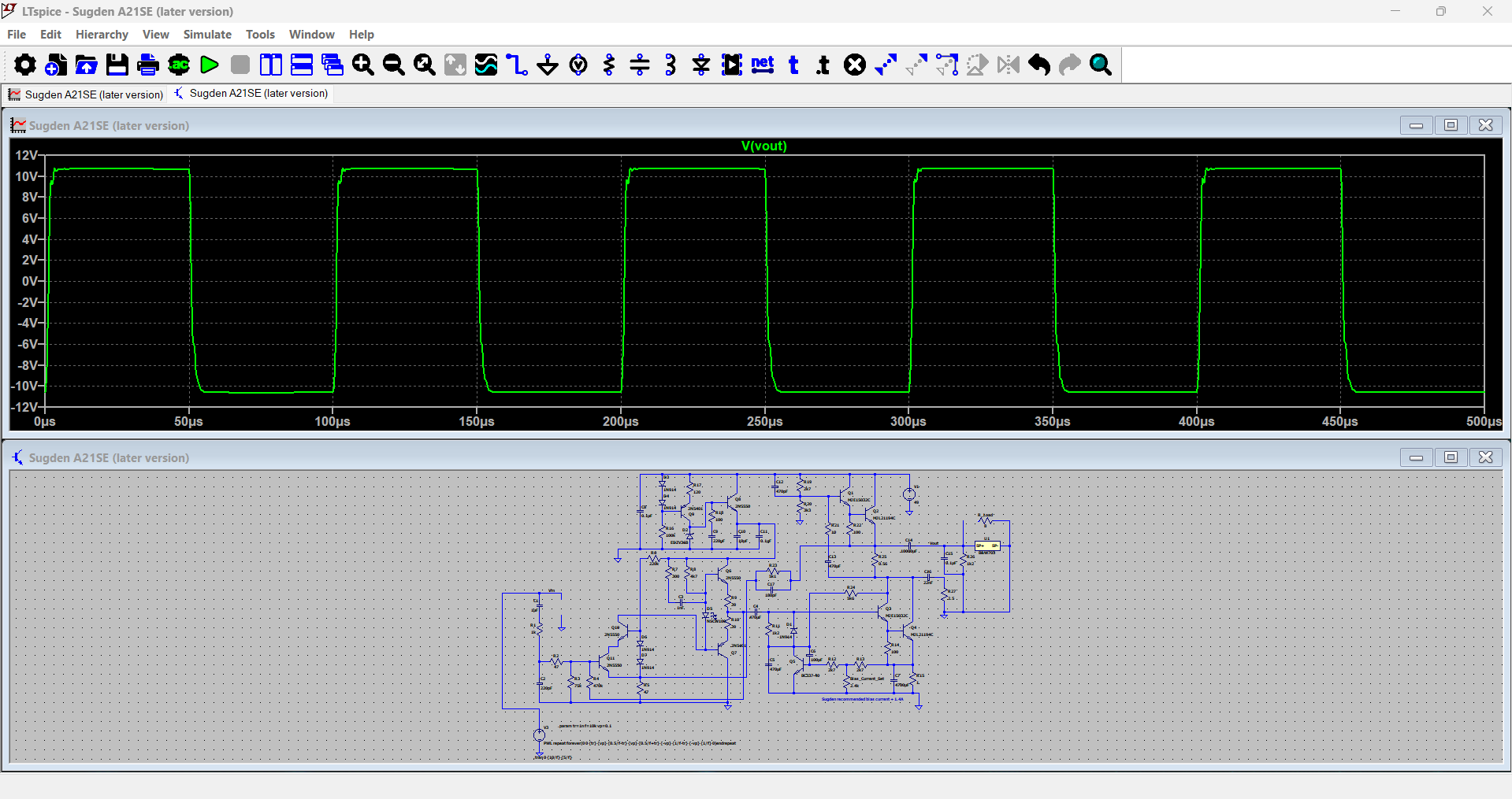

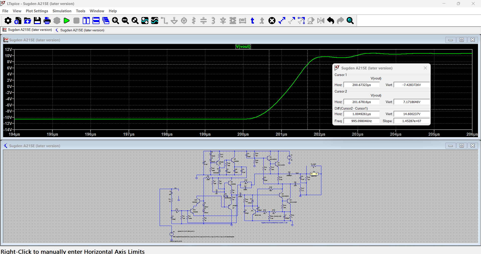

I would be interested to know what the Slew figure is for the Sugden A21 or any of their pure class A Amplifiers.
About 14v/uS for the A21SE. This is feeding a quite highly reactive speaker load (simulated B&W 703).

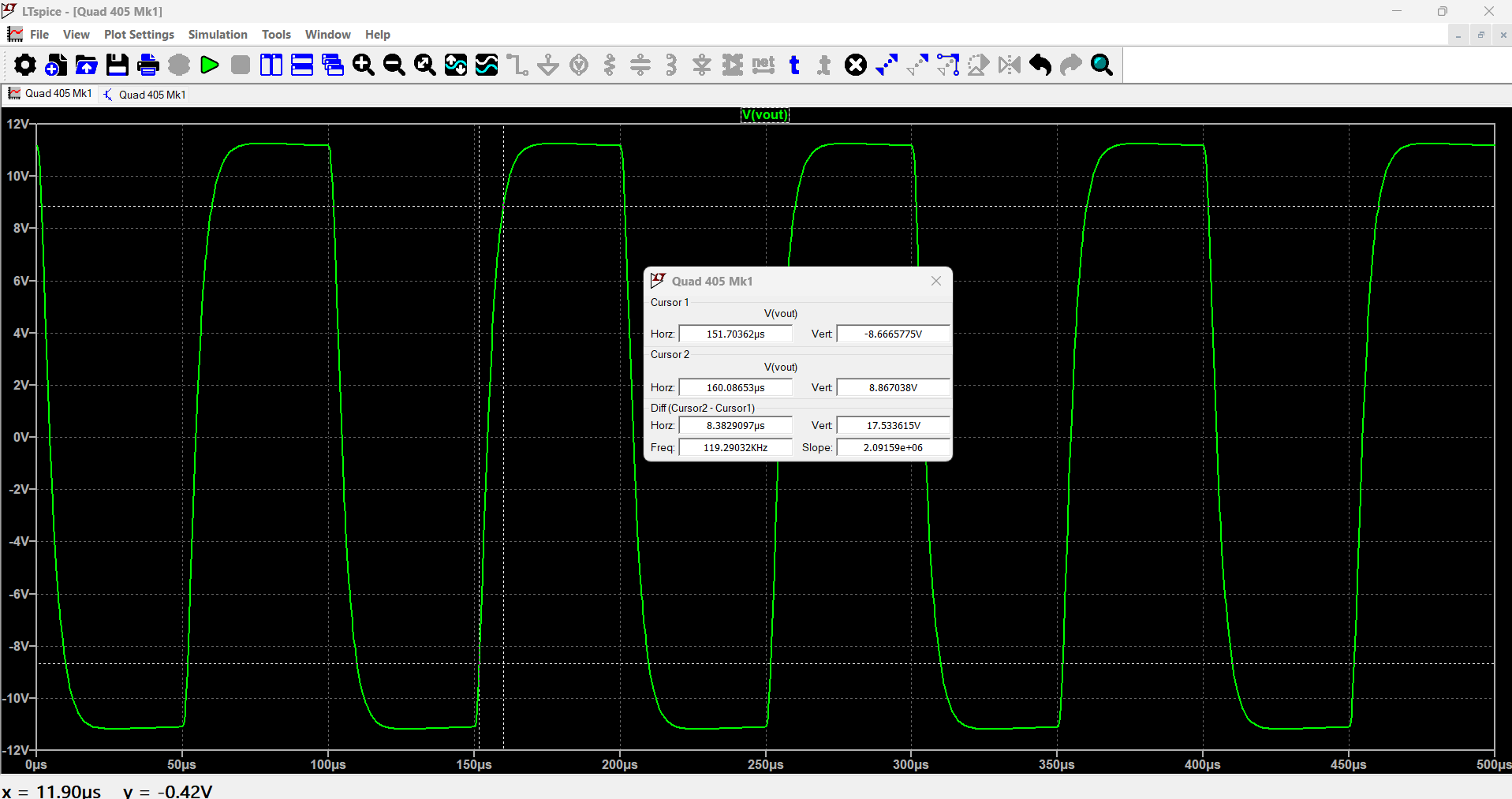

What is the slew rate for a 405?

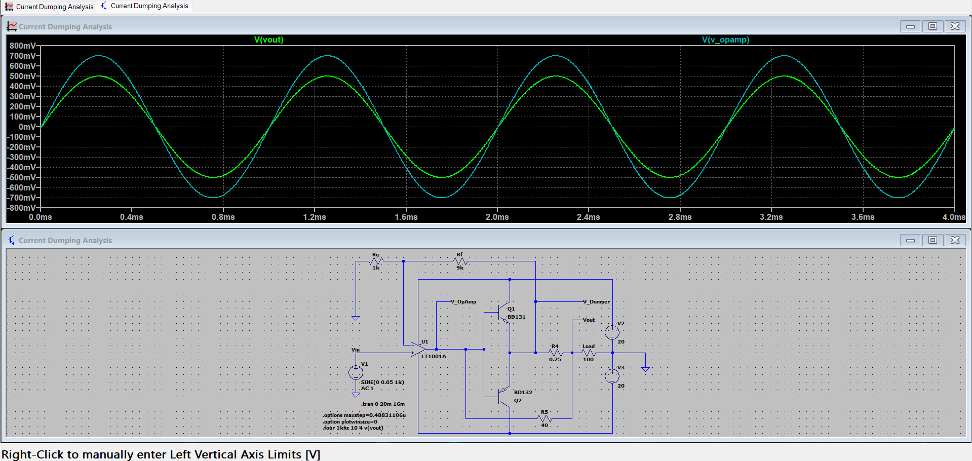

Here is comes in around 2.1v/uS over similar conditions to the Sugden. (I have quite a few amps as simulations in case you are wondering 😉)
This one is nicely controlled and this is into the reactive load.

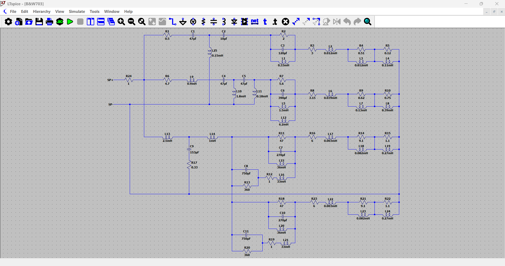

This is the simulated speaker load which really is a tough test:

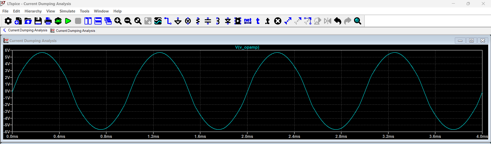

Here you go. First up is at the 50mv input level. Notice the opamp output is much larger than the wanted output voltage because of the effect of R5 being in series with the load.

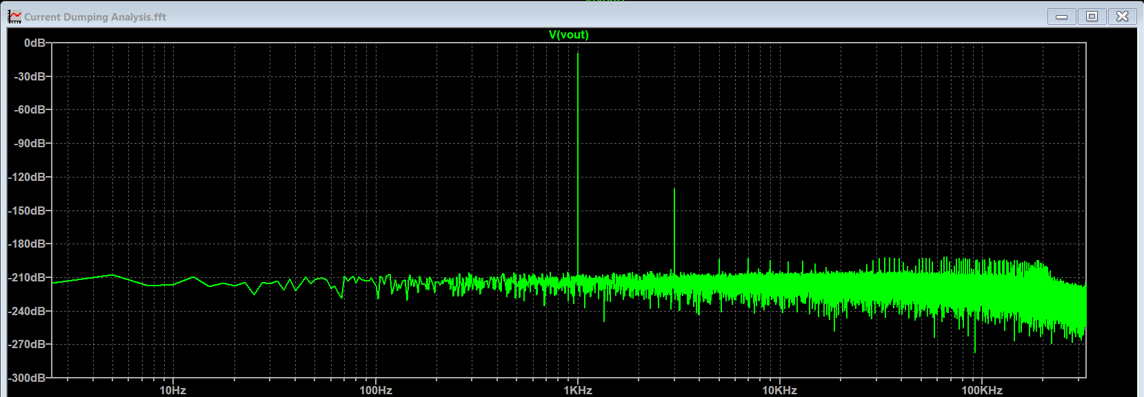

And now with 0.5 volt applied.
The opamp models are more like behavioral models and the distortion of the opamp alone is spectacularly good as a simulation, its nothing like a real discrete component design. This is at the 500mv output level into the 100 ohm load. The transistors are snipped out.
I've attached the sim with some default models if anyone wants to play.
Correct me if I’m wrong, but R4 in the actual Quad is the inductor, right?
I believe it’s the inductor that’s responsible for the rapid “slewing” seen between the emitters of Q1 and Q2. Recall that inductors try to maintain their instantaneous current and change their voltage in an attempt to do so. (Think about the dynamics in a switching power supply when the switching transistor opens and the inductor swing to the catch diode.)
I’m not negating the analysis cited earlier, just offering a description of what I think may happen in the circuit. The switching transition between the emitters happens so quickly that that the circuit could be argued as continuous, thus justifying linear analysis.
Mooly is the wizard with LTspice. Maybe he can contrive a time aligned simulation of opamp output, Q1,Q2 emitter voltage, and inductor current. That might either confirm or put the lie to my conjecture.
My understanding was that the resistor is lossy at high powers (efficiency suffers) and to get around that the resistor was replaced by an inductor and to maintain balance in the bridge is where C8 in the original circuit comes in (the 120pF).
In a simulation for example I can only guess at values such as coil resistance.
