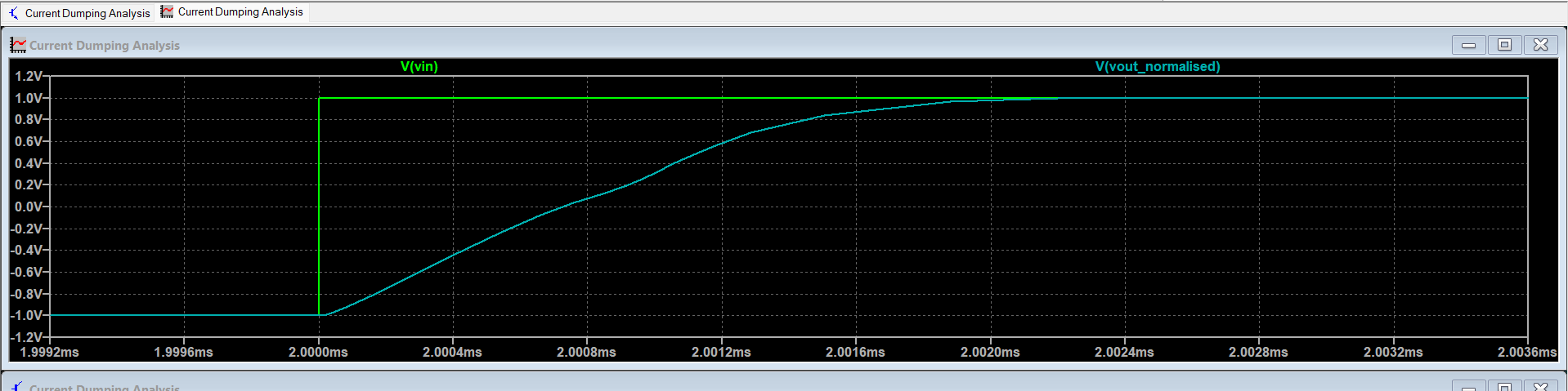

If the simulation shows that it’s wrong. What it should show is what is actually observed at the bases of the dumpers, which is a normal signal in the class C’off’ angle, and then a very flattened curve as the dumpsters switch on and take over.The simulation shows the class A output moving very quickly while in the crossover notch, and at normal speed once outside of the crossover notch.
@delphiplasma, @Dumpster -The Quad's distortion is due to feedback. In open-loop, the Quad's output stage has high distortion compared to an optimally-biased class AB output stage.
@ejp - Unfortunately, I can't find the post.
The "flat" portion with the dumpers conducting is the normal rate of the audio signal.
The "accelerated" portion with the dumpers off is the normal rate multiplied by (Rload + Rfeedforward)/Rload.

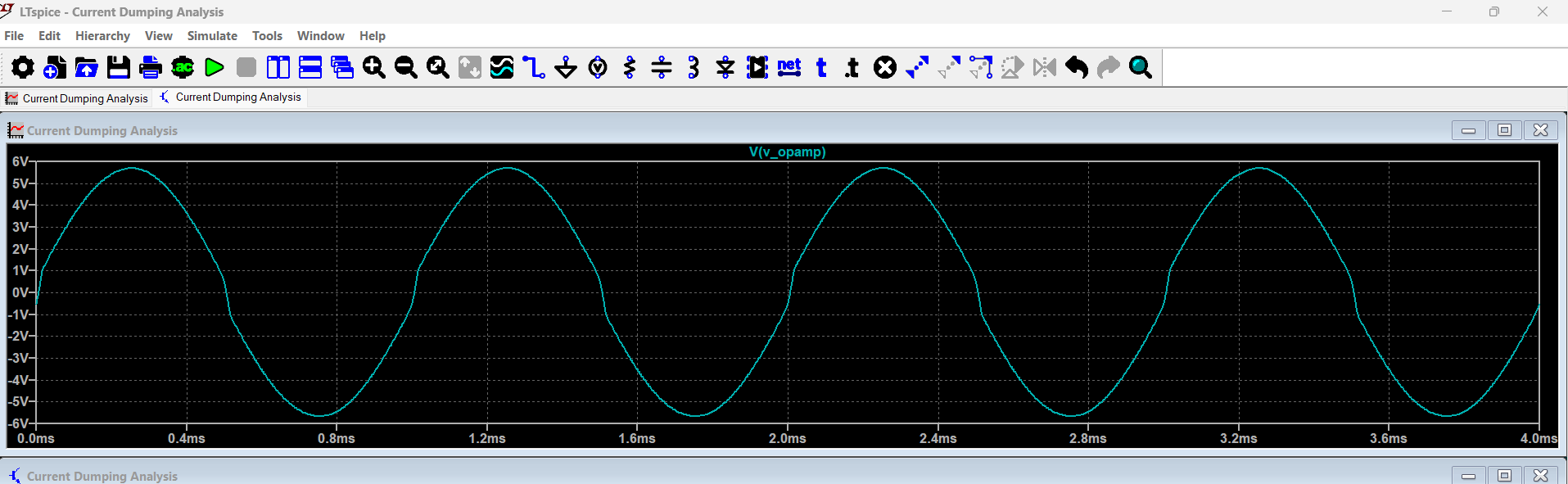

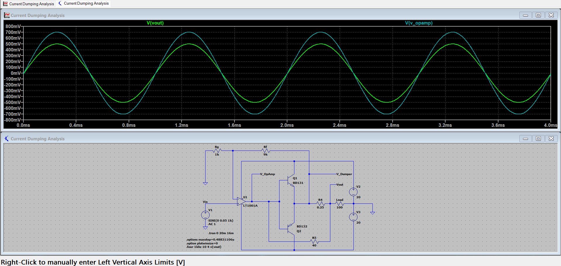

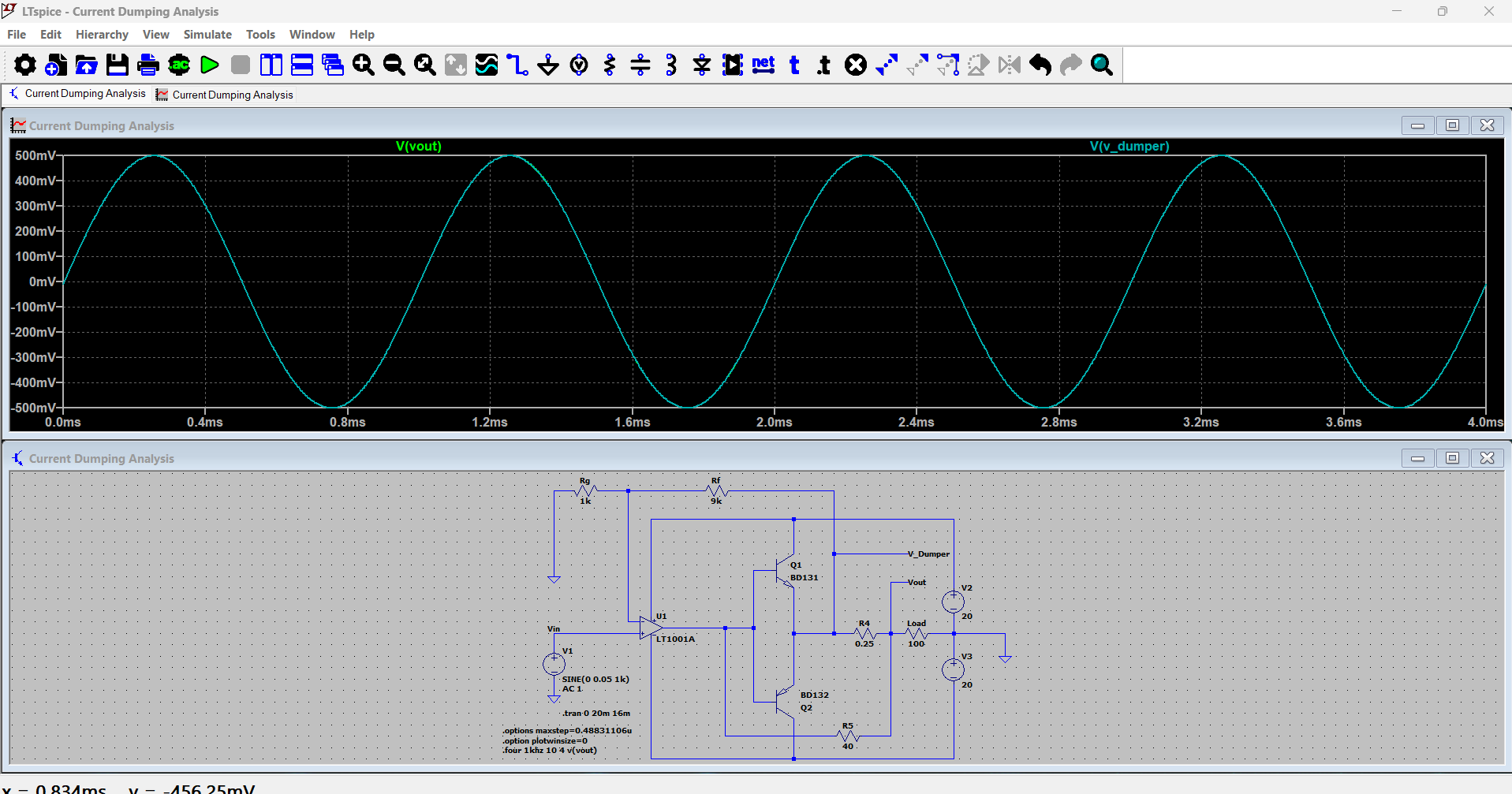

This shows a simple opamp and Class C biased output pair. The opamp takes the place of the high quality Class A amp. As you can imagine, it has a very low ability to drive the 100 ohm load. It needs the dumpers to to achieve decent output levels.
The gain is set by Rf/Rg although Rf is looking at the output node also via R4. So Rf is actually appears as 9000.25 ohm when the transistors are 'off'.
So far so good. If we look at output voltages we don't see what we might expect to see... so lets switch to looking at currents instead a little later. This is the amp fed with a low input voltage. We are going to be looking at the load current and the currents in R4 and R5 as these two current combine at the output node as they flow into the load but first we will look at voltages, just to show it all works after a fashion.
50mv in and 0.5 volts out. Gain is (9000.25/1000)+1 which is essentially 10. Vout and V_Dumper are superimposed on each other. They are the same. The only current in R4 is the feedback current. The transistors are off.
I know its all an imperfect analogy in many ways but this will show in essence what is going on.

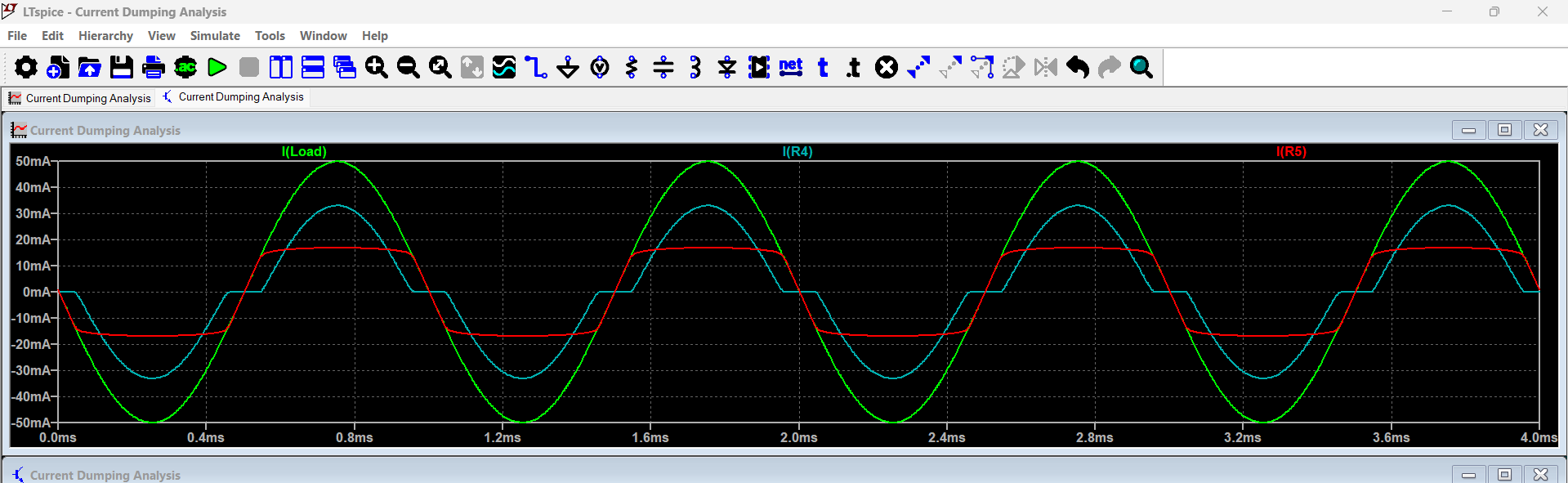

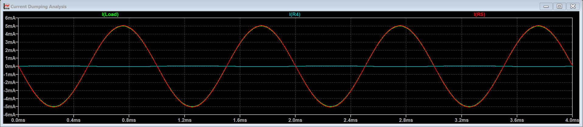

Let us now switch to current and see what that looks like.
The load current is clean and the contribution is 100% opamp (via R5) and nothing via R4. Again the load current is the sum of the dumper current (zero) and the opamp output via R5. The opamp is supplying all the load current at these low outputs.

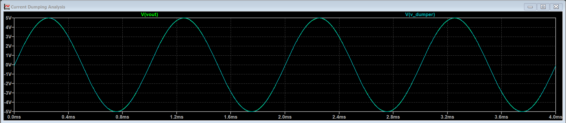

Now we increase the input voltage by a factor of 10 and just as a quick check we switch back to looking at voltage again. Notice we now have 5 volts output.
As before lets look at currents.
The load current in green is undistorted but its how that current is made up that is interesting. We now have both the dumpers and the opamp now contributing. The dumpers are contributing the typical Class C biased distorted output signal and the opamp is adding a current that perfectly adds to that distorted signal and sums to the clean load current.

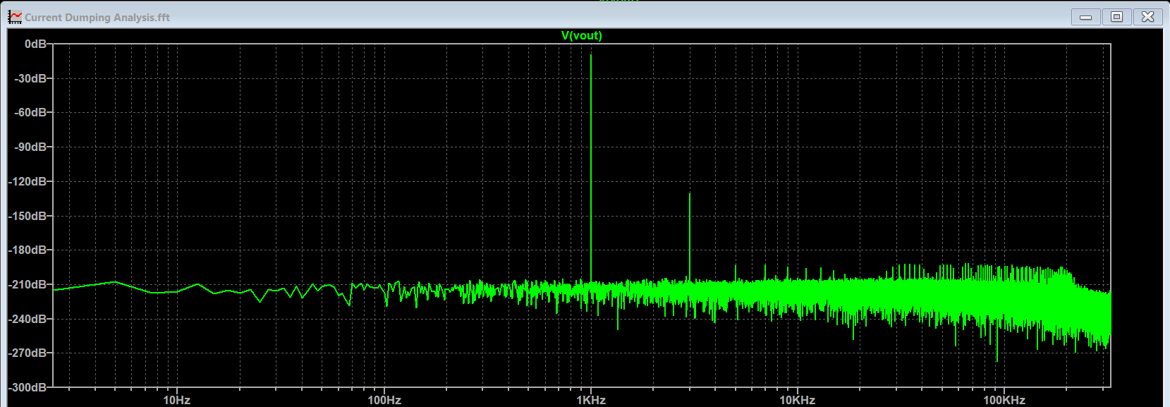

This final shot shows an input voltage of just enough that the opamp can't quite manage and the dumpers contribute a little. You can see the dumpers adding just that little bit of load current that the opamp can't manage. Again it all sums to a clean load current.

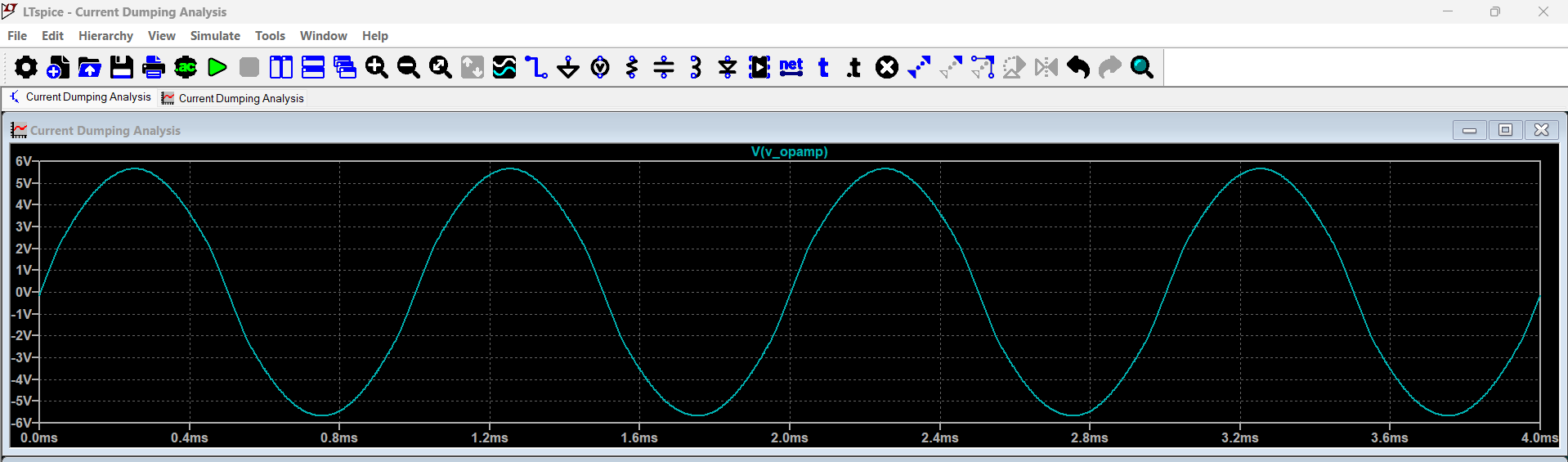

@Mooly - Thanks for the waveforms. We are interested in the voltage at the output of the op-amp with Rload=4 or 8 ohms. Its shape will look somewhat similar to I(R5).
Ed
Ed
Ed
Here you go. First up is at the 50mv input level. Notice the opamp output is much larger than the wanted output voltage because of the effect of R5 being in series with the load.
And now with 0.5 volt applied.
The opamp models are more like behavioral models and the distortion of the opamp alone is spectacularly good as a simulation, its nothing like a real discrete component design. This is at the 500mv output level into the 100 ohm load. The transistors are snipped out.Yes, thanks Mooly - excellent. It would be interesting to see what the loop gain of the Class A amplifier is with the output dumpers disconnected and its noise contribution.

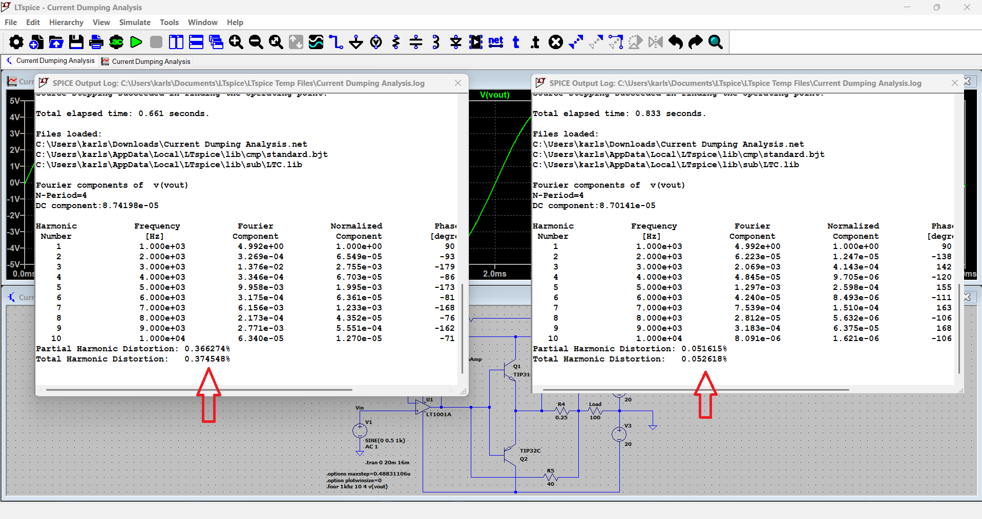

This is with 300 ohm for R5 which shows the opamp slew quickly across the dead zone.
An opamp swap makes a big difference surprisingly. LT1001 at the left and LT1056 at the right. The LT1056 is a bit like a TL071, quite fast and FET input.

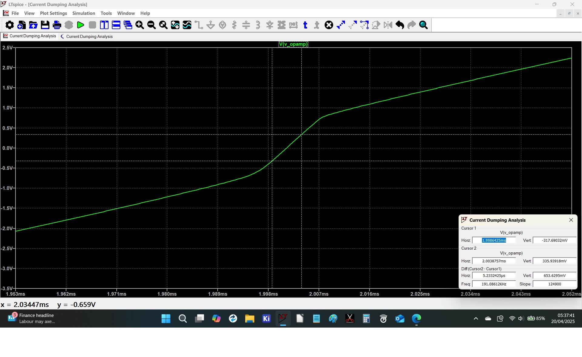

This the opamp output in the dead zone.I don't suppose there is any chance of calculating/guesstimating from the plot the change in Slew Rate.
Using the two cursors and their info and if I've done the maths correctly it is slewing at about 0.652 volts in 0.00523ms which works out to approx 0.13v/uS which is very slow but then this is a only a 1kHz sine that is traversing the dead zone of two B/E junctions.

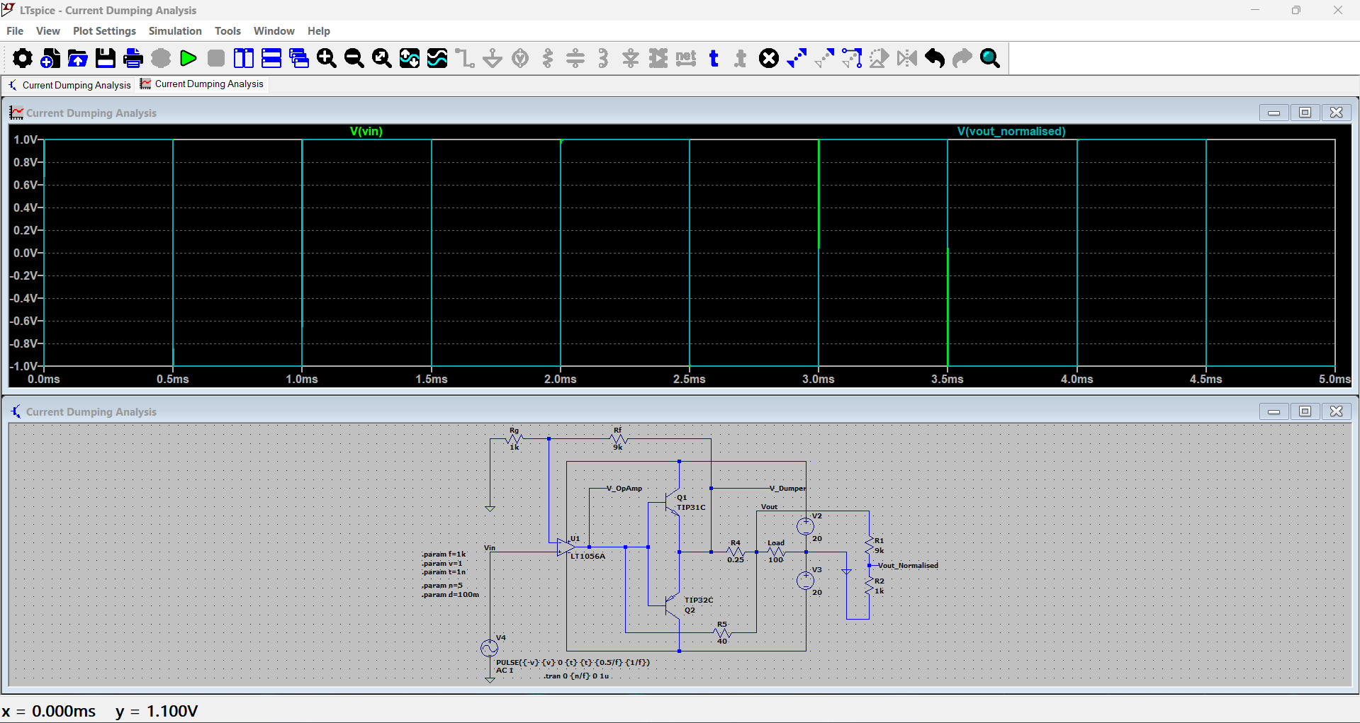

Can you trigger it using a 1mS pulse train with short duration - if that makes sense? I.e., start/stop pulse gen., looking at delay across the amp? Jeez - I regret not being hands on. Rise time being calculated as from 10% low to 90% high value of pulse - rudimentary I know.
Not sure if this is what you mean. A very fast rise and fall time squarewave applied. Second image is zoomed into the rise time. Remember that the bandwidth of any amp determines how 'fast' it is and that wide bandwidth amps will pass a signal 'quicker' than a low bandwidth one. In other words the output appears phase shifted or delayed from the input and that figure depends on the bandwidth.
The output signal here is brought back down to the input level by feeding it through an attenuator equal to the feedback factor of the amp. The two signals superimpose on each other.
