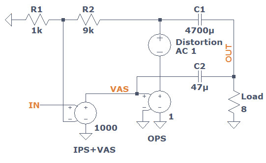

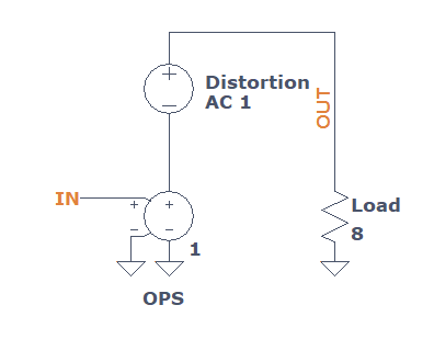

Let me start from the "current dumper" a.k.a. output stage, represented here by an ideal voltage follower OPS in series with the source of distortion with the amplitude of 1, or 0dB:
View attachment 1313255 View attachment 1313266
It doesn't matter if it's 1V or 1mV or 1μV, as I will be interested in the attenuation of this distortion, and not the absolute level of it.

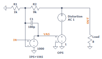

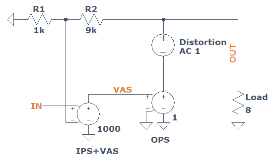

Next, let's add an input stage + voltage amplification stage with the combined gain of 1000 (for now, independent of frequency), as well as a 1:10 feedback divider, to build a normal feedback amplifier with the gain of 10:
View attachment 1313269 View attachment 1313268
The feedback reduces the OPS distortion by a factor of (1+Loop Gain). The Loop Gain is 1000/10=100, so the distortion is reduced by a factor of 101, or just below -40dB. (If you are unsure how this works, you can look e.g. at my blog or other places that discuss feedback theory basics.)
In order for feedback to reduce the distortion of the OPS by a factor of 101, the VAS should feed the OPS with "pre-distortion" with the level 100/101 (or-0.086dB) and in the opposte phase:

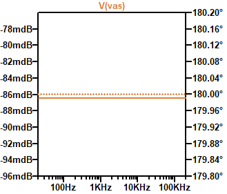

If we combine the output of the VAS and the output of the OPS in the 1:100 proportion, we get a distortion-free output. (Here, -322dB is as close to negative infinity in dB as LTSpice can get):
View attachment 1313273 View attachment 1313275
This is how Walker's distortion compensation works. Note that the proportion of the OPS to VAS outputs at the load is equal to the amplifier's loop gain. And look, mum, no bridge!
Naturally, you can use appropriately scaled inductors or capacitors for summation:
(If you want to simulate this with inductors, keep in mind that LTSpice adds a default series resistance of 1 milliohm, which messes up the distortion cancellation. If you set the series resistance to zero, the simulation is messed up in a different way.)
The frequency-independent gain assumption above was unrealistic, but it allowed me to show the principle more clearly. I will follow up with another post where the loop gain becomes frequency-dependent.

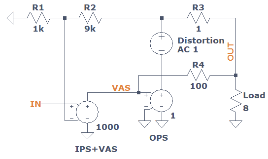

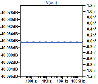

Another way to view it is as follows.
There is a main feedback loop from output to input.
But when the dumpers start to conduct, additional feedback from Z4 (the impedance in series with the dumper output) is generated.
This is significant: in any 'normal' feedback amp, the feedback factor is constant (it's normally a two resistor divider).
But in a CD amp, the feedback factor changes depending on what the dumpers do!
In a normal feedback amp, the loop gain determines how much the distortion is reduced, and this is, to a first approximation, a constant as long as the gain is constant.
In a CD amp, the gain is not constant, and depends on what the dumpers are doing.
The feedback factor change with dumper operation means that the distortion reduction is constant, whether the dumpers are on or off.
If you look at the gain during crossover in a 'normal' feedback amp, you see a discontinuity because the gain changes during crossover.
In a CD, at crossover, you will see a nice continuous flat gain line. No bias setting, yet basically no crossover nonlinearity.
This also means that as long as the class A amp can provide the required output, the speed of the dumpers is unimportant.
Whenever they come on or off, at whatever speed, the additional feedback factor will follow the current through Z4.

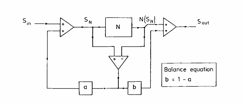

The attached is the canonical combination of error feedback and error feedforward.
Depending on whether a = 0 and b = 1 or b = 0 and a = 1, you get one or the other.
Anything in between, you get something, errr.. in between. N is the distorting part.
As long as you keep b = 1 - a for obvious reasons. This is by Malcolm Hawksford.

''but I would have expected for a feedforward to be implemented as a pre distortion to be applied somewhere between the class A amp output, and the dumpers.'' - well there you go!I do wonder if some of the terminology used is a bit confusing in its application to this circuit, I know what a bridge in the traditional sense is. And I observe that at least 2 places in the circuit where components can be "tuned" to make a distortion null, in alexcp's simulation, and my own simulation tweaking the bridges C and L for the glitch minimum. I am not quite so sure what feed forward is, but I would have expected for a feedforward to be implemented as a pre distortion to be applied somewhere between the class A amp output, and the dumpers. This would primarily correct for the crossover glitch resulting in less of a continuity disturbance. I don't see that in the circuit, just a resistor providing a little bit of drive across the dead zone.
Have enjoyed @alexcp simulation, I managed to get almost -400dB. Getting my brain to understand things is a bit like stirring cold treacle at the moment, but intrigued by the strong gain dependent null, and interested to look at the frequency sweep, will it all fall to pieces? the suspense.
I, rightly or wrongly, do not view it as ''Pre-distortion''. I view it as a short transients which appear where there are no fundamentals, which are shaped and fed back to the input of the Class A amplifier, where they are amplified; in the hypothetical case, by 30db and quickly force the CDs into conduction, away from the non linear zone. The faster that happens, the less the need for negative feedback. This does not exclude the use of conventional feedback, but the plots given earlier comparing Sugden to Quad, doesn't seem to suggest, there is much by way of conventional feed back? - certainly up to 1 watt output. Beyond however, it could be somewhat different.
In modern terms, all this could be achieved by a ''shadow digital circuit'', which could accurately determine when the dumpers should switch on and ensure that they did so. beyond their non linear region. All in all, this seems to be a means of ''Out of Band Control'', where products are being used to control the performance of the fundamentals. I don't know if any of this makes sense, but it appears to me that it is not a question of inhibiting distortion, but using the products, albeit at a very early onset, to arrest the production of products.
@jan.didden, jut to help my understanding, those, "opamps" are unity gain differential input.

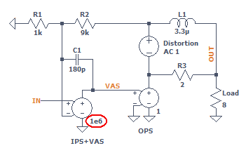

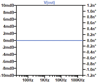

My sims in #41 above used ideal amplifiers with frequency-independent gain. It is a useful abstraction, but a realistic amplifier's gain falls with frequency. In a feedback amplifier (and any current dumping amplifier uses feedback!), this makes necessary some form of frequency compensation. Walker (as other designers of the era) used single slope, dominant pole compensation by a "Miller" capacitor:
With the capacitor, the loop gain is no longer a constant 100 (=40dB). It turns south at about 1kHz with the values shown (that's the pole), falls at 20dB/decade as frequency rises (that's single slope) and hits unity (zero dB) at about 100kHz:
As there is less feedback at higher frequencies, the distortion level at the output of the current dumper goes up starting at 1kHz:
The "pre-distortion" at the output of the Class A stage (=the input of the current dumper) is the sum (in dB) of the two graphs above and stays relatively constant as frequency changes, decreasing only when the amplifier runs out of loop gain:
To null the distortion at the load, one needs to add proportionally less, by 20dB/decade, of current dumper output or more of Class A output at higher frequencies. Walker made a frequency-dependent adder with an inductor and a resistor:

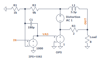

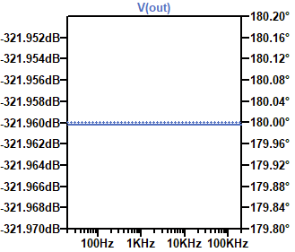

Nulling with an ideal (zero DCR) inductor of the value L=RRC (3.3μ≈2×9k×180p) works a little better than feedback alone, but nowhere near the theoretical zero - compare -40dB of compensation here with -322dB in post #41:
The reason, of course, is that my frequency-dependent summer doesn't work too well at frequencies below the pole, where the loop gain is constant.

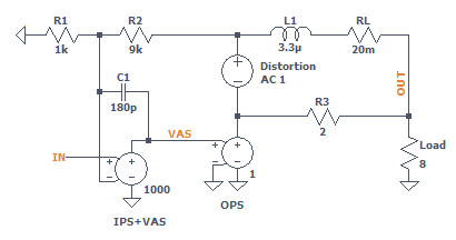

One way to improve nulling is to add an appropriate DC resistance (1/100 of R3, to account for the constant loop gain of 100 below the pole) to the inductor:
Walker solved this in a different way: by adding loop gain. With more loop gain, the pole is pushed to a lower frequency, and nulling is improved:
However, adding a few milliohms of DC resistance to the inductor ruins nulling again
No matter what you do, nulling is finicky. It is sensitive to component values, which have tolerances and change with temperature, humidity, age, and other factors. Feedback, on the other hand, is a much more robust solution.
Thanks Jan,Another way to view it is as follows.
