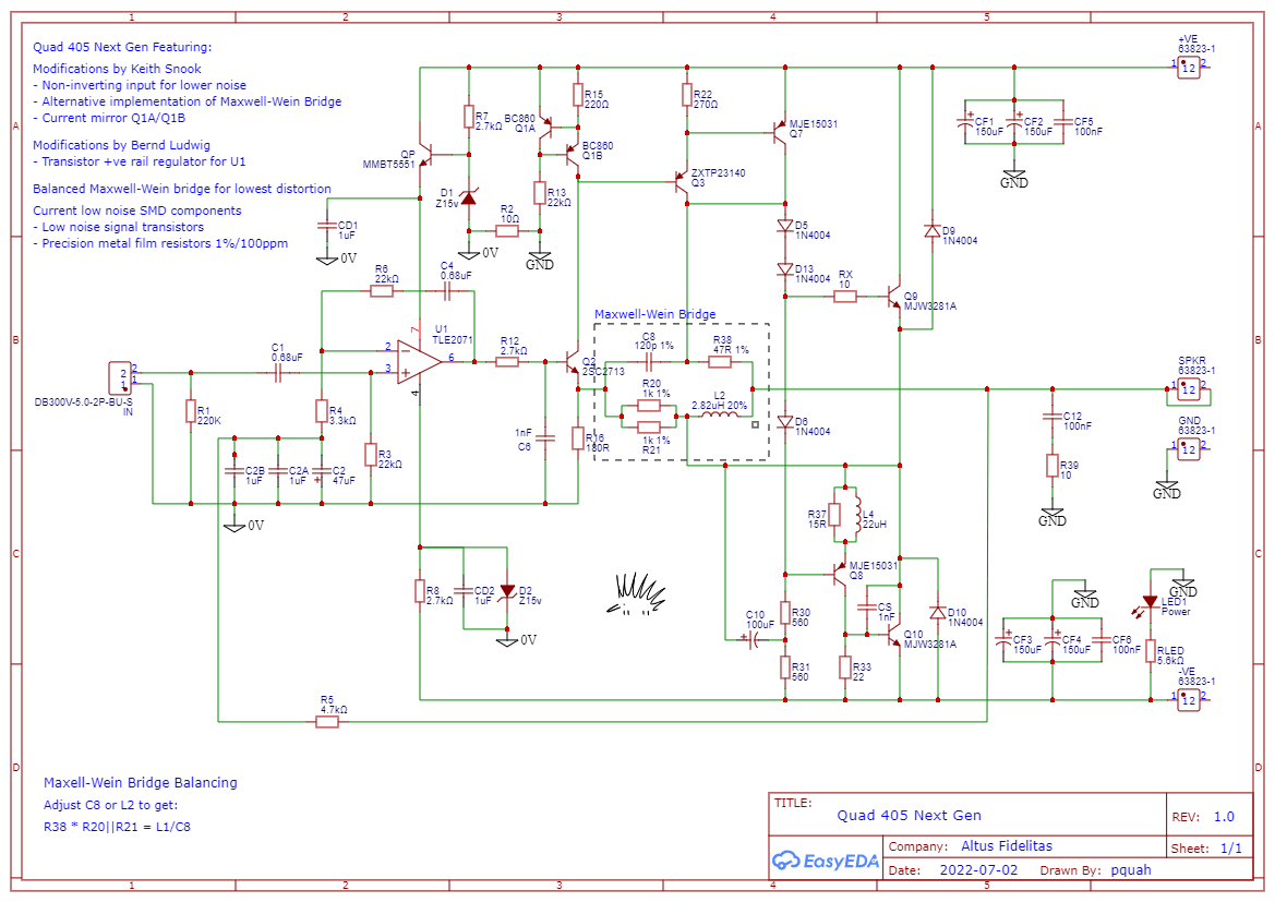

Here are a few notes about picking components and building my 405
- OpAmps. My original preference was for an OPA134. But due to the current chip shortage, none can be found. I am almost certain the ones offered on eBay/Aliexpress are fake. If building using PTH, use an IC socket and temporarily put in a TL071. More OPA134's are expected next year.
- Transistors. Q1A/B is not critical. Vce of at least 50v for Q2 and 80v for Q3. Q3 possibly needs to handle more current. I have not measured, but I chose an Ic of at least 1A and Vce of 100v for Q3. Any medium power TO220 will suffice for Q7/8. As big a transistor you can find for Q9/10, but be careful about Ft. Ft on the original transistors were sub 10Mhz. So anything over that, RF precautions apply, e.g, keeping leads and PCB traces short and power decoupling tight.
- Bridge. Balanced bridge (C8, R38, 20, 21 & L2) = low THD. Formula is R38 * R20||21 = L1/C8. It's easy to get 1% tolerances for resistors and capacitors, but inductors commonly have a 20% tolerance. I started with a 3uH inductor and unwound it till I got about 2.8uH. Low inductances are difficult to measure. Great if you have an LCR bridge, but I did not. I put a known 1% capacitor in parallel with L2 to form a tank circuit and measured its oscillation on a DSO to determine its inductance down to 1% accuracy.
- Passive component ratings. R30/31 form part of the class A amp and get very hot. Minimum 3W and keep it away from the board. 1W for R7, 8, 10, 22, 33, 37, 38, Rx and Rled. I used 1/2w for the rest, plus some 1/4w for front end signal. 10v Tantalum for C2. 1/2w for zeners D1/2. 1A is sufficient for L4.
- Others. I did not use Qp. Just short the PWR jumper.

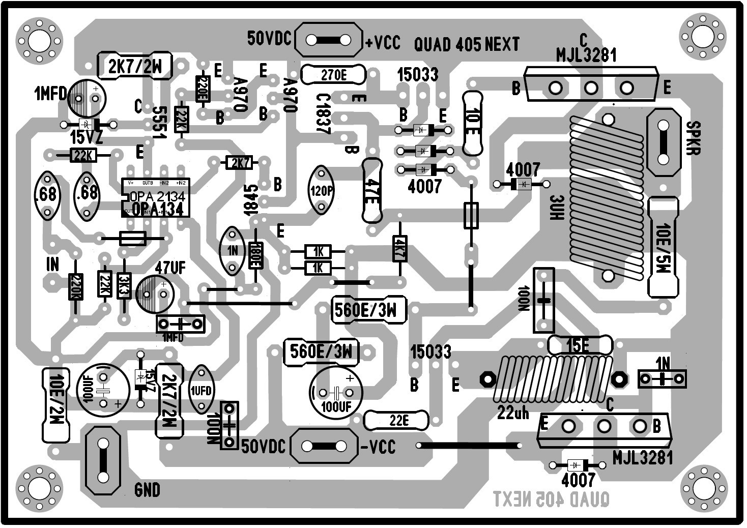

greetings please can you look at my pcb component
layout getting DC at the output
warm regards
You need to provide more details. DC output of 20mv is normal. How much DC are you getting? +/-?
I would check polarity of all components, transistor BCE's are in the right holes, diode polarity. Some transistors of the same type may have different pinouts with different suffixes, esp for TO92's. Then check all jumpers are in.
After that, start probing voltage from the source to output with 0v as the reference
- Voltage supply of op amp +/- 15v
- Input and inverting input of opamp should be 0v
- Output of opamp should be close a few mV
- Apart from Q1, All the transistors should be close to rail voltage for pins connected to the rail side and close to 0v for pins connected to the output side when no signal is present.

Yes, the +ve side of the MJE15033 and R30/31 form part of the class A side of the amp, so current is always flowing and they are always hot.Hello Altus
greetings sound is very sweet full of details only
positive side mje15033 driver transistor gets hot

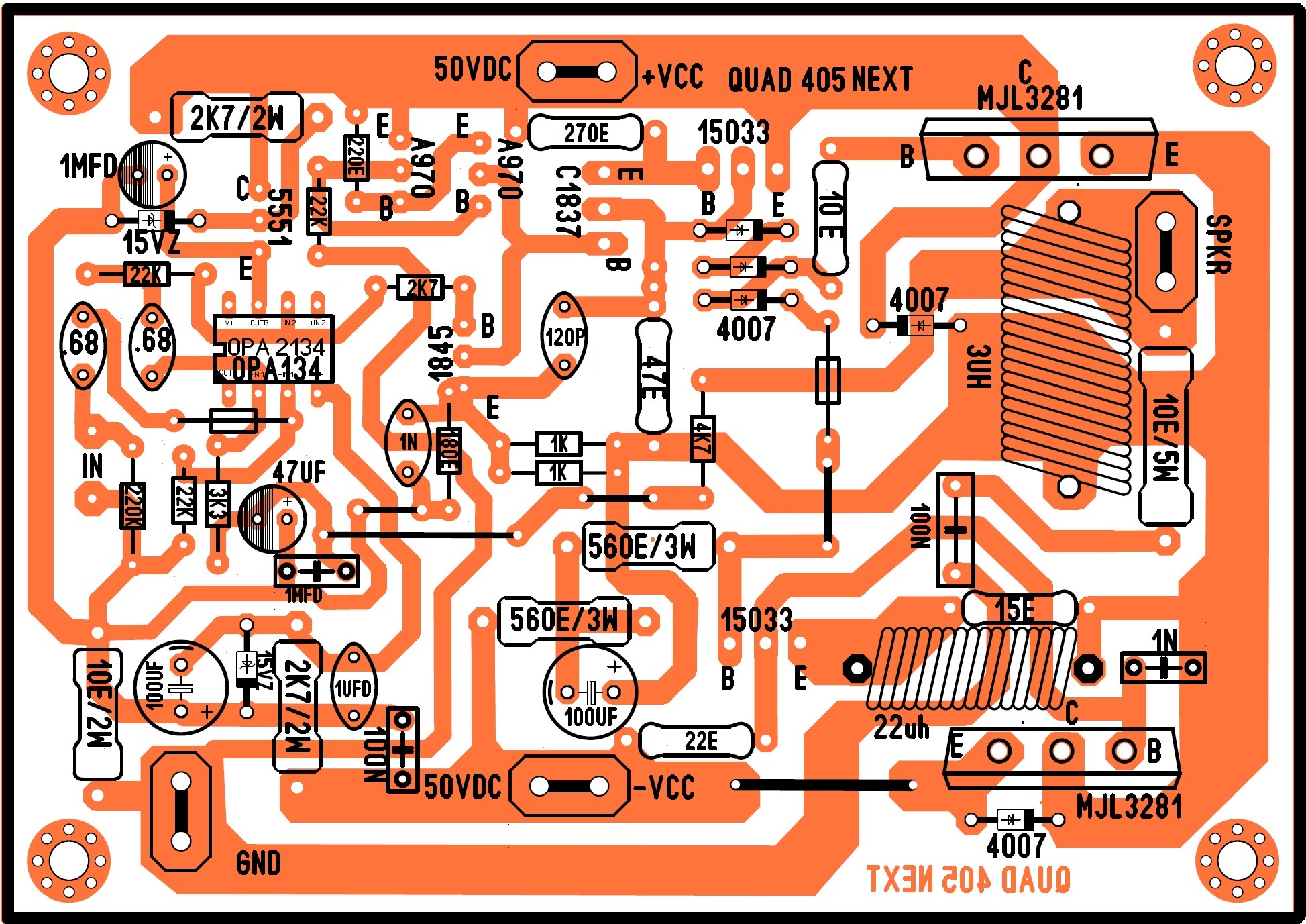

is that normal enclosed my final pcb layout
warm regards
Andrew
The negative side MJE15033 is the class C driver, so should stay cool with no load.
Also your C10 is too close to R30/31. Both resistors run at 60c or more above ambient temperatures. If you put in into a case, they will easily exceed 100c. C10, being an electrolytic, will have a short life.
If you do not want to change the layout of the board, just solder c10 on the opposite side of the PCB

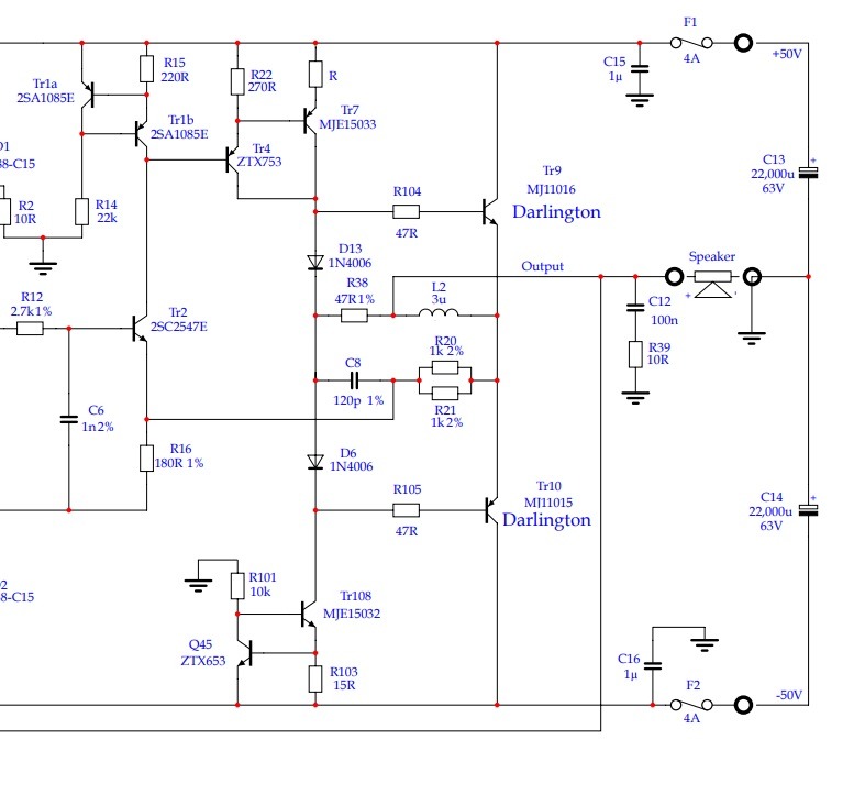

this statement is not true, if you look at the transient characteristics in the load, then the output impedance of the 405th firstly depends on the frequency, and secondly, it is different for the positive and negative half-waves. at a supply voltage of +/- 50 volts, I do not recommend connecting speakers with an impedance of less than 8 ohms. it is also desirable to use exactly thespeakers with maximum linear impedance to minimize the capacitive nature of the load, which greatly affects the feedback.The 405 is a very pleasant amp. I suspect it has a high damping factor as well, so produces a nice accurate bass, especially for larger and multi driver speakers that are difficult to drive.
To increase the damping of acoustic systems in the load, QUAD engineers paralleled the transistors of the output stage in the later versions of the 606/707/909.
I think the scheme for any needs further refinement despite the subjective positive reviews.greetings please can you look at my pcb component
C8 seems to be in the bridge, but in fact it turns out to be connected between two low-resistance points of the circuit, on the one hand it is the collector Q7 limited by resistor R38, on the other hand, the input impedance is low from the R36 emitter.
due to the addition of D6, the direct current through the inductance L2 and the driver transistor Q8 was increased, which is why the R34L4 circuit was introduced to limit the current through it, although it would be more logical to install a Baksandall diode, and it is even more logical not to increase the current through this transistor and install medium power transistor, which significantly reduces the base area and significantly increases the speed of this transistor - its work is important precisely on the transient characteristics.
Q2 has lost its power current limit, which requires an additional heatsink for cooling, and its non-linearity has also increased due to the increased influence of miller input capacitance.
