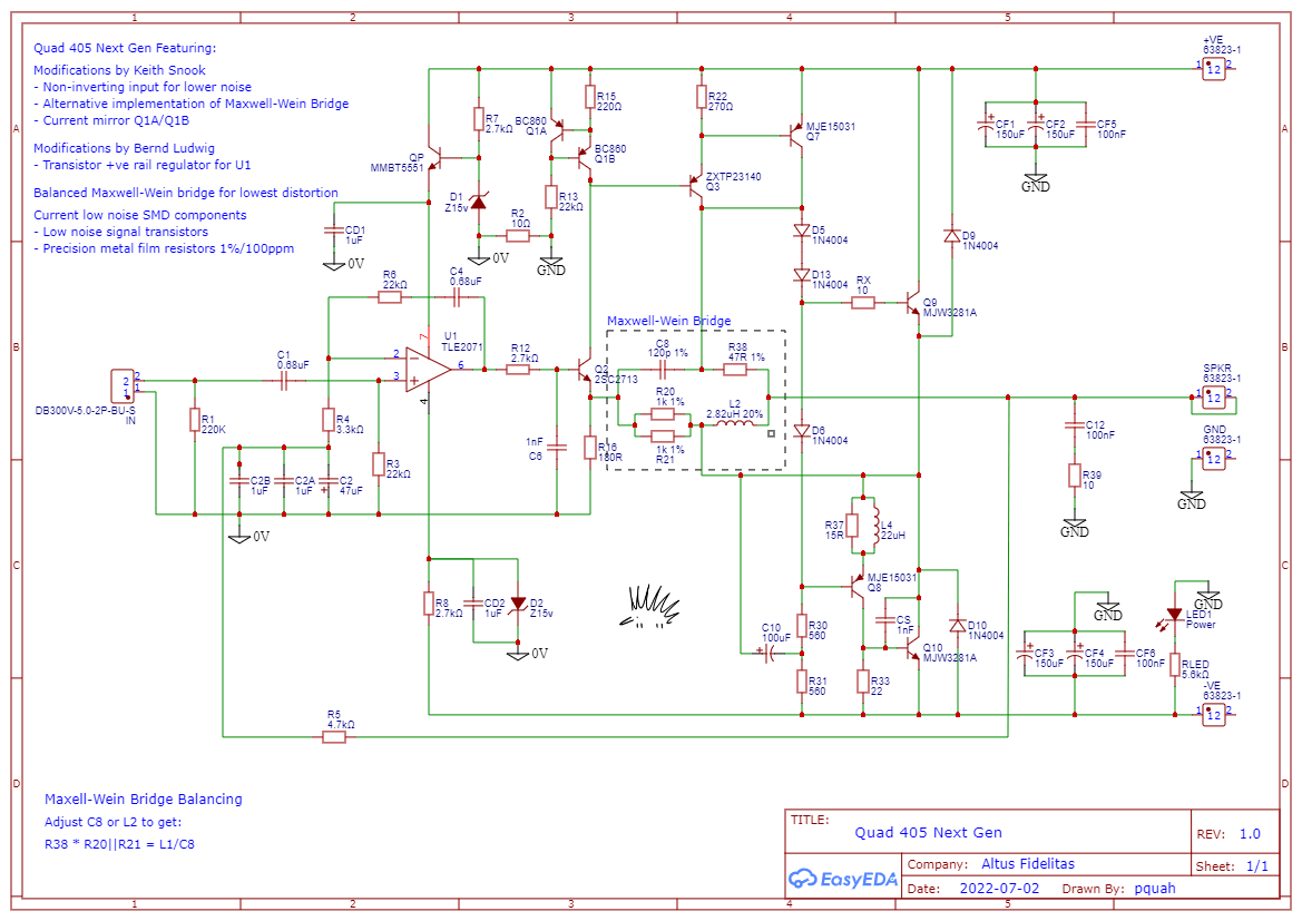

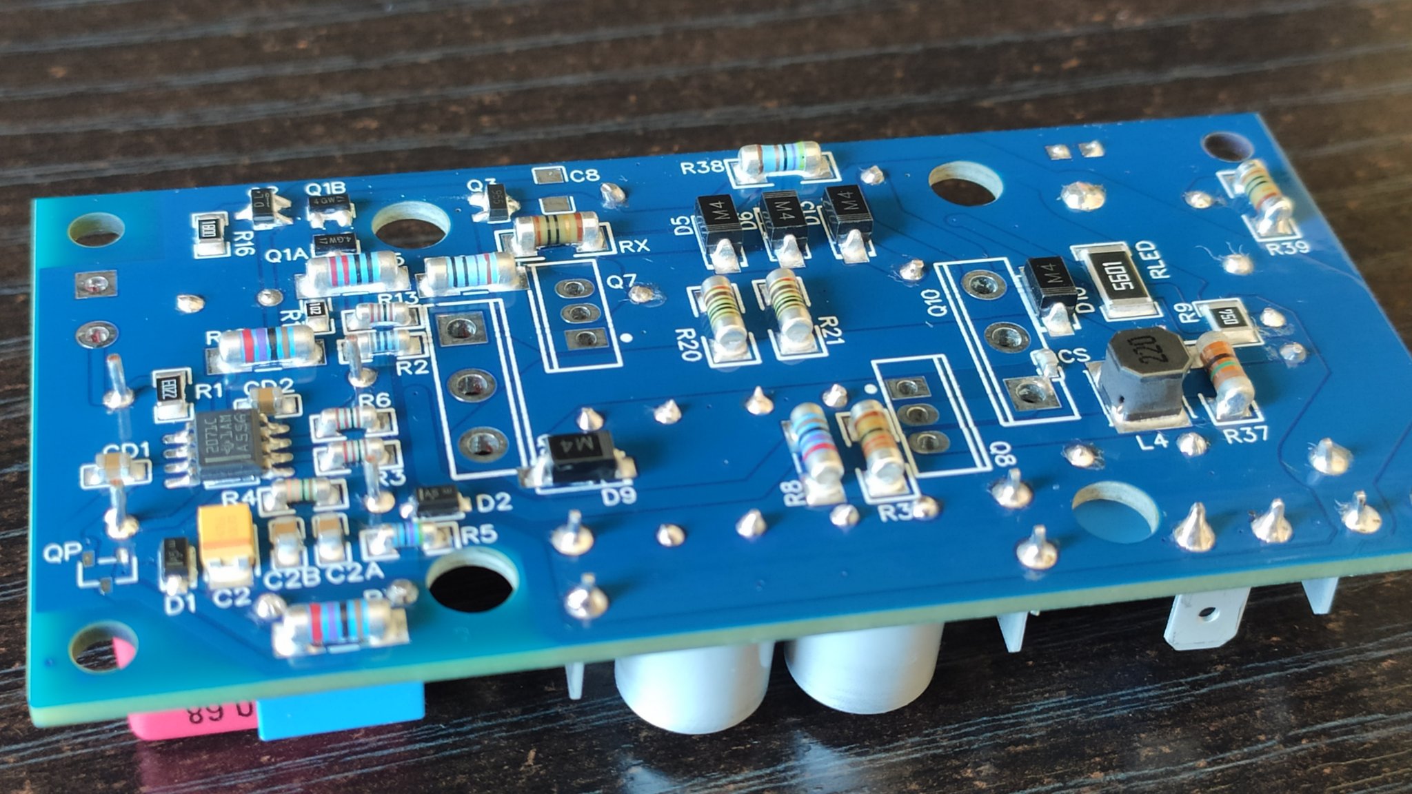

After navigating delays from work, parts shortages and missed orders, I've finally completed the Next Gen 405. Have listened to it and happy with the sound. Plenty of power to drive an authoritative bass while maintaining a rich class A character.
I calibrated the L2 inductor by using a pulse, recorded the ringing on an oscilloscope and reading the frequency. Low inductance coils are notoriously difficult to measure, and I did not have access to a proper LCR meter. The Maxwell-Wein bridge should be balanced to at least a 5% tolerance.
Next thing to do is to get a low noise ADC to do some distortion and response testing on it.

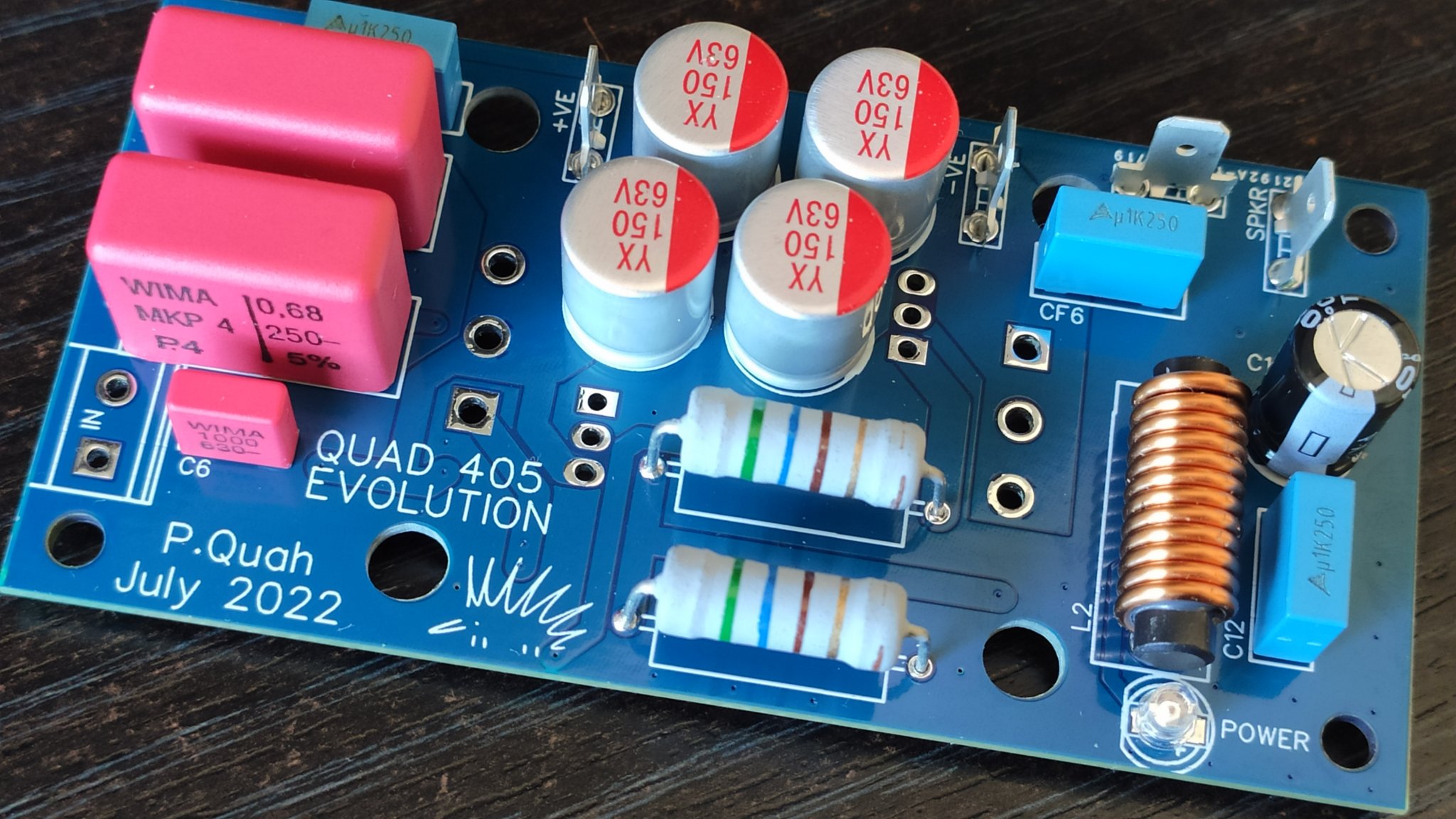

Top side of the board containing all the through hole components. As much clearance as possible for the very hot 3W R30 and R31. Four low ESR 150uf polymer capacitors right next to the output transistors to ensure sufficient current to drive transients. Also polymer capacitors don't dry out like normal electrolytics.

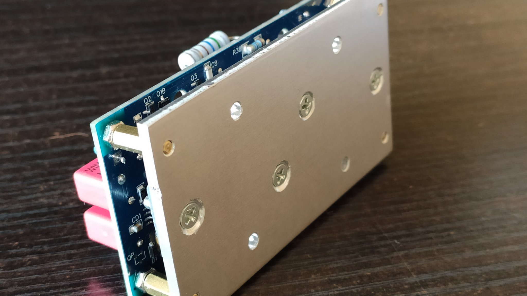

Bottom side - all the SMD's and the input front end. With SMD, traces can be kept very short to reduce EMI pickup, plus ground plane on other side of the board to keep things quiet.

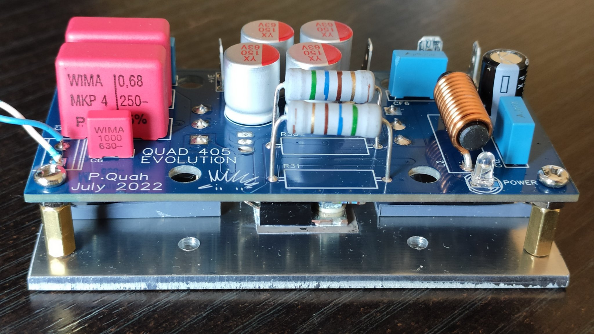

Completed amp with power transistors mounted on the undersize on the heatsink bracket

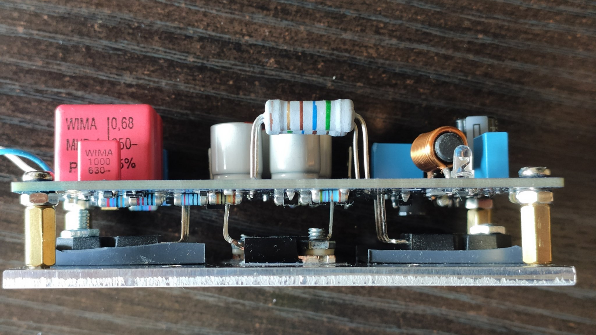

Side view on how things fit
Heatsink bracket has similar mounting dimensions as the original Quad 405, so potentially a drop-in replacement, but more compact.
Are you willing to share gerber files. I love your design, beautiful and compact.
Two remarks:
1. I never dared to use a TLE2071 in a QUAD-405 because it has a bug that makes its supply current increase a lot when it clips to the negative rail. It was a QUAD-405 with the original Zener diode supply for both op-amp rails.
2. Using an op-amp with FET input, you can easily redesign the DC loop such that you don't need an electrolytic capacitor in the DC feedback anymore, see https://www.diyaudio.com/community/threads/redesigning-quad-405-dc-bias-loops.339643/ Mooly's simulation results in that thread are with an incorrect resistor value.

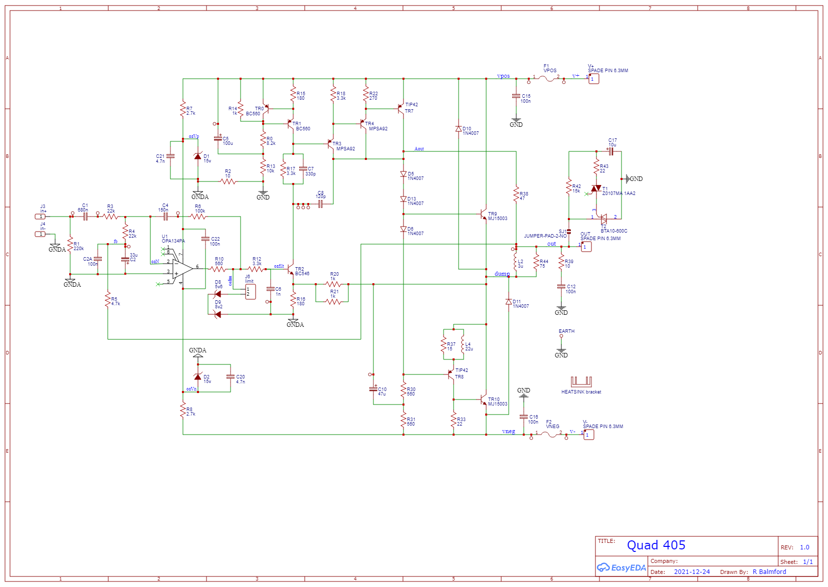

greetings what is the DC supply rails for #8 schematic is the schematic final as i hav most parts i would
like to build it.
warm regards
Andrew
I had the same concern about the TLE2071 as well, but I guessed that was going to be a rare and momentary event. I figured that a lower supply resistor, 2.7k vs 3.3k on the original, plus a 1uf decoupling capacitor would suffice, just to provide enough current for that split second and keep everything stable.Two remarks:
But just in case the resistor/zener arrangement was not up to the job, I also included traces on the PCB for an active transistor power supply. Fortunately, that was not needed.
During testing, I took the amp to 80w on an 8ohm dummy load. I scoped a few points on the amp and did not remember the output of the op-amp coming close to the rails.
My preference was for an OPA134, which seemed to have fewer issues, but my choice has been limited by the current chip shortage.
Also, thanks for pointing me to the alternative DC loop design. Will read that up.

greetings Please can you explain 120 pf has the red dots is it
to be connected if there are oscillatons ad the function of the
jumper switch connecting the two zener diodes in series.
Is it possible to post a BOM of the wattage of resistors used
warm regards
Andrew
warm regards
Andrew
If you mean C8, it is part of the circuit and must always be connected. The switch for the Zeners switches the voltage limiter in or out. You only need it in if you are driving Quad ESL-57s.

Hello Altus
greetings many thanks for replying now i am following
your schematic which i have attached.
It will be a DIY effort single sided pcb with the available
components
1 ic OPA134
2 Small signal transistors A970/C2240
3 Can ZXTP23140 be substituted with C1837
rest all components exactly per schematic for the
inductors i have attached pictures can they be used
Please guide me if i am wrong
