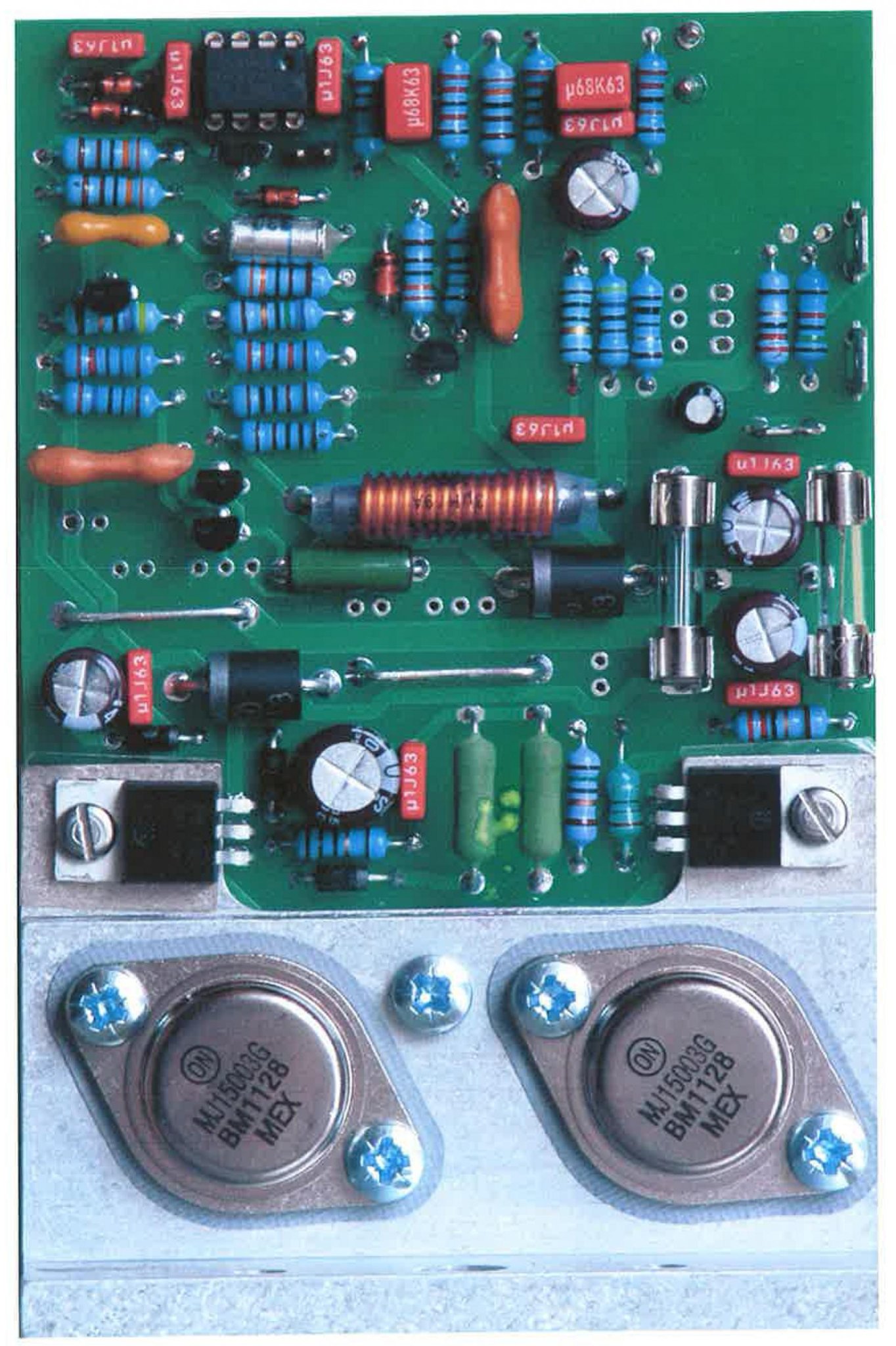

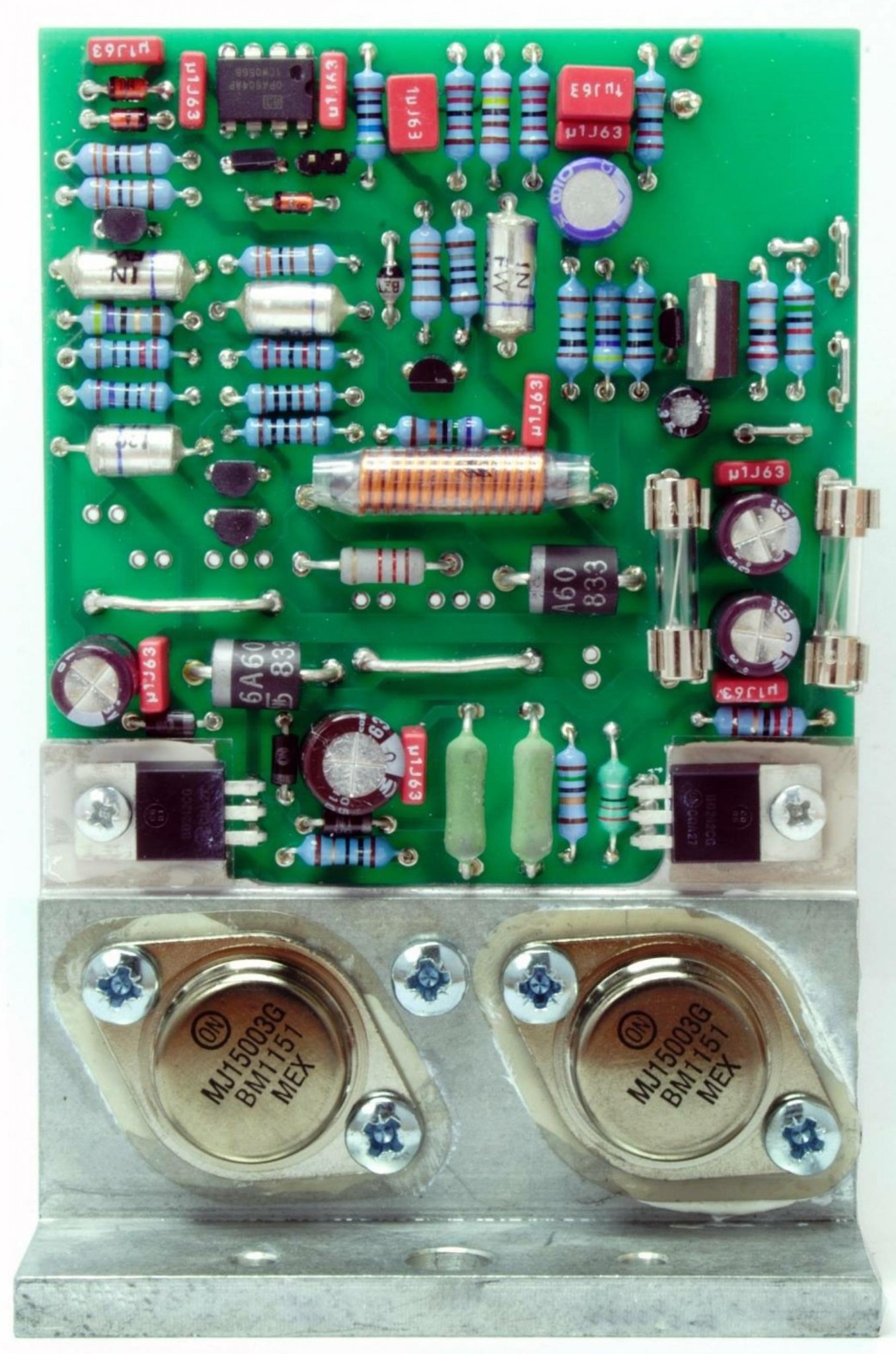

I don't have the two main sizes to measure here (of whats available on the internet). I think one is 126x90.3 and the other which is a direct copy of the DaDa high end boards is 120x83 which is likely the original Quad 405 dimensions as the DaDa boards are a physical straight swap for the OEM boards. I have a few of the DaDa copy boards but they are 500 miles from here!
The 126x90.3 ones will be the same as the plethora of LJM copies that come with the black anodised heat sinks. I built a few of those some years ago and measured the passive components, they were all within the stated tolerances. I binned the transistors as I had a lot of spare bonafide components back then and did not want to take the risk. I had not owned an original Quad 405 for over 15 years then so could not have said they would have fitted, I doubt it. The thing is why would anyone with a working Quad 405 want to fit Chinese copy boards unless they were the copies of the Dada boards that are faithful to the recognised tried and tested mods that originated with Ludwigs work and evolved through Snook and De Smith?
The DaDa copy boards are definitely the ones to own, there are no grounding errors built in and zero need to break tracks or solder components on the rear, "higly sought Class A dynamic biasing 80W amplifier PCB" (sic), LJM uses the worst possible translation software.

DaDa board.
Only C8 on the copy is a 1% Polystyrene cap.

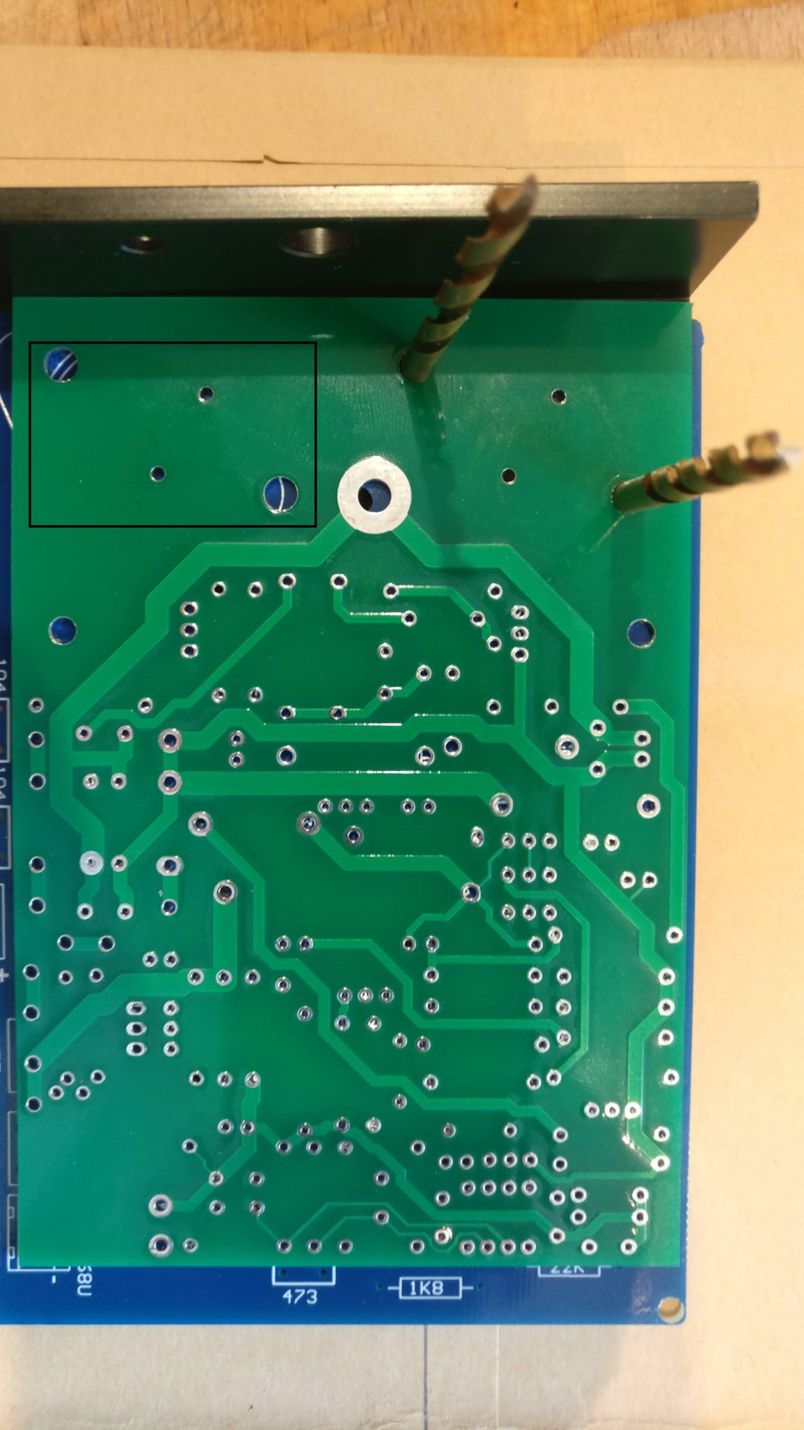

I have indeed found a sleeve of PCB's here and not in England. An image of the difference in size between the extremely common Chinese copies of the early model and the DaDa board that is a physical straight swap. Green is obviously the DaDa, blue the common LJM clone.
I have highlighted the discrepancy of the power transistor spacing, the black heatsink is the one that comes with the common LJM clones and as you can see there are no holes visible on the left side of the image.
