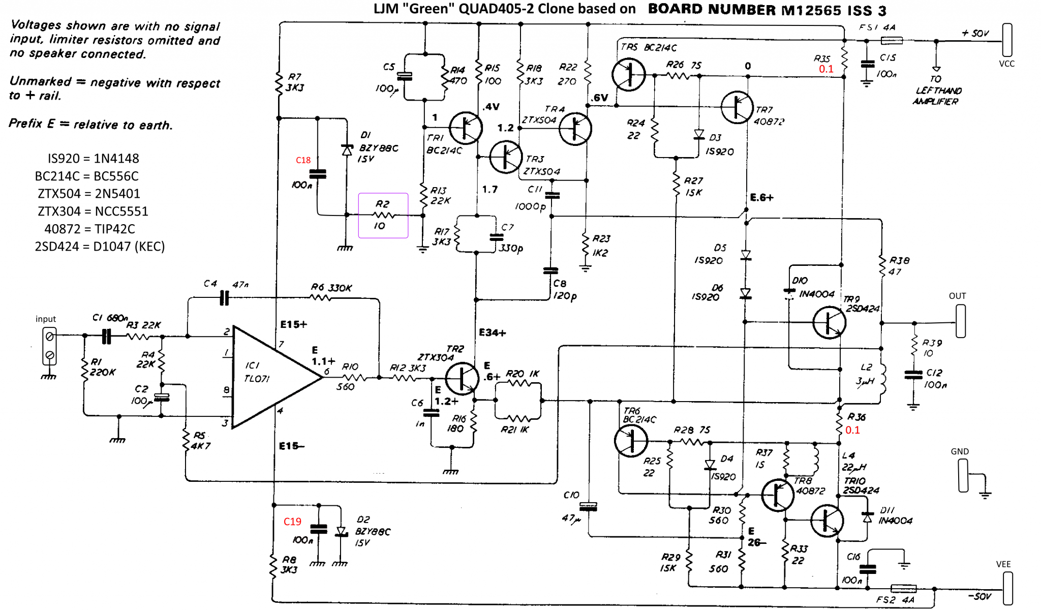

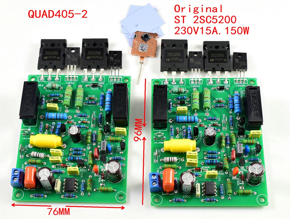

Hi, i have these clone boards based on board 12565 issue3, would it be good to use MJE15031G and MJL3281A or may i have oscilation issues?
Good morning,
I just installed 2 Quad 405-2 clones boards in my #405 housing (one of the original board being defective, that was cheaper than reparing it) so powered under +/- 50 VDC. I have only changed the 560 ohm resitors by 5 W ones, and replaced the TL031 by OPA627. Result is excellent, <60 mV offset, no oscillation, it sounds better than the original #405 (which was >40 years old with chemical capacitors changed 10 years ago).

opa627 are very good so you will hear a different kind of sound rather than any improvements, the 627 is a little dark sounding. If you want improvemnts switch to burson or some other discrete op amp, there are a lot of posts out there about this so read up and decide what you want to do. You will need to reduce the 3.3kohm resistors before the opamp

Not all Quad 405 clone boards are same. I bought one sometime ago but it came with different mounting holes and wouldn't fit into my original 405 chassis.

I have 6 PCB left over from builds for myself and a relative, they are direct copies of a PCB commisioned by a company based in Antwerp, Belgium. I have most of the components to populate the boards apart from the opamps, I used OPA627 in the original builds but they are no longer available in DIP package. I am loathe to use SOIC>DIP adaptors but if needs be I will. The absurdly expensive OPA627BM I would not consider on cost. I used OPA604 originally but after trying an OPA627 in one channel and 604 in the other I prefer the 627, subjective experience only of course.

Sometimes measurements can be misleading or open to interpretation. For the money you pay, the quad boards are excellent value, give good sound quality, are reliable with a long life, and can be modded up. You are getting a good deal. If you don't like the sound try something different, there's a ton of boards out there and a ton of free advice as well.
