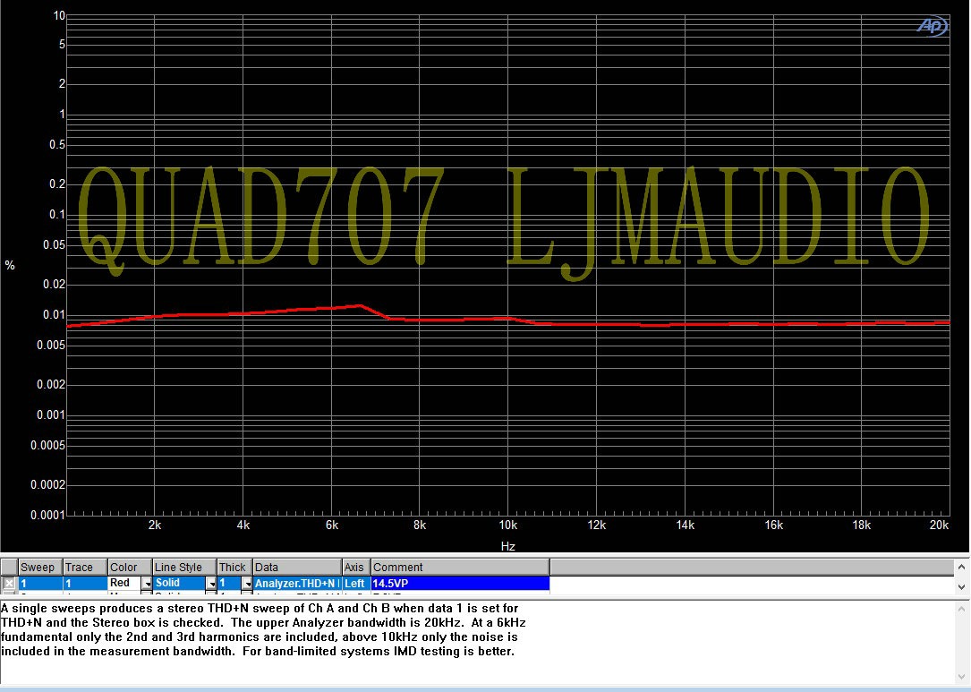

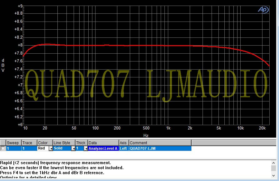

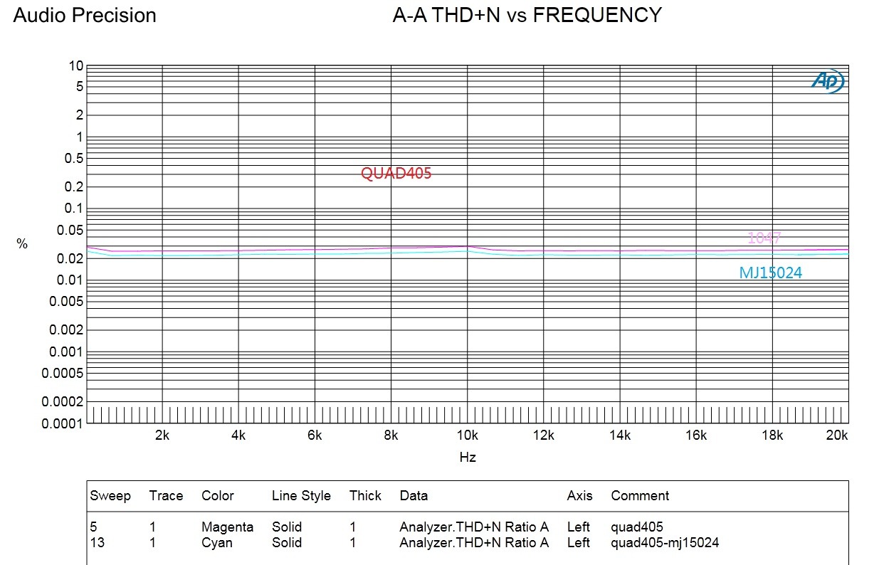

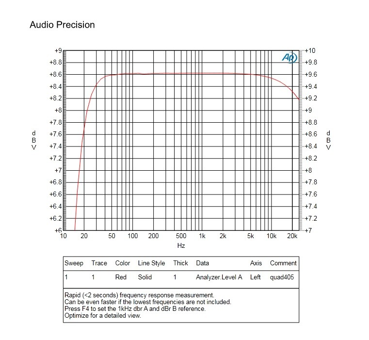

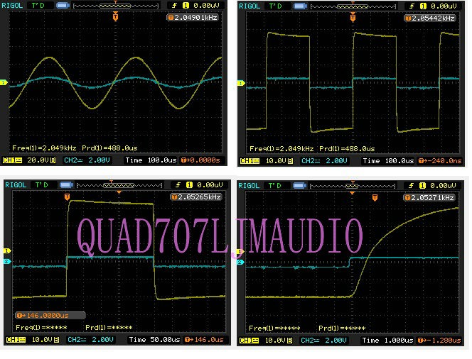

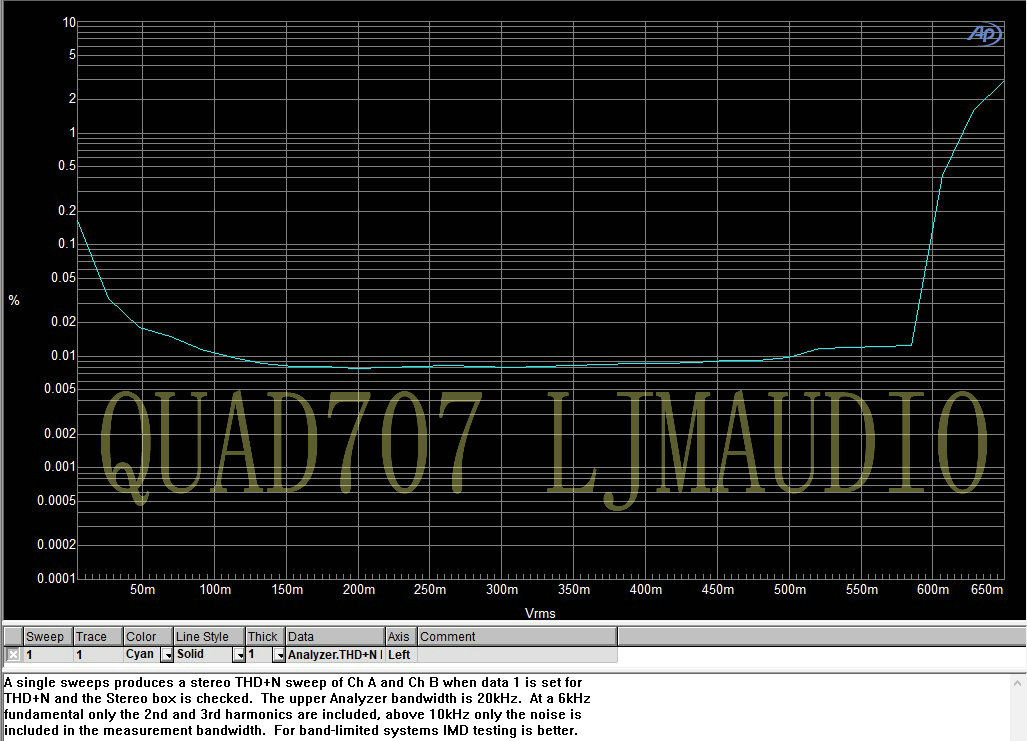

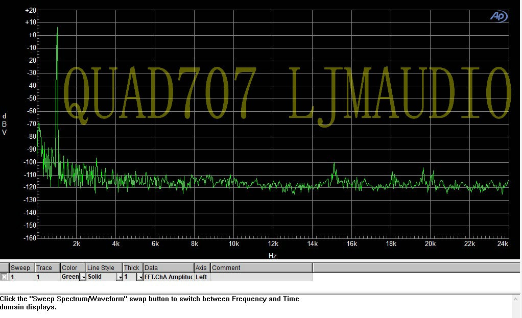

I compared and measured QUAD405 with QUAD707No it isn't. It is a class A amplifier driving a class C amplifier.
I don't know why you single out the 707. It isn't materially different from the 606 or 909.
Their performance varies greatly.
QUAD 405 SR 4V/US. QUAD707 SR 25V/US
QUAD 707 Better bass. Better midrange. Better treble.

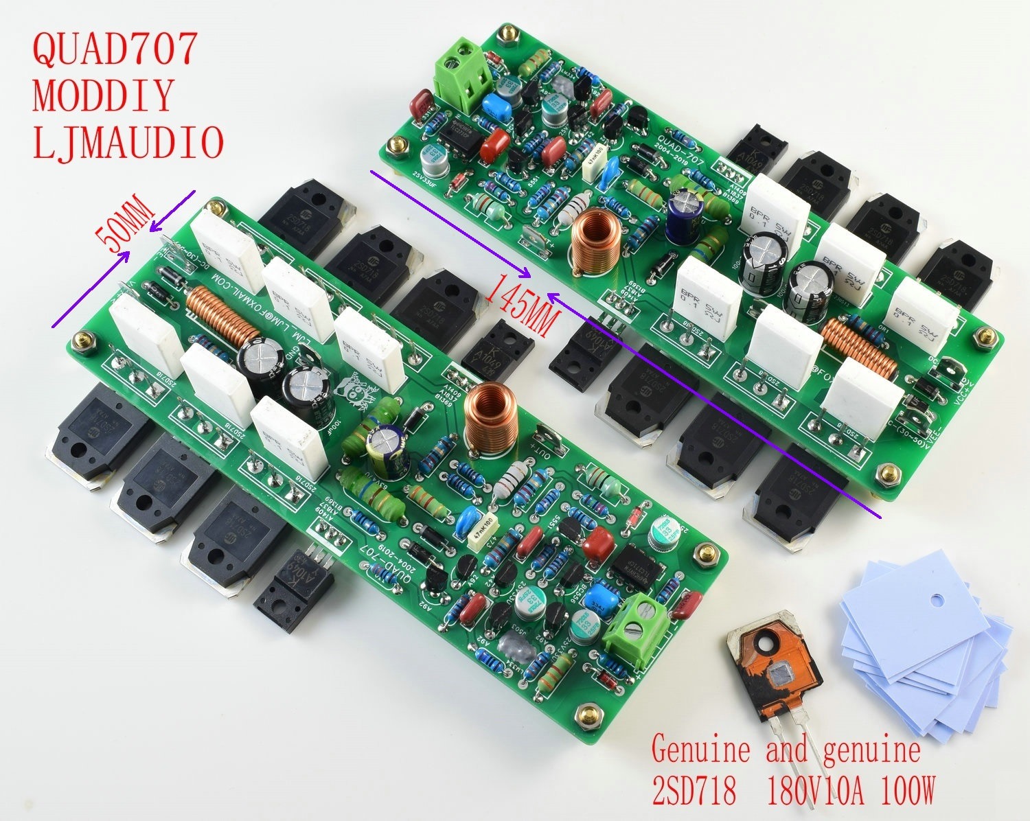

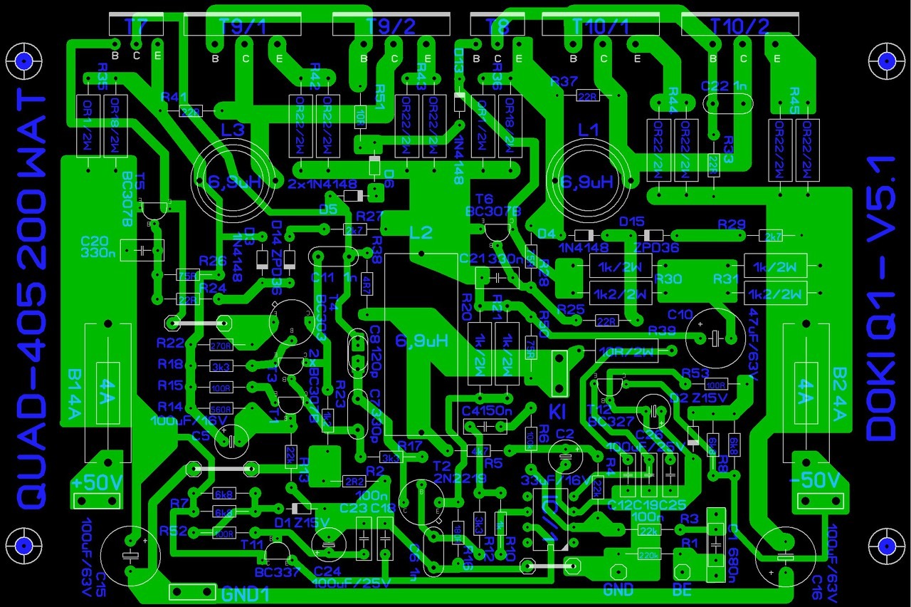

PS: Also changed R30/31 560R 2W for 3W and 1cm above the surface of the board as they get hotIf looking for a reasonable low cost replacement there are the LJM QUAD405-2 with the 2SC5200 and TL071. Make sure your search includes the "-2" and the "2SC5200". That is the version I would buy if I was to buy new boards again. I would also replace the op-amp (later, after successfully installing and testing the stock board) with OPA134. I also have a habit now of replacing the power transistors on all such boards with genuine Toshiba 2SC5200 purchased from Mouser or Digikey (ONLY a real authorized distributor).
Hi, i just acquired 2 boards you mention, i tested first for some days, then i changed C1 as for factory it came with 1uF and did the mod opa134 and 1.5V input sensivity. 100nf across c5 and across C2. and 100uF 63V across C15/16, and thats it, works very good connected to a Quad44 at the 1.5V output Before i changed C1 the sound was not pleasant, the output transistors look legit, or at least they work fine.

That isn't a kit as far as I can tell. That looks like a real QUAD405-2. (Based upon the surface mount current limiter module and the green transistors. (And the appearance of a number of other parts and the PCB.)
So are you looking to replace these boards, repair them, restore them, refurbish them or?
If you want to restore those boards there are others who might be better sources of information. (I have clones, I have never bought an original QUAD405.)

The transistors are fake, have seen a few youtube videos
Agreed. It also has more electrolytic capacitors a than a real 405-2. It seems to be some clone , ancient enough to have attracted the attention of Quad's patent lawyers.
I´ve done most of the mods but failed to achieve the d13 one, i dont know what i made wrong but when i switch on the transformer makes a hum, puting back to original the hum is gone, i dont know if i need to change anything else before as it has the protection circuits from 12565 issue 3
The 2 watt 0.5 ohm resistors at the top of the board, do i have to use current sensing resistors to replace these.
They are current sensing resistors, by function. That's not a resistor type. Why do you think you need to replace them?

Are the current sensing resistors worth upping from 2watts to 5 watts power handling
Not sure if they are underrated, but there are more 2 watt resistors next to the current sensing resistors, which are 560ohms and everyone else is changing these for 5 watts and raising them up from the circuit board.
