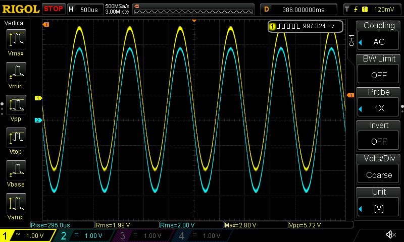

The 2V nominal output level of a CD player at 0dBFS is an RMS voltage. The peak of the waveform is 2.82V and the total peak to peak is double that.
Nominal 2V output Marantz professional player- Denon 38C39-7147 test disc 997Hz@0dBFS.

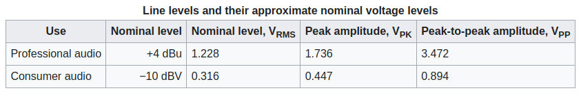

Yes CD players are capable of 0DbFS with Test CD's which I have said on many occasions , ,CD' media what we enjoy as music though which you omit to mention , is 6.32 times less level being a nominal level of 0.316V RMS Peak as ,0.447V RMS and Peak to Peak as 0.894V RMS
https://en.wikipedia.org/wiki/Line_level
Consumer Line Level to clarify above is RMS 0.316V then derived as , Voltage Peak VP at 0.447V and Voltage Peak to Peak VPP at 0.894V
