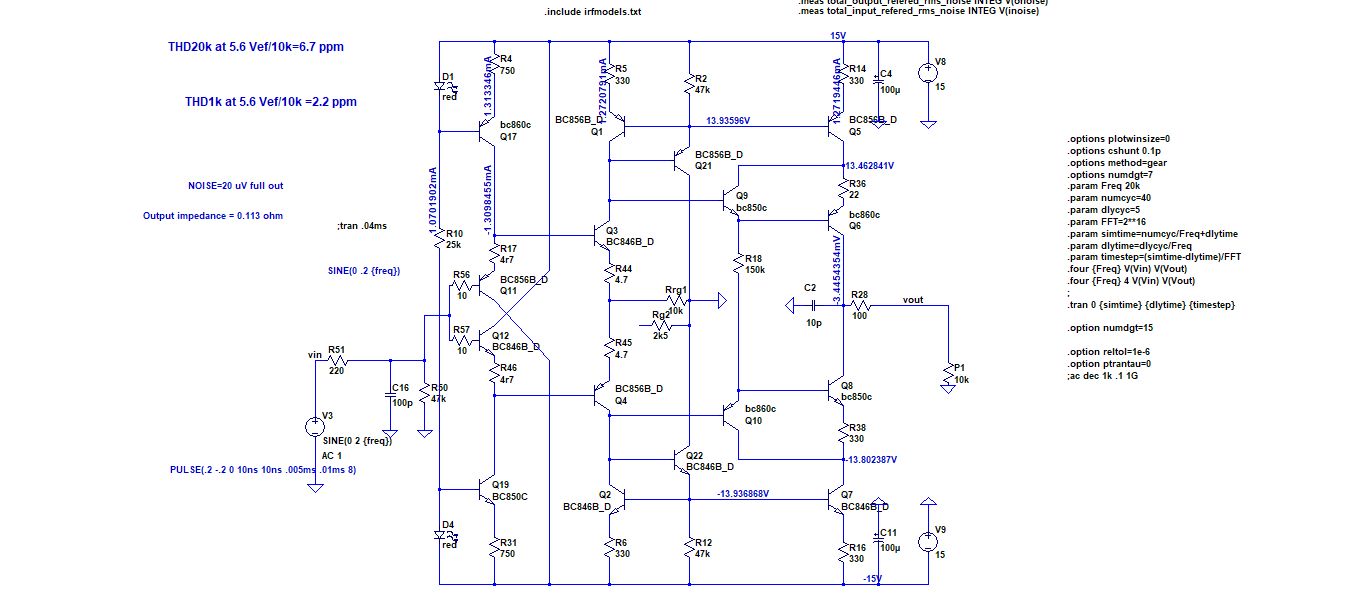

My assumption when designing a multi input source preamp is
Legacy inputs like old tuners, tape decks etc: 200mV
Modern digital sources like DACs and CD players: 1V
So the preamp line stage is set for 14 dB gain, and the modern 1V input sources are attenuated at the input connector by -14 dB. This gives 1V for all sources at the preamp output.
There is a spread in the source voltage figures I quoted above: some modern digital sources quote 1.6 to 2 V output (quite a few CD players over the years) while seen I’ve legacy sources quoted at 120mV (old tuners for example) all the way up to 350mV.
For phono preamps, I design for 35-40 dB for 5 mV input and that feeds into the 14 dB line stage.
With the gain structure mentioned, the volume control will easily cater for a 6 dB spread in input levels without requiring it to be too far off the nominal setting which on a log taper pot will usually be between say 10 o’clock and 2 o’clock on the volume dial. Amplifier rated full output for rated input levels is with the volume control at maximum.
I find it a bit strange that modern digital gear is coming out with 3 and 4 volt output levels.
Ultimately, the volume control on your preamp sets the final preamp output level and no source signal should be clipping at the preamp output level.
On legacy gear like the Quad being discussed here, c. 350mV input sensitivity was the norm, so the aforementioned gain structure would not have the +14 dB line amp - the gain would just be 0 dB.
In this specific case, I would not fiddle with the power amp gain - you could run into stability issues if you try to reduce it by a large amount which is clearly what would be required. I would suggest a circa 10:1 attenuator using a 10k and a 1k divider, the output of which feeds into the volume control. If the volume control is 10 k of better, the loading on the divider will be minimal, but you could always tweak it by reducing the upper 10k divider resistor to say 8.2k or 7.5k.

With resistive divider you lose some SNR as the preamp will have the same gain for low input signal as for high.From what I’ve heard, digital attenuation always reduces resolution - resistive dividers do not.
YMMV

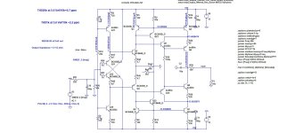

I use non GNFB current conveyor in my preamps with two set of gain, high and low with the same SNR.
I am not sure I explained it clearly.🙁
Something like this. Gain P1/Rg1 or lower with Rg1 parallel with Rg2.
