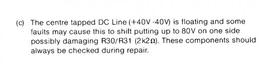

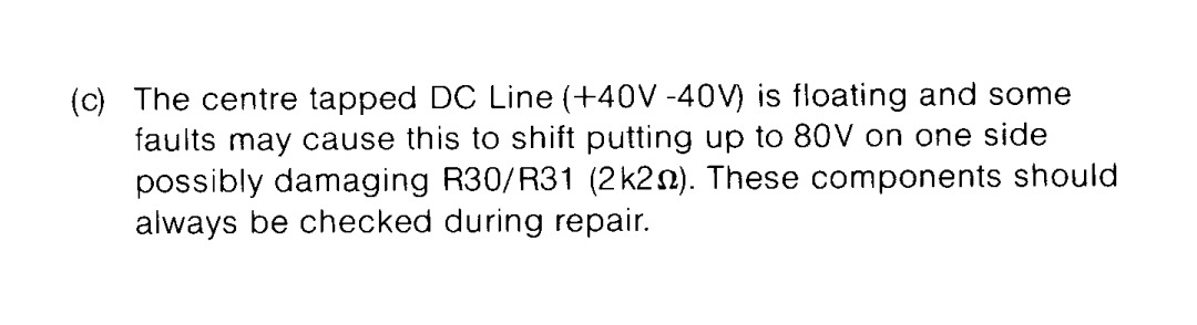

Batteryman, I am no electronics expert and as you have seen in the previous comments there are some strong opinions about doing it, how its a waste of money. My understanding is that it's to clamp down the zero voltage. Please see the attached snippet from Quad 306 service manual, page 10. Now read this in conjuction with the comments from LesW in the attached photos.
My guess is that positive and negative rails are working much better in conjuction with zero voltage, which in return is keeping the temperatures under control. All I can assure is that it works fine and nothing blows up by putting diodes there.
I have absolutely no clue, why. Could be that as the power transistors are dealing with less of the voltage swings they run cooler. Or it could be that as I have changed almost everything, it's helping to run more efficiently. Cleaner and more stable powersupply equating to much more efficient operation. I am afraid to take these out now to double check as they were pain to solder in with the insulators.
