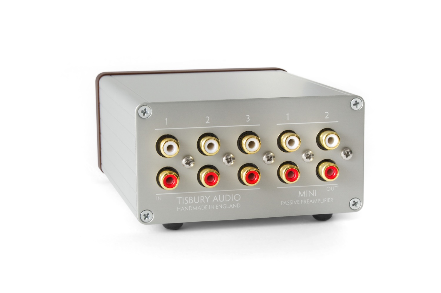

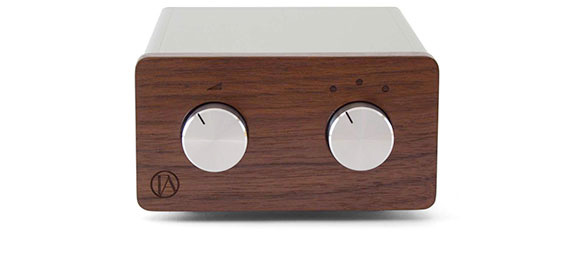

Our passive is a TISBURY Mini Passive Pre II. It's a nice, affordable little English product that is superbly backed by its maker. As you will see below, it also offers two levels of fixed attenuation in addition to a stepped attenuator.
I really don't know if this unit "...caters for adjustable shunt resistance and has no adverse loading to the source component impedance..." That said, it does sound very good - and the additional output jacks allow us to drive our preferred headphone amplifier also!

Easiest is to use it with a passive volume control (attenuator), ideally that caters for adjustable shunt resistance and has no adverse loading to the source component impedance, but you will have to look around for that, which is well worth it and where your time should be.

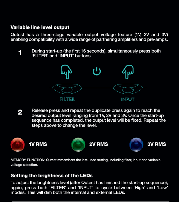

Our DAC is a CHORD Qutest, from England.
I have had a few exchanges with the designer - Rob Watts - and he has confirmed that the unattenuated output of the Qutest design is 3V.
The user-selectable options of 2V and 1V are both achieved via attenuation within the Qutest itself - in the digital domain - which in Rob's viewpoint, is sonically invisible.
I understand that the three different Voltage Output options are there to provide different strengths of signal, to help better match a variety of preamp or power amp sensitivities.
These three different Voltage Output options have proven invaluable with the various different amps we run at home.
We run the Qutest with an advanced bespoke SMPS that also powers our RUPERT NEVE RNHP Headphone amp, courtesy of a mate who is very much at the leading edge of audio design. I can take no technical credit, aside from having made the effort to try his SMPS design against other PSUs... Needless to say, it's killer! 😊

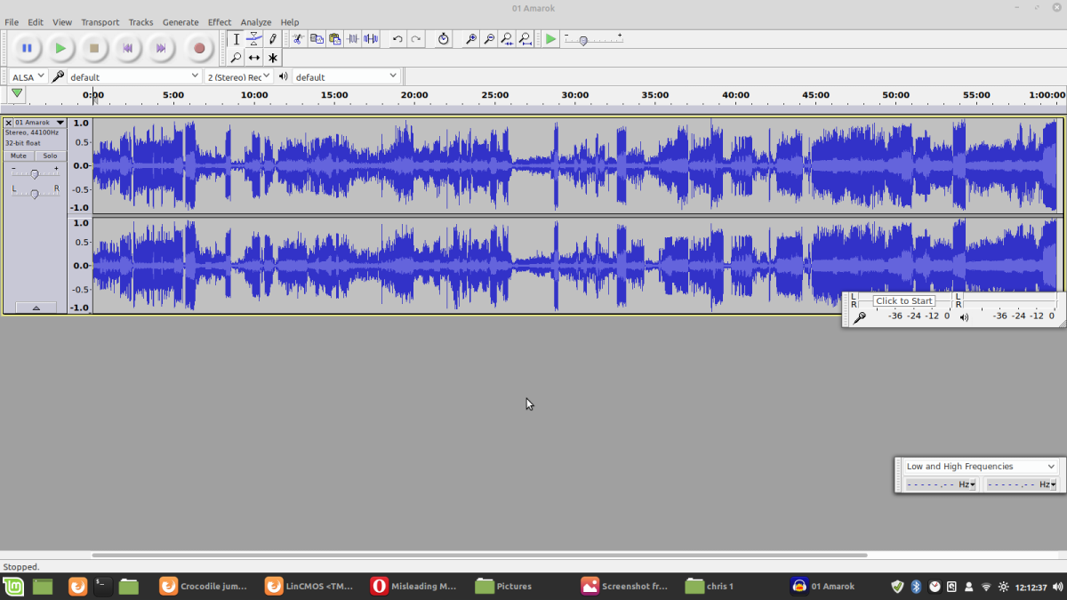

Which the media never provides as level, unless you habit and ignore the warnings of 0DbFS on your Test CD, over breakfast !! , i think its more so a manufacturer sadly pandering for no proper reason, to a certain other forum where consumer line level is never understood.

No it won't because the media contains the level, not the equipment, All you are doing is providing headroom, like a bigger road for your mini that never goes faster to drive on. If the equipment is raising voltage it just risks distortion from doing so. I think you will find the manufacturer is selecting slightly different current capability, giving you the impression of change. Test each so called level with a distortion analyzer, or at the least Audacity, where you can see Peak and RMS level, to confirm, what it claims to be doing. Compare what you see in Audacity to my earlier graph, which is Mike Oldfields Amarok, ie play the same CD via your DACPerhaps...

No it won't because the media contains the level, not the equipment...

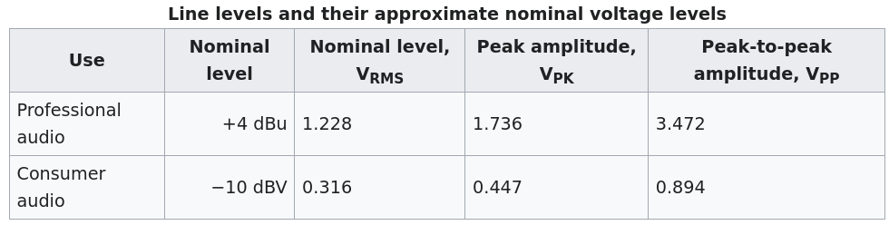

A Quad 306 needs .375v for 50watts.
So it matters not what the dac output is, you still have to attenuate it with your passive preamp.
the only question is whether you are happy with the reduced travel of the pot needed. But your preamp also has switchable attenuators, so -10db will require about 1.2v for full output.
Chris is correct when he referred to the media level because you cannot be certain that any recording uses the full dynamic range, so in practice the 3v output may never reach 3v rms.
Most recording engineers will keep well below the max possible level to ensure no peaks can stary into digital clipping.

No they are not opposing views, as maximum level embedded in the CD as consumer line level remains the same. You are just allowing for the very unlikely playing of a Test CD 0DbFS CD, which no one should ever play with audio equipment - fine with a scope though You would see a warning like this : " This CD contains tones at frequencies and levels that can easily destroy expensive loudspeakers/tweeters and/or amplifiers "Two opposing views.

There may be though instead of voltage some current buffering enabling lowering of the source impedance, You might be ascertaining that as level change. All fine up until distortion is added by the device, which needs to be checked. Your passive will be sensitive to source component output impedance changes. But much less so where the shunt resistance is adjustable, allowed by the series resistance being extremely high at lowest volume.
https://en.wikipedia.org/wiki/Line_level
