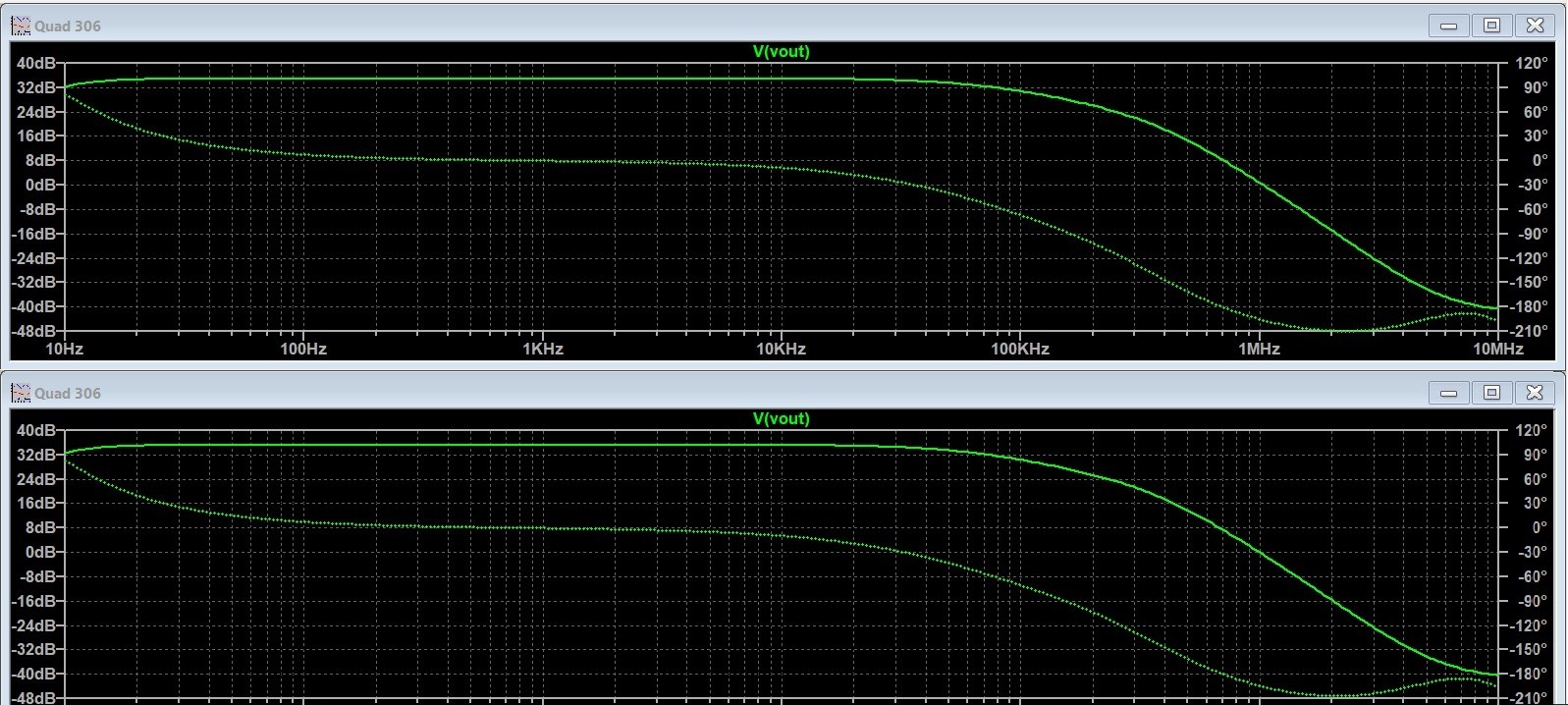

The additional 10k in the simulation seems to do very little (surprisingly). It marginally worsens the distortion but only by a miniscule amount.

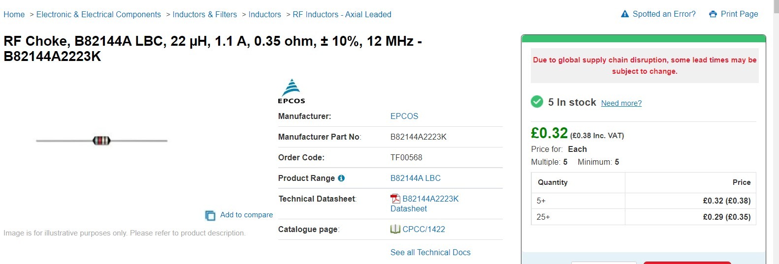

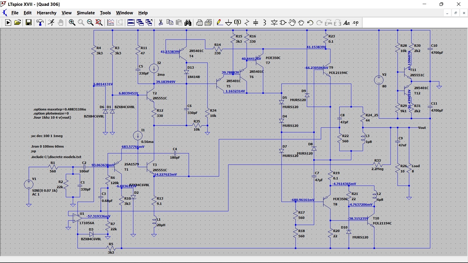

22uH from CPC. Let me have a play with the sim and see what sort of effect that coil has on things.
https://cpc.farnell.com/epcos/b82144a2223k/inductor-axial-22uh/dp/TF00568

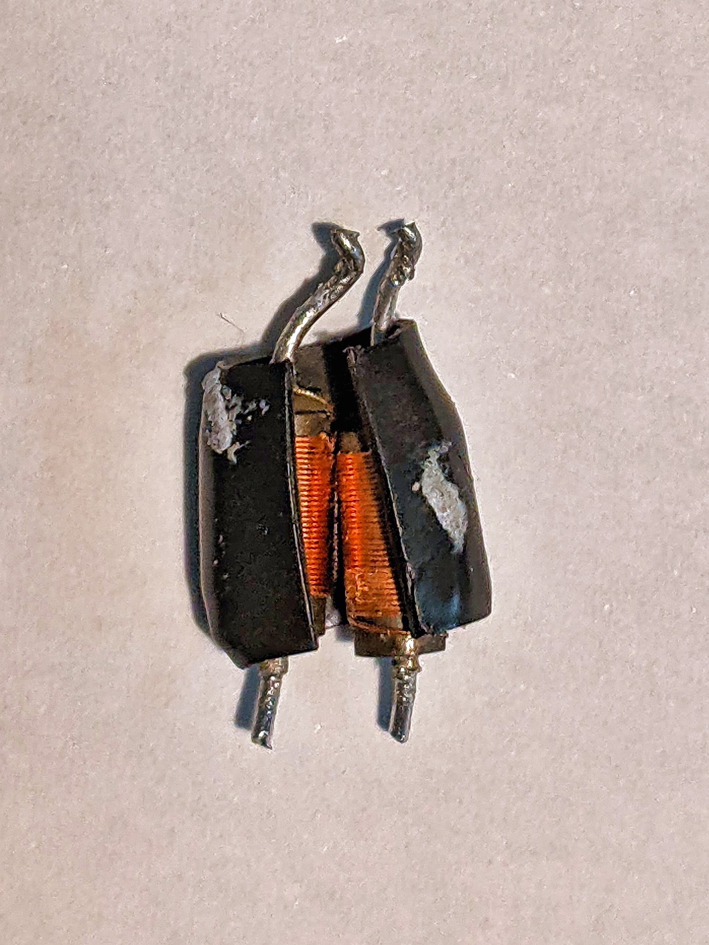

I just cut the heat shrink that holds the inductor together, and it fell apart. It was only twisted together at the top. The solder holding it together must have failed.
It's now soldered together with some more heat shrink over the top, with no DC offset flickering on either channel when I tap the inductors 🙂

Wonderful 🙂 It's been a good one has this 😉
Something like the inductor could so easily have temporarily 'worked' once swapped over. Amazing.

All those look good, DC conditions all correct. This shows the working voltages in the sim for comparison.
