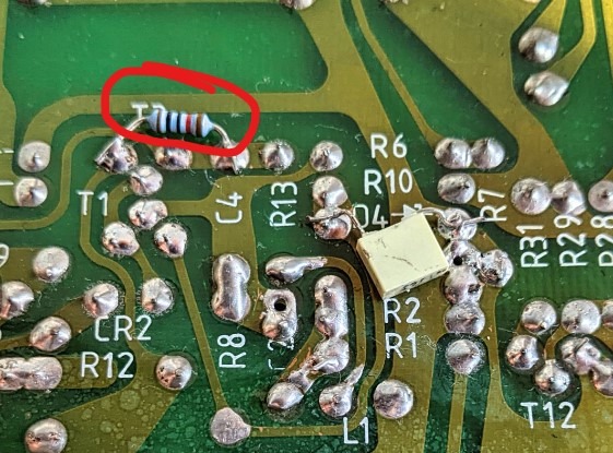

The resistor is a Dada mod, but I can't find the details. It's on both channels, but there are no problems on the right channel. You can see it here - http://quadrevisionspot.blogspot.com/2008/02/quad-306-upgrade-service-diy-kit-launch.html

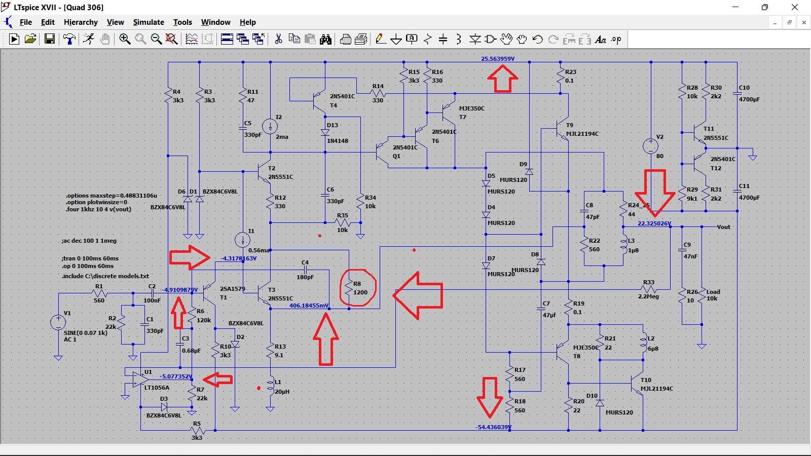

When trying to work out where to measure the voltages, I couldn't find R8 on your simulation:

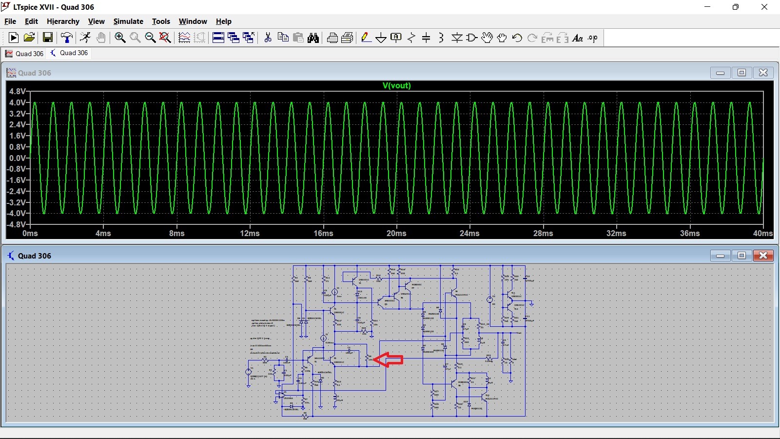

R8 on the sim was me adding the resistor I could see in your pictures. As soon as that was added the circuit gives the same fault condition as you are now describing.When trying to work out where to measure the voltages, I couldn't find R8 on your simulation:
It sounds like a lot is going on with this amp modification wise and that really makes it all a bit of an unknown. It would be worth you going back over everything you have done as well and perhaps even reverse everything back to original as a starting point. Check every single thing you have altered and changed.
I'm also going to suggest you lift one end of that resistor and see what happens to the voltages.

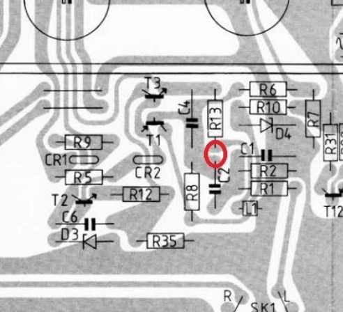

Sorry, I didn't explain very well. In post #23 there's a picture of the back of the circuit board with R8 circled in red. The R8 you added to your simulation was the Dada mod.R8 on the sim was me adding the resistor I could see in your pictures. As soon as that was added the circuit gives the same fault condition as you are now describing.
