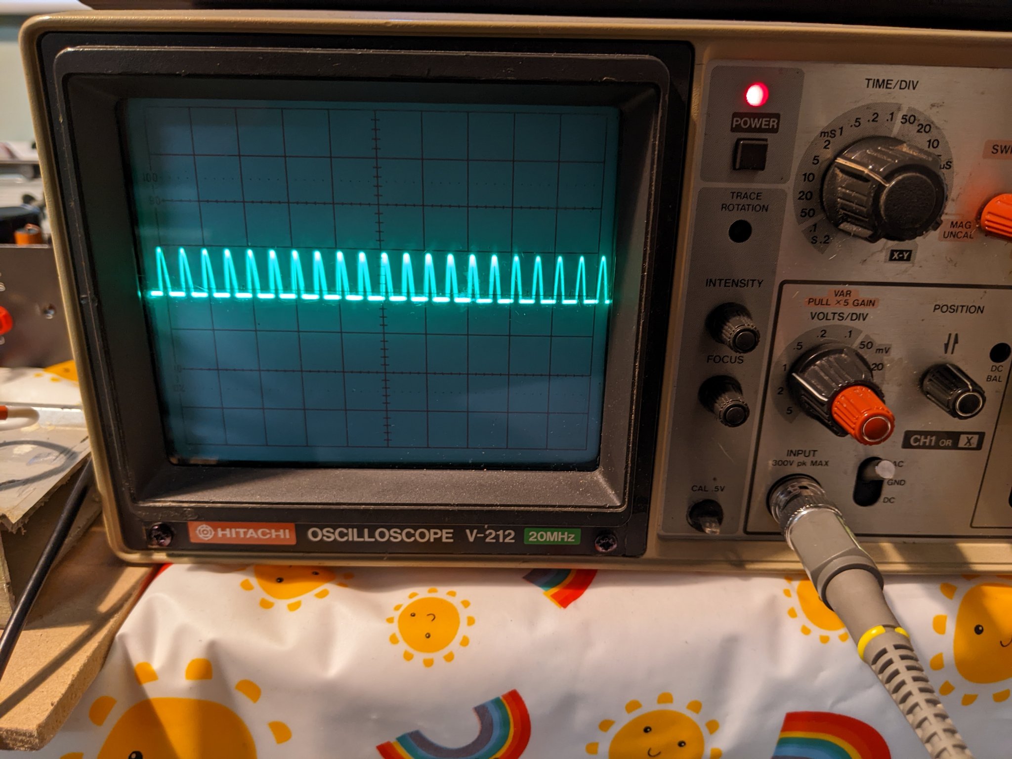

Yes. Using just one channel of the scope and with no load attached look at the waveform on each end of that coil in the bridge (L3). You should see the same signal at each end, nice and clean like the output.
Now connect the load and confirm the fault is still present and repeat the check. Is there a big difference in how the signal looks between each end of the coil? Is there a lot more signal on one end than the other?
The signal doesn't appear to change regardless of which end I put the probe (load or no load).
No load:
Load:

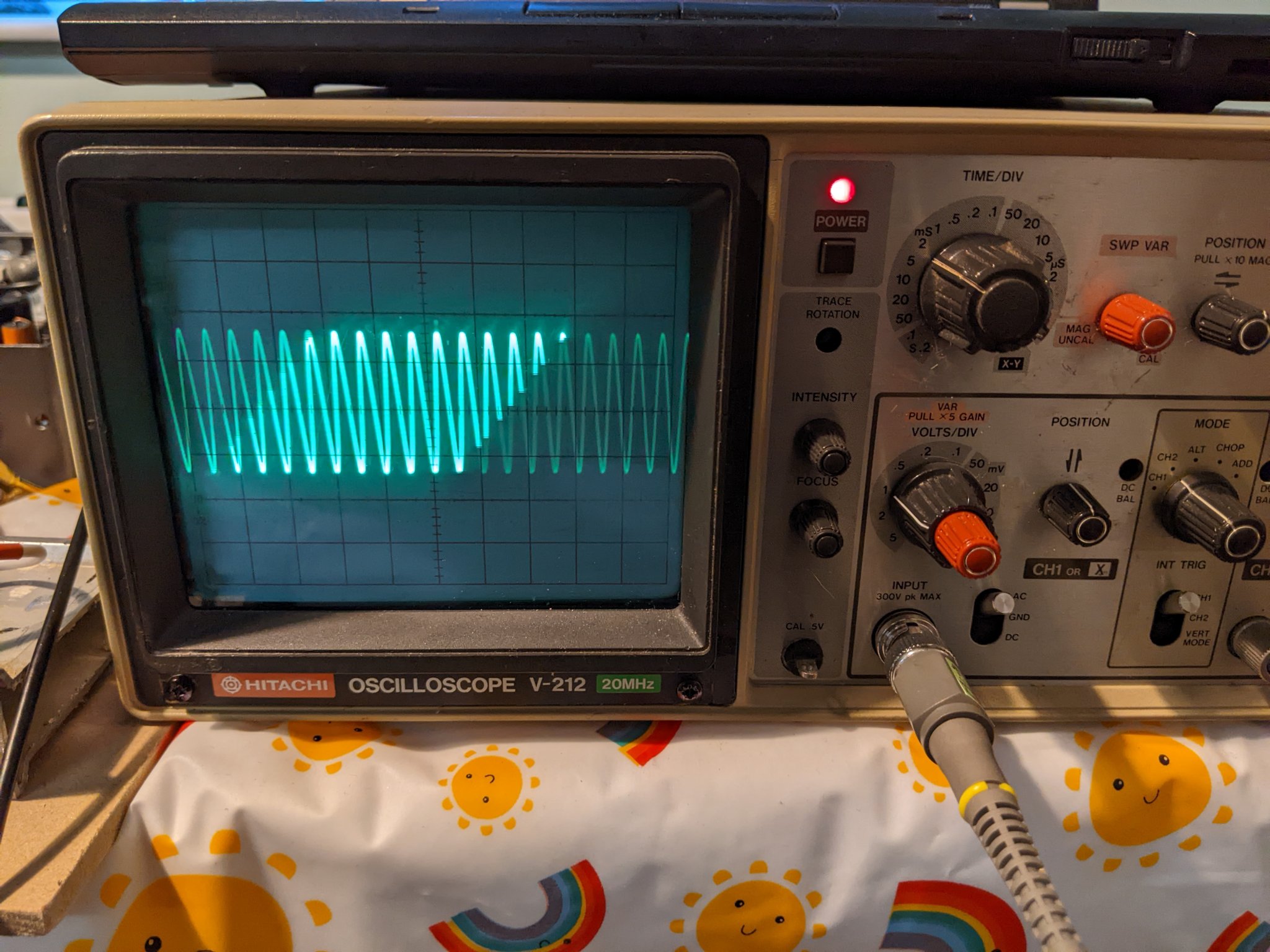

No, they are not the same. The no-load signal isn't clipped. The loaded signal is. This bears out the T8/T10 theory.
NB There is no point in looking at ten or more cycles at once. Change the horizontal so you can only see one or two cycles.
Yes, the loaded signal is clipped. Both sides of the coil measure the same, regardless of load.No, they are not the same. The no-load signal isn't clipped. The loaded signal is. This bears out the T8/T10 theory.

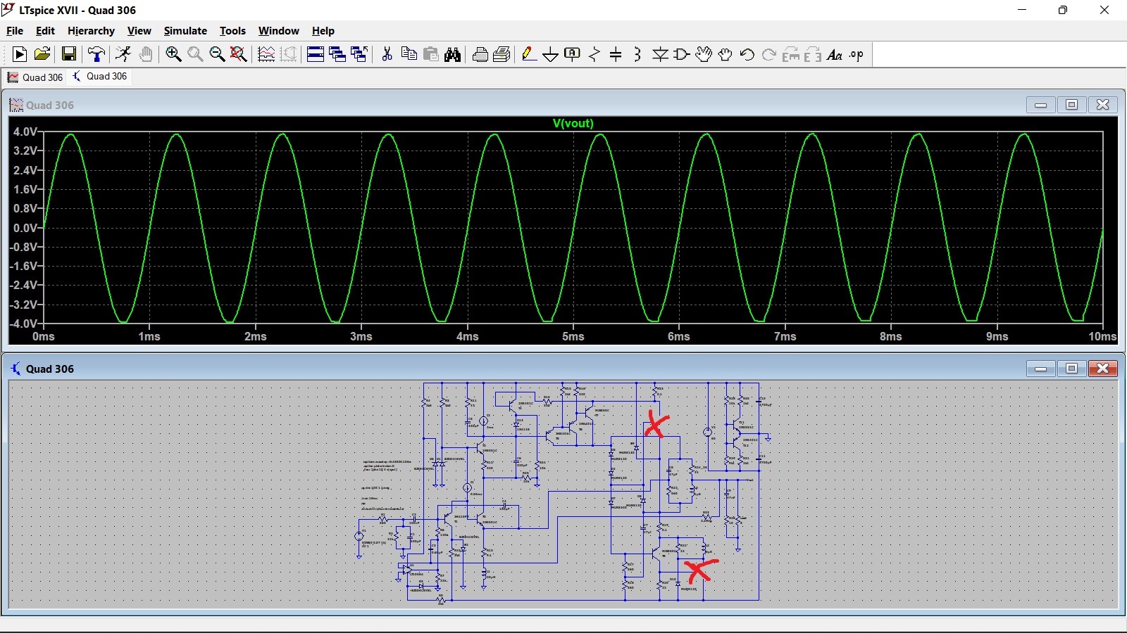

I was playing with the sim and a high resistance coil actually came fairly close to the fault symptoms and has massively different signals on each end of the coil as the bridge tries to correct a non correctable error.I don't see any reason why they wouldn't, unless the coil was o/c. It doesn't seem relevant.
I think we have to try them if only for elimination purposes. The amp should maintain an output of up to 4 volts peak into 8 ohms without the lower NPN output even fitted.No, they are not the same. The no-load signal isn't clipped. The loaded signal is. This bears out the T8/T10 theory.

T7 has say 80V available through 1120 ohms. That's < 80mA, and across 8 ohms that is well under a volt.I think we have to try them if only for elimination purposes. The amp should maintain an output of up to 4 volts peak into 8 ohms without the lower NPN output even fitted.
The load/no load suggestion was yours, and a good one, but you seem to be ignoring what its visible failure in the form of negative clipping clearly implies.
Correct. However the amp does maintain 4 volts peak into 8 ohms without the dumpers fitted. This shows the amp at the point of negative clipping. There is 34ma in the 1120 ohm and 26ma in TR8 under quiescent conditions. Under drive conditions TR8 is supplying up to 500ma without the dumpers fitted.

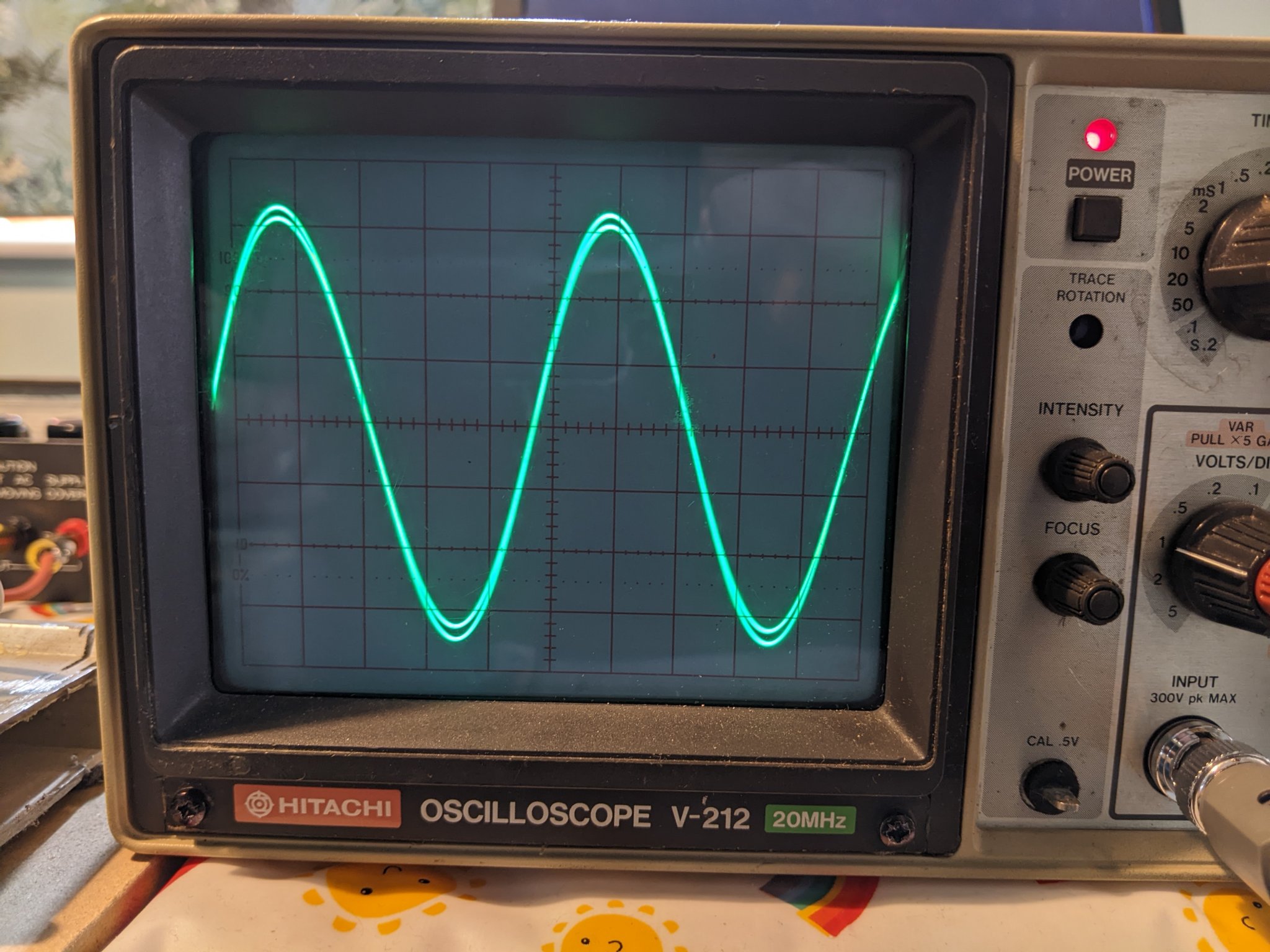

I've replaced the offending transistor, and the clipping is gone 🙂
The right channel sine wave is a slightly bigger than the left. I'm guessing this could be the volume pot? Well, I suppose it could be anything. Does it matter?
The difference in amplitude might look a lot but in practice its miniscule. Also be sure to check its not the scope. Use one channel and make the measurement, then transfer the probe to the other channel.
As you say, most likely a pot matching issue... but its actually very close.
Channel 1 lets say is 6.3 volts peak to peak and channel 2 lets say is 6.7 volts peak to peak. That is 0.5db matching error which is close.
