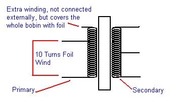

Eva said:Winding interleaving is intended to reduce leakage inductance. How a single extra turn can cover the entire winding? Is it a piece of copper foil?
Evita, see the attached diagram. The winding is done by copper foil.
Eva said:Does it cover the core too?
Only Bobbin is covered with this extra turn
Winding order is S
The extra turn has no external connection, its end is terminated and insulated with tape, but it covers the whole bobbin just like a shield.
The core has another copper foil wrapped around it covering the bobbin and core externally, but its connected to Live negative BUS of SMPS.

#Workhorse i had a similar idea some time ago, maybe its same:
to cancel the switching spikes, transfered by the stray-cap. from the coil, you could use a switching signal with inverted phase, and couple this with some stray-cap. also...
so most transfered energy from stray-cap. is canceled, without needing a big Y - cap.
maybe this "free" extra turn does exactly this...

alfsch said:#Workhorse i had a similar idea some time ago, maybe its same:
Exactly, The extra turn is out of phase with primary winding, thereby helps in minimizing distributed stray capacitance.
