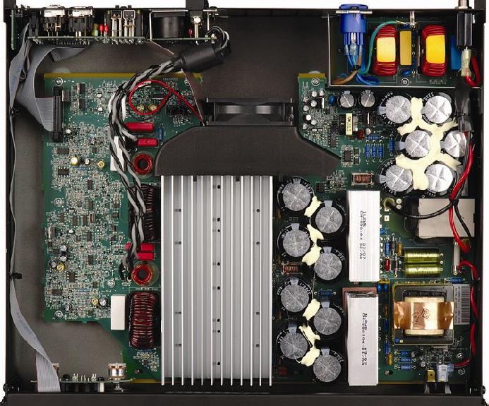

This PL380 features all smd construction, good for marketing hype, but not that much reliable when it comes to survive transportation jobs loading, unloading. I have seen many bad smd components displaced/broken pcb pads just due to vibration on plx3602.
Evita this amplifier conducts huge EMI, we had it tested on live stage and found that it interferes greatly with cordless mics which are working in VHF band. Their is no proper uniform groundplane on the PCB, but it still amazes me that this thing uses 4-Layer board.😉 . The Filter Toroids are mounted very near to the analog signal processing pre-amp opamps, therefore all the small-signal traces are highly contaminated. Idle Rails are +/-190V sag to 120V when subjected to 100mS brust of 1KHz at 2 ohms load. I can't understand how they are stating 4KW@2ohms per channel.

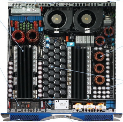

from the layout it doesn't look like the amp was built from the ground up to deliver 8000 watts but rather looks like they simply took a PLX 3600 and turned it into a class D amp with some boost in output resulting from it
maybe they took 3600 watts multiplied by 85% efficiency and divided by something like 40% efficiency and declared that the new amp is thus 8000 watts 🙂 lol ...
does anybody have an image of an I-Tech 8000 internal layout to compare this with ?

ionutgaga said:Have a look on this: PowerSoft 2 x 9kw @ 2ohm....
you forgot to mention that powersoft amp is also 1RU high so those parts (caps, heatsinks) are twice as small as they look
