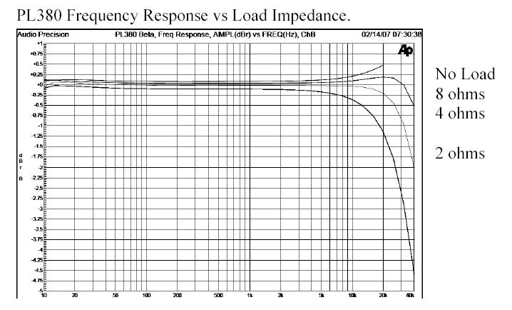

You don't seem to understand class D. This amplifier can actually provide substantially more power than the class H models with less input current from the mains plug. This is particularly true when driving horn loaded bass systems whose impedance is highly reactive. 230V AC 10A is should be enough to drive such an aplifier into clipping with music. Anyway, the power supply would fold back if you attempted to draw substantially more current from mains in a sustained way.
Read the specs Eva - it in fact says Full power sine wave 100A - yeah burst only, still it's what it says.
I understand class-d and class-h, what I'm wondering is why QSC only makes their top powered amplifiers class-d? Why not also make lower powered models as class-d? Why do they continue to make their lower power models as class-h? They can get the same benefits of class-d even in lower output power/wattage amplifiers.

8000W 100A
Specmanship to the extreme.
Rule of thumb is 4A/mm^2. Look at the wire on the toroids in the input filter. Look at the transformer.... You get bigger ones in TV's.
if you look at the specs more carefully you will notice that the power draw of this amp is 18A which is perfectly consistent with your 4A/mm^2 rule of thumb
this transformer operates at something like 100 KHZ, its part of a switch mode power supply. its as big as it needs to be.
8000W is music power, not sinewave power

That 20A circuit could drop up to 3% at full load. Add an extension cord and drop some more. Every time the kick hits and the clip light comes on for more than 1/120th of a second you're gonna draw that 100 amps. Then the mains drop by 15%. It comes back up in between, but that's not when it's needed. So much for 8000 watts. Now you've got 6500. Full power is gonna take a dedicated circuit, overkill on the wiring, or both.

The wire on those toroids still looks a bit thin but I suppose it is exposed so we might up the 4A/mm^2. Looks like the transformer might manage to be about ETD59 size so my telly jibe might have been misplaced.
So..... It's an 1800W for $2700 amplifier.

Don't go blaming it on this amplifier. They're ALL built/measured/spec'ed this way. Nominal operating condition is 1/8 power, pink noise, into nominal (not minimum) impedance. Class AB, H, D, you name it. The old CS800 could put out 800 watts sinewave from now till the power company turned your lights off but those days are gone. An 8000 watt amp built to run that way would add another zero behind the price tag and weigh 100 pounds - even with a SMPS.
Which is why I'm fed up with this stuff and build my own. I've gotten spoiled to the old school and wish they'd build amps with modern circuitry that had the same oomph as the stuff from the 80's. Modern amps are not *bad* - just not what they could be.

ok i finally understand what your problem is. i can only imagine you designing a fighter jet or an attack helicopter or something ... you would overbuild every part by a factor of 10 and the thing would be too heavy to take off.
believe it or not professional amplifiers actually are much more desirable when they are LIGHT AND SMALL which is of course exactly the opposite of what you prefer.
well then go ahead and build a 200 pound class A amplifier and brag that its 50 watt power rating is more "real" than another amp's 8000 watt power rating.
for a sound reinforcement application nobody would take your 200 pound class A amp even for free.
for your information the I-Tech amplifier is regarded as one of the best subwoofer amplifiers by pros in sound reinforcement and it only weighs 15% more than PL380.
i hope you enjoy listening to sinewaves ...

NO MUSIC approaches the energy content of a sinewave. the best ( actually the worst ) any music can do is approach pink noise which is several Db less energy than a sinewave.
its not a sound engineering practice to design a product for an application other than the one it will actually be used for.
NOBODY BUYS AMPLIFIERS TO LISTEN TO SINE WAVES
a formula 1 car is not a farm tractor. and just because the tractor has more torque and longer mean time between failures does not make it a superior racing machine ...
i suppose a race car's engine horsepower is not real because you have to rebuild the engine after every race ... too bad thats exactly what its designed for. but, but ! but what if i want to use it to tow a trailer to florida ? TOO BAD
