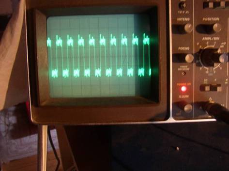

following your advice, I've just removed the CS8405 ( actually in my QA550 was a CS8406 ) . Unfortunately the problem of unclean square waves remains the same. I've attached a photo of the BCK signal in my old scope.
Any ideas?

Hi Alesandro,
I had a look at your picture of the waveform and in my opinion this is not such a bad thing. The good thing about that waveform is that the rise time seems to be very fast, and the edges are clean (but hard to tell with that photo). Data is clocked on either the low to high, or the high to low transition. The appearance of the top and bottom of the waveform is unimportant, as the data has already been clocked before the wave even gets to the top or bottom.
Perhaps you could set your CRO to look at the exact rise time
from low to high signal, and see if you are getting any distortions or unevenness to the edges?
Perhaps it is an issue with noise on the voltage rails? Have you checked the DC input to the microprocessor to see is there is noise on the DC rails? Perhaps you could add some capacitors near the power supply pins to remove any noise that might be causing the unevenness on top and bottom of the waveform.
anyway did you notice a difference to the sound after removing the CS8406?

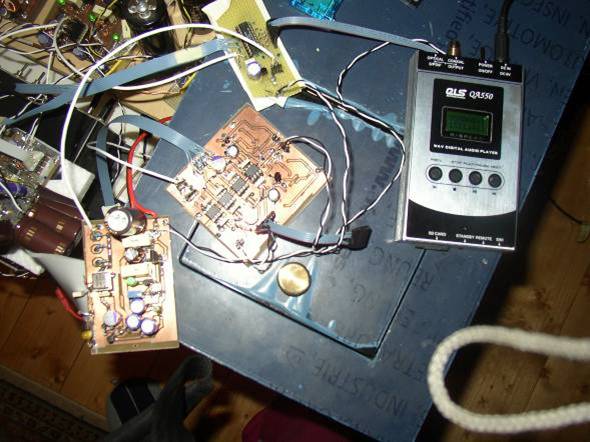

Hi Erin,
thank you for your e-mail.
this weekend after a new mod I can agree with you: the oscilaltions on the top & bottom of the waveform are not so important.
To prove that I made a decuplig board using four IL710 digital isolators.
The oscillations on top & bottom disappeared, the squarewave where clean but sound seemed less "quick" and precise.
So I turned back to my previous setting: a simple 74ALS244 i use to strenghten the I2S waves. ( I had problems with the L/R clock signal: it was very "weak" and could not drive my dac).
Thank you for your advice: I've bought a bunch of Murata 10uf SMD Caps. I'll try to paralles / substitute previus cap. Hope to succeed: SMD caps are sooo little
Yes, oscillations on top/bottom seemed to incresed, but sound appeared to me "quicker" and "deeper".
I've attached a photo of the boards I've built:
-on the center the IL710 decoupling board (not conencted)
-on top the simple line driver with 74ALS 244.
-on the bottom left you can find the X0 clock from guido Tent ( battery powered)
-on the top right our little QA 😉 ( battery powered)
I'm planning to build also a new clock generator for BCK and L/RCK using a circuit based on 74169 as shown in Bunpei thread to see if sounds improves.
Bye alessandro
