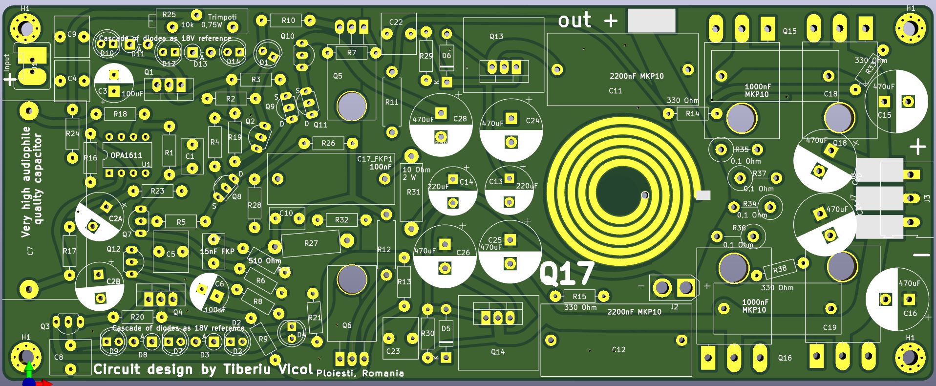

I have created a list of Reichelt components, so it should be easier to order the components. This component list is for the assembly of the new board. There are two 8.2k resistors in it, that is R23 and R24. I think these values are ideal. I use the 33nF FKP2 instead of the 100nF MKS - I think I already mentioned that.

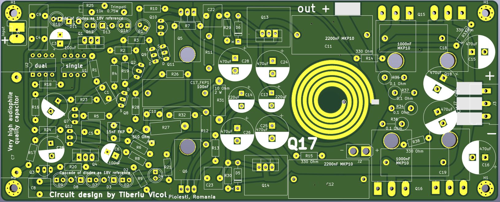

Tim,
I'd test with Muses-01 and other regular op-amps. I don't plan to use smd parts though.
Is it possible to use dual op-amps in the DIP8 socket in your pcb?
HTML:
The pin assignment of single and double amplifiers are different.

You' re really funny, I only just now noticed that the Muse01 are from JRC, I always threw away the OP of those as they play really stubby and dead. I wouldn't set up the amp with them, even if it works well with them.
We all are different, aren't we! Muses01 exceeded my expectations in sound signature in a pre-amp application. Got few of those left over, not cheap though. No harm testing those in Q17. We shall see how it goes.
Got plenty of other regular op-amps available as well. If the current pcb doesn't allow op-amp rolling, it should be considered as a room for future improvements.

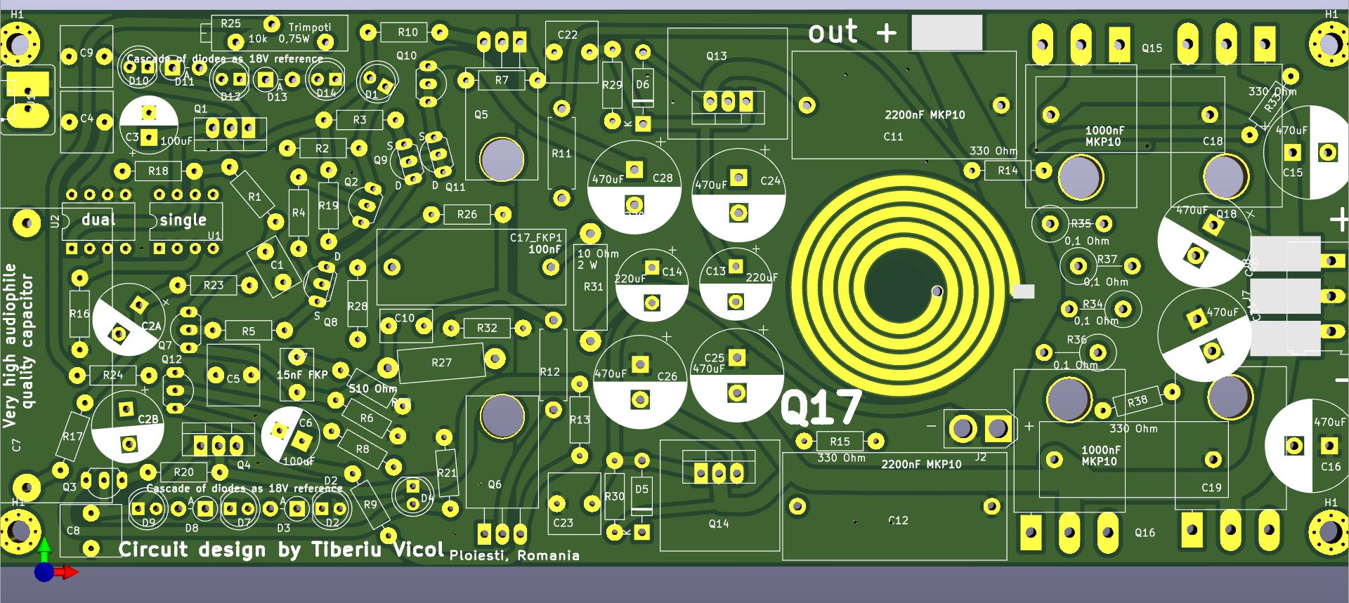

The space doesn't get any more on the board, but that's how it should go. I have connected the inputs of the unused OP to GND so that it doesn't do anything nonsense.

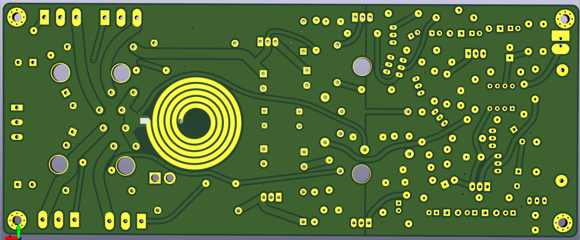

Hi Tim,
I'm making a BoM for the pcb. Where do you install these parts?
2x LT4320IN8-1#PBF
8x CSD19503KCS
2x 100nF
2x (or more) ALC10S1103DH
On the power supply board?
Thx

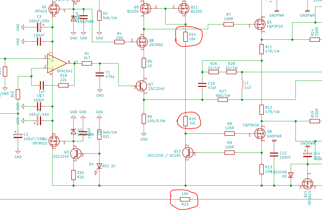

Yes, I have changed the size of the two resistors.
The amplifier sounds a bit more "real" with the 8.2k in the DC servo.
R24 in 8,2k with the 10k potentiometer allows a control range from 8,2k to 18,2k so you can adjust the driver stage of the amplifier to the supply voltage from about +-33V to +-55V.

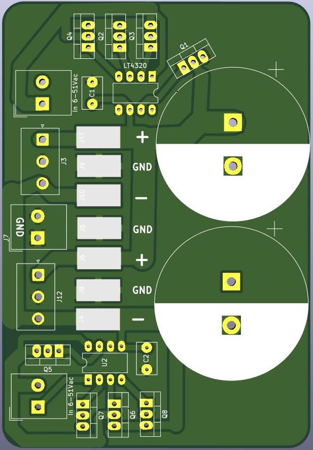

I have drawn another PCB (not as nice and compact as Tibi) for the active rectifier with the space for the cheap cooler - although this should actually be unnecessary.
Reichelt: 576802B00000G
I find the cooler super practical, as it works very well with a small load.

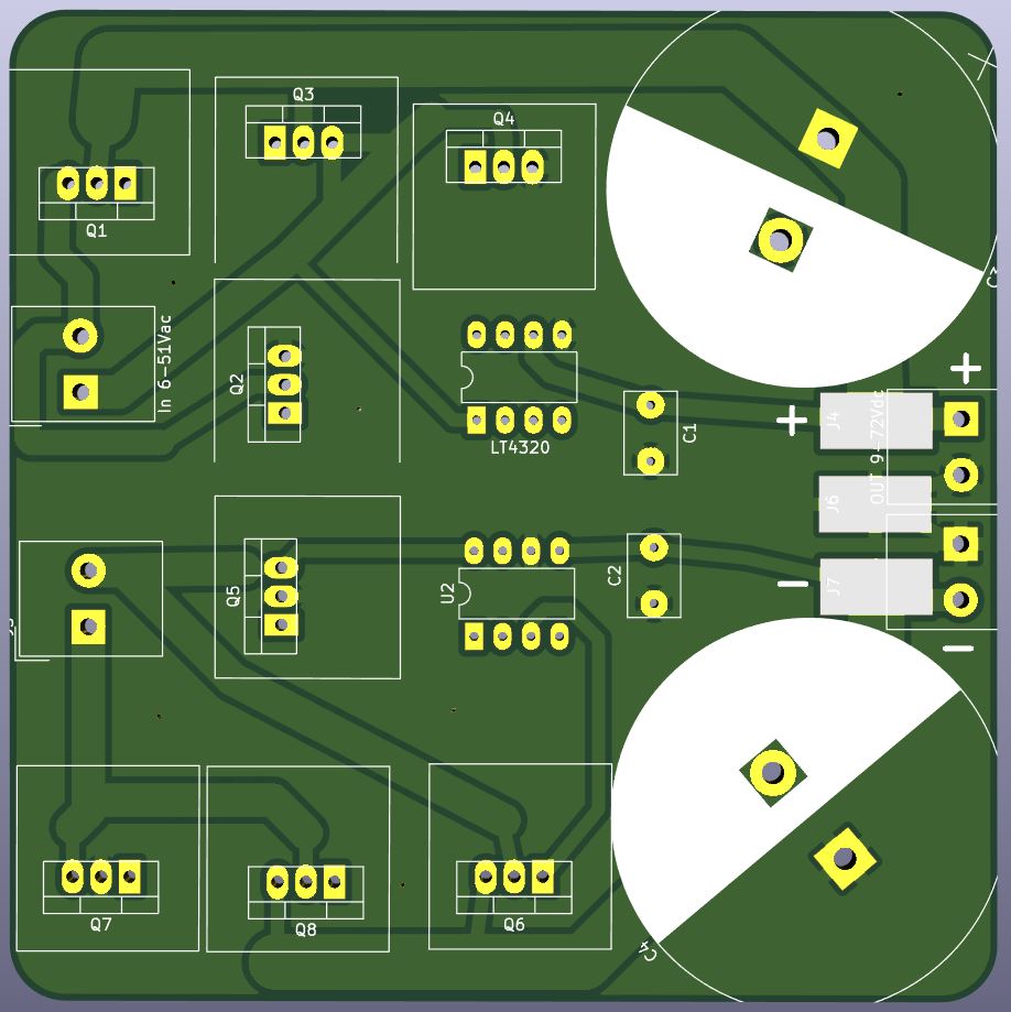

I suggest you to rearrange LT4320 in that way that traces from chip to mosfet gates to be shorter.
Move C1 and C2 as close as possible to LT4320.
Mosfet's do not need heatsink, therefore use the space for capacitors or anything else.
Tibi
Tibi
For original DIP-8 OP this variant is easier to change the ICs. The connection of the C7 is no longer in the way.
I do not sell this board.
Tim,
I'm sending the Gerber to JLCpcb. Any further refinement are you planning on the current pcb revision?
Thx
Tibi
i think that's how it's useful. I also attached the GND for the speaker outputs and the solder pads for the many cables for those who like me do not want to screw.
