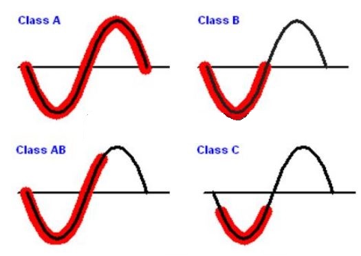

Class B has a conduction angle of 180 degrees. Class A has a conduction angle of 360 degrees. Class B cannot possibly be anywhere near class A, but it can be near class AB, which is everythigni N between.
Would this representation be consistent ?
No.
You have pozitive side on class B and C as well.
In class AB, a very important factor is how much power in class A will amplifier operate. You may have a class AB amplifier that will operate only first 1W in Class A or an amplifier that will operate first 20W in class A. Both are class AB amplifiers. The main reason for class AB operation is to avoid crossover distortions, who are big on class B and huge at class C.

It's not a question of what I want. It's a qiuestion of conduction angles. It is class AB. There is nothing else you can call it.

Tibi,
First of all: great project! IMO the classic current dumping principle is worth a new life! (I will order synchronous rectification boards).
Not wanting to debate the class of operation, but you caused the confusion by stating that "through R11 and R12 the output devices will be biased near to class A operation".
Well, with Iq under 100mA, the output stage is class A up to well under 100mW, class B for higher power.
Your statement in post #71 is correct; "near to class A" has no meaning.
An amplifier will always run in a single class, not combination of two
False. It can depend on the level. Some Class A amplifiers slip into AB at the highest levels. Nominally Class B amplifiers can be slightly into AB if overbiased.
So, when an amplifier will run in Class AB, in fact will run in class A up to a level and after that in class B. For me class AB is just a description of operation in class A and then B.
This is not only false but nonsensical, because (1) you are contradicting yourself, and (2) you are stating an impossibility. (1) What you have now described is not 'always', and it is indeed a 'combination of classes', which depends on level: but (2) if you can find a Class A amplifier, conduction angle 360, which is capable of running in class B, conduction angle 180 (without a mode switch) please produce it. It would be a remarkable piece of work. And, again, it's not about you. It's about conduction angle, an empirical fact, not a personal opinion.
We can debate this a lot, but in the end we may both been right.
You can't be right when you're contradicting yourself. You have to choose.
Class A = 360 degrees conduction. Class B = 180 degrees conduction. Class AB = say 181 to 359 degrees conduction. Your claim that class B is adjacent to class A is therefore false by at least 178 degrees. This is where we cannot possibly agree.
