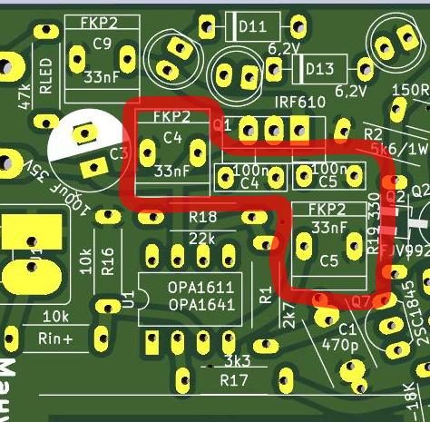

Tim,
I would suggest you to move decoupling 33nF capacitors as close as possible to opamp.
I think your intention, with R22 and C27, was to limit amplifier BW, but in fact you created a new Fc pole where the amplifier gain will increase, because R6 is part of negative feedback together with R27.
A better solution would be to use an inductor in series with R6=100.
Some fast calculation: for Fc =1MHz L=R/(2PIxFc)=100/(2x3.1415x1000000)=16uH
This will create a pole at 1MHz where amplifier gain decrease.
Tibi

Hello Tibi,
either my LTspice model is completely wrong, or there is some unusual behaviour in the system that could be eliminated with a capacitor + resistor (2,2nF+10Ohm) on the collector of Q12. Can you please check this in your simulation model?
I am comparing the frequency responses of gate Q5 and gate Q6.
Regards Tim
Regards Tim

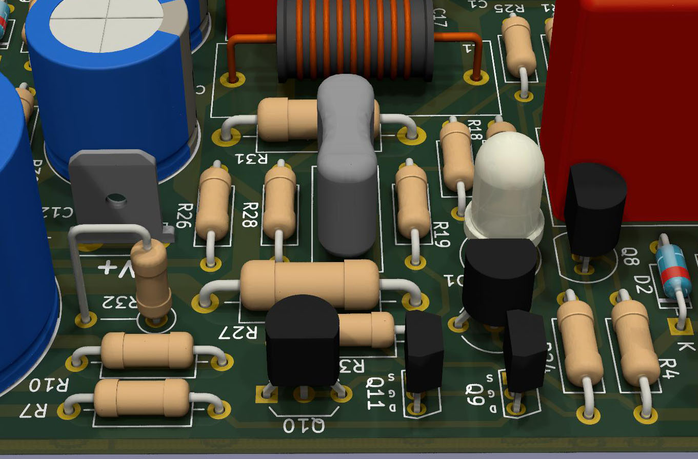

Hello Tibi!
Short question for you. For R27 in the bridge, you used an Ohmite 560R carbon 1W resistor.
Is it intended to use carbon there?
I ask because it is big this kind of resistance and the place is counted on my PCB.
Stef.
Stef.
A non inductive resistor will be best here (R26 R27 R28).

5W ???
I already don't have much space but a 5W ...
Stef.
ok. 😉
Times are tough. The DALE 1W some is the series (CPF, ALSR, etc.) are sold out for 560R and I do not have a 560R Dale in stock.
I was planning to put a sorted Vishay PR01 in the meantime. The Ohmite carbon is definitely too big for the PCB.
Stef.
Stef.

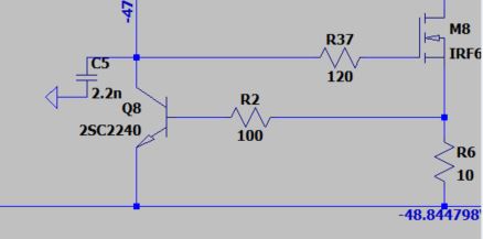

A failed experiment:
i tried to understand the simulation of the Q17 with LTspice more closely. I have a model in which the FQA and FQP MosFET are placed. Thereby I have the gate voltages displayed. When the driver stage has a small offset, the gate voltages become more similar in level. According to my understanding the class A driver stage works very unbalanced. Therefore an experiment:
At R13 = 8.35 ohms, the DC offset in the simulation drops below 1mV. R10 remains unchanged at 10 ohms. Therefore I soldered at R13 to the 10 Ohm resistor a 47 Ohm resistor (approx. 8.3 Ohm) to listen in reality how the amplifier plays. The special: it does not play. But he has pulled the 600W of the transformer (only one module), because the fuse of the transformer with 3,15A (at 230V) has tripped. After rebuilding it doesn't play either, but I didn't take the time to find out which components were destroyed. I assume it was just the small transistors oscillating at very high levels in the high frequency range.
I find the experiment very interesting because I created only a small asymmetry in the structure, and the amplifier destroys itself.
This was now the 3rd Q17 that has broken while making slight modifications.
Therefore, be careful, prudent and sensitive to the Q17, it is a work of art when it performs to its full potential and a mimosa when you try to modify it.
Regards Tim
Surely the topology of the printed circuit board is not the last influence.
...Therefore I soldered at R13 to the 10 Ohm resistor a 47 Ohm resistor (approx. 8.3 Ohm) to listen in reality how the amplifier plays. The special: it does not play. But he has pulled the 600W of the transformer (only one module), because the fuse of the transformer with 3,15A (at 230V) has tripped. ...
Can you please measure again your 47ohm resistor ? What you describe may happen with a 4,7ohm one.
Tibi
