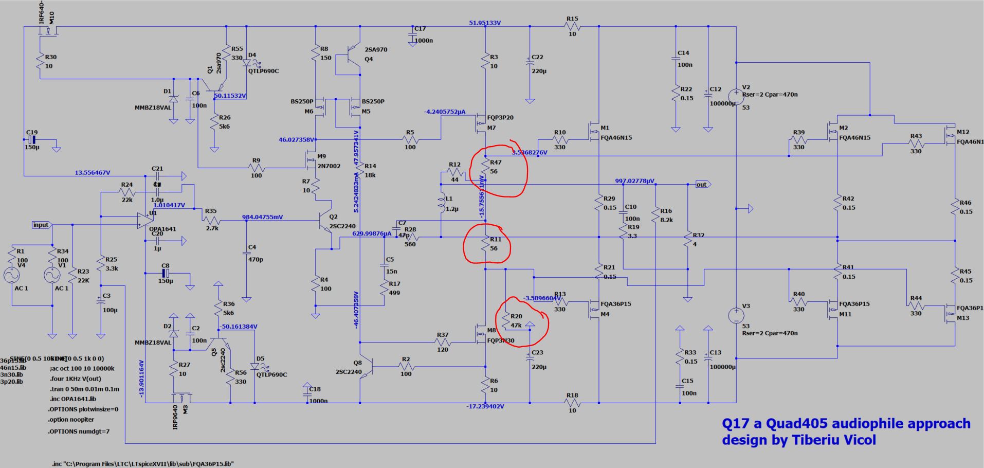

The extension of the Q17 by output stages with MosFET FQA leads to an increase in switching faults of the output drivers. As the Q17 is operated at the class B border, the deficits are increasing, which is why nobody wants to build class B.
Now there is the problem that increasing the switching voltage of the output transistors - as you suggest with a reduction of R10 and R13 - leads to destabilisation of the amplifier circuit. Increasing R11 and R12 is less critical, but not without problems. Since the installation of capacitors as damping of the driver transistors is a crutch, I have tried everything possible for a very long time. Finally, I ended up with 47k ohms to ground. With 100k Ohm, the simulation is still not ideal in all cases. That's why I had to lower the value further. So with the increase of R11 and R12, as well as the additional resistor, I get simulation results that can be compared with your Singel model.
Regards Tim

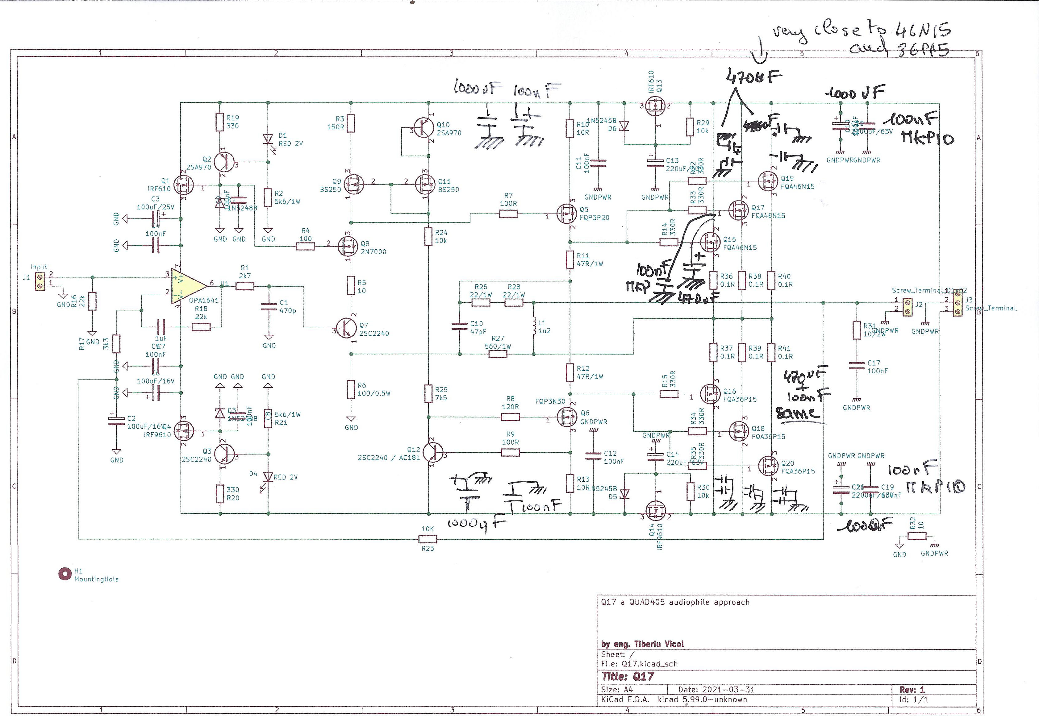

I was looking at the diagram of the version with 3 pairs of power transistors. I would have a suggestion for the power supply of the circuit on the PCB board.
Instead of putting a single large capacitor at the input of the power circuit, we replace it with a smaller one of 1000uF and we add a 470uF/100nF duo at the foot of each 46N15 and 36P15. Another 1000uF/100nF duo is also added to the "small signals" part (before Q5 and Q6) to supply this part.
What do you think ?
Incidentally, I would have liked to know the consumption in Amp per rail of the circuit with 3 pairs. For a 60v supply.
Stef.

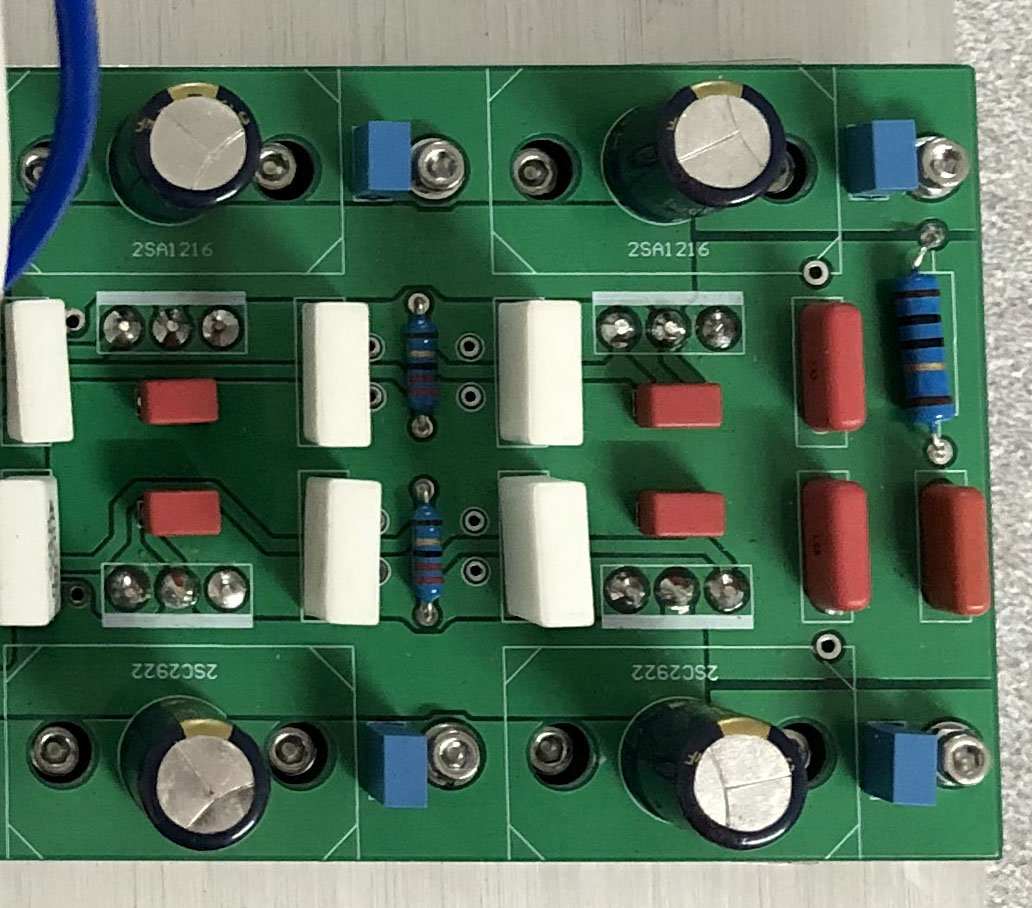

Decoupling each final transistor with a dedicated large cap and a MKP improve amplifier stability and response in medium-high.
Having large capacitors near output stage make sense and in fact this is the way many high-end amplifiers are designed.
AlexMM and Sorin Q17 PCB's are designed such way.
DanZup have started to mount AlexMM pcb and will have some feedback in the coming days.
However, sourcing quality parts is harder by each day.
Tibi

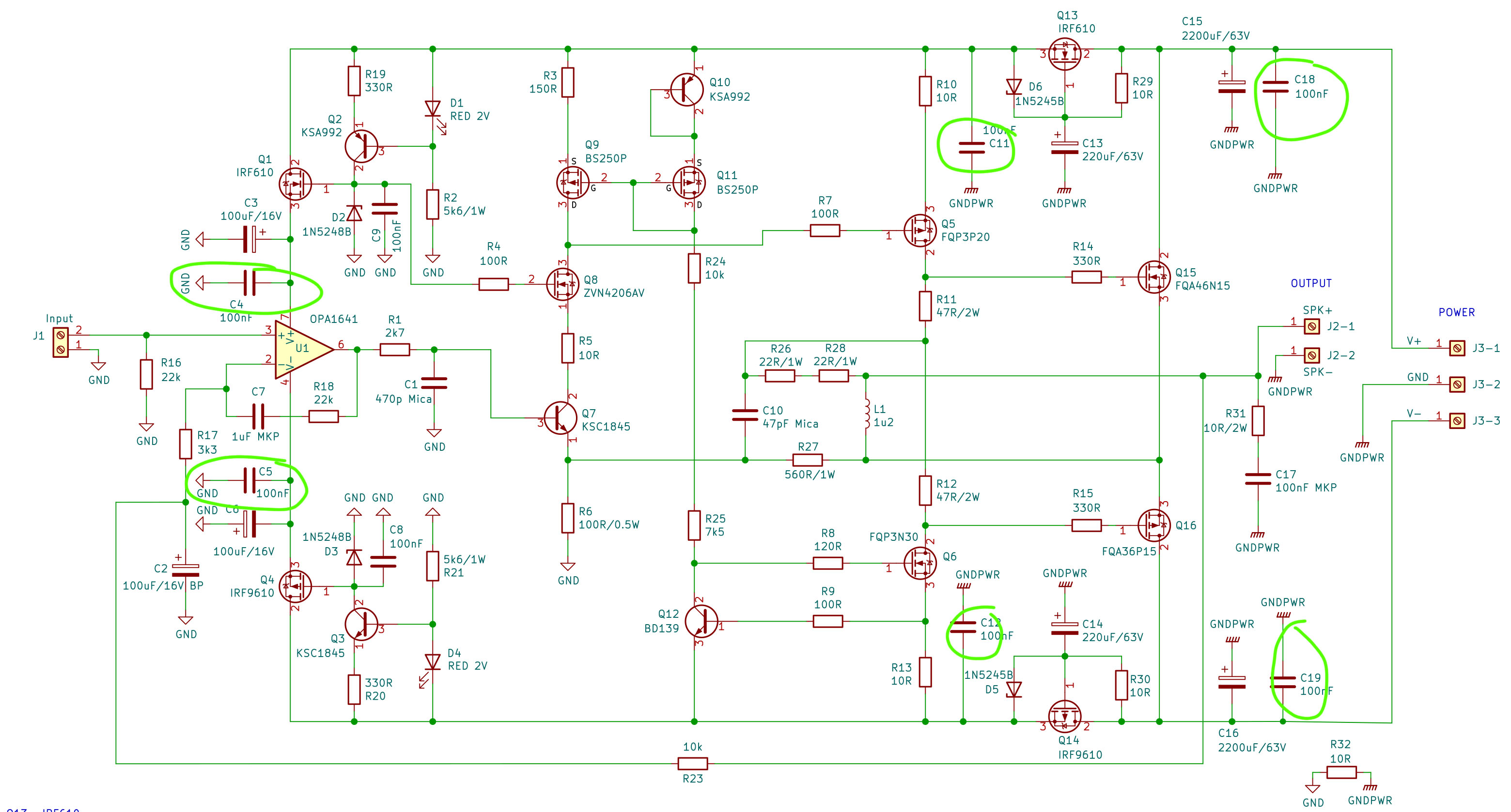

I was looking at what it was possible to remove as component on the base circuit to save space (to use better resistors at some place, but bigger resistors).
Do we really need all those 100nF capacitors?
Electrolytic capacitors now have so much with low ESR (was not the same 30 years ago) that I'm not sure this is useful and in addition small film capacitors in parallel with the electrolytic capacitor inductance can create an oscillating circuit.
An opinion?
Stef.
