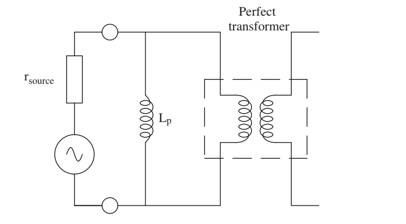

Then it should be clear now that adding a serie resistor makes the voltage distortion bigger.
You still don't understand the adding a resistor is the SAME to put a Rp of a tube!!!!!!!!!!!!!!!!
Equivalent circuit ( from Jones) it is common rapresentation of a low frequency circuit
The generator and Rsource is a TUBE; the Lp is the inductance of the trafo
And in a real circuit is not possible to omit
There is no sense ( in my opion) to test the OT with Zs = zero ohm ( or similar)

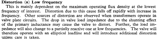

In addition from RAdiotron
"Other source of distortion" is mentioned; in addition, of course, of the one comes from tubes
And it is also true that with the new materials this aspect is better that 60-80 years ago.
But the diagram come from Jensen ( posted time ago) is clear

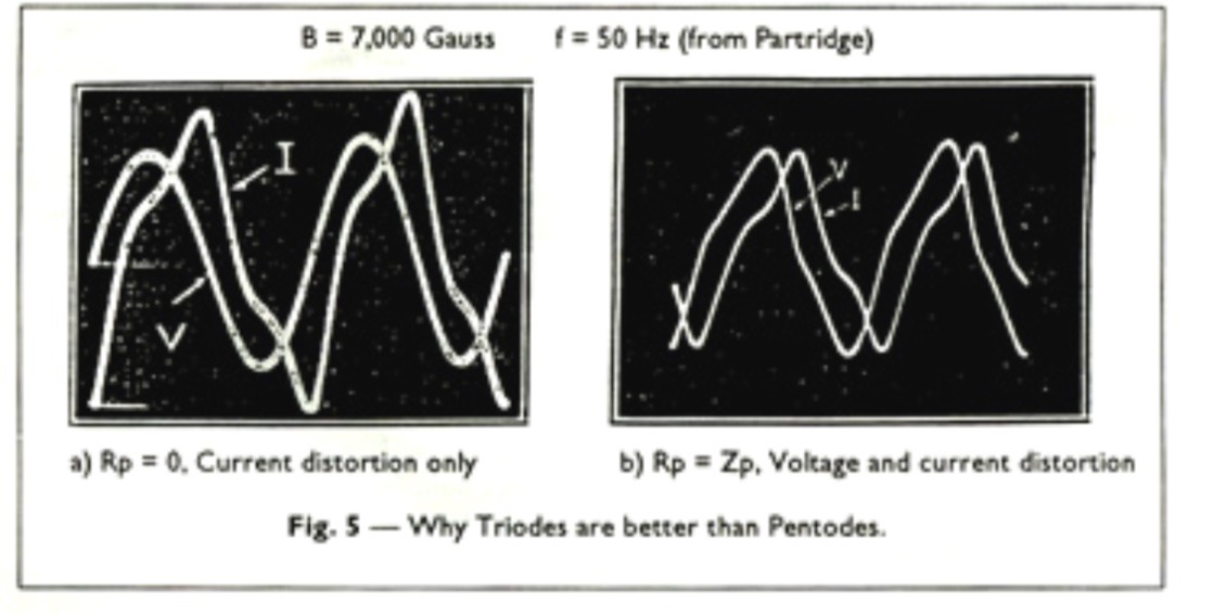

I understand that YOU are the problem. You still did not read the article or don't understand it. Rp is a function of the distortion! ANY serie resistor in line with the source! READ Partridge!You still continue to don't undestand the problem

It was YOU who made a schemetic with a serie resitor of 6 Ohm and a secondary resistor of 2500 Ohm and presented it as the right way and easy way to measure an output transformer in a reverse methode.
Timpert showed you that your methode will not give you the right frequency respons in real life if you use a triode tube (as a 300B).
The articles of Partridge shows that if you use your methode you introduce voltage distortion. In real life we will also not have a source with zero impedance but that is another problem. You did measured with a to high resistor.
You still ignore Partridge and you not have given any proof that Partridge is wrong!
