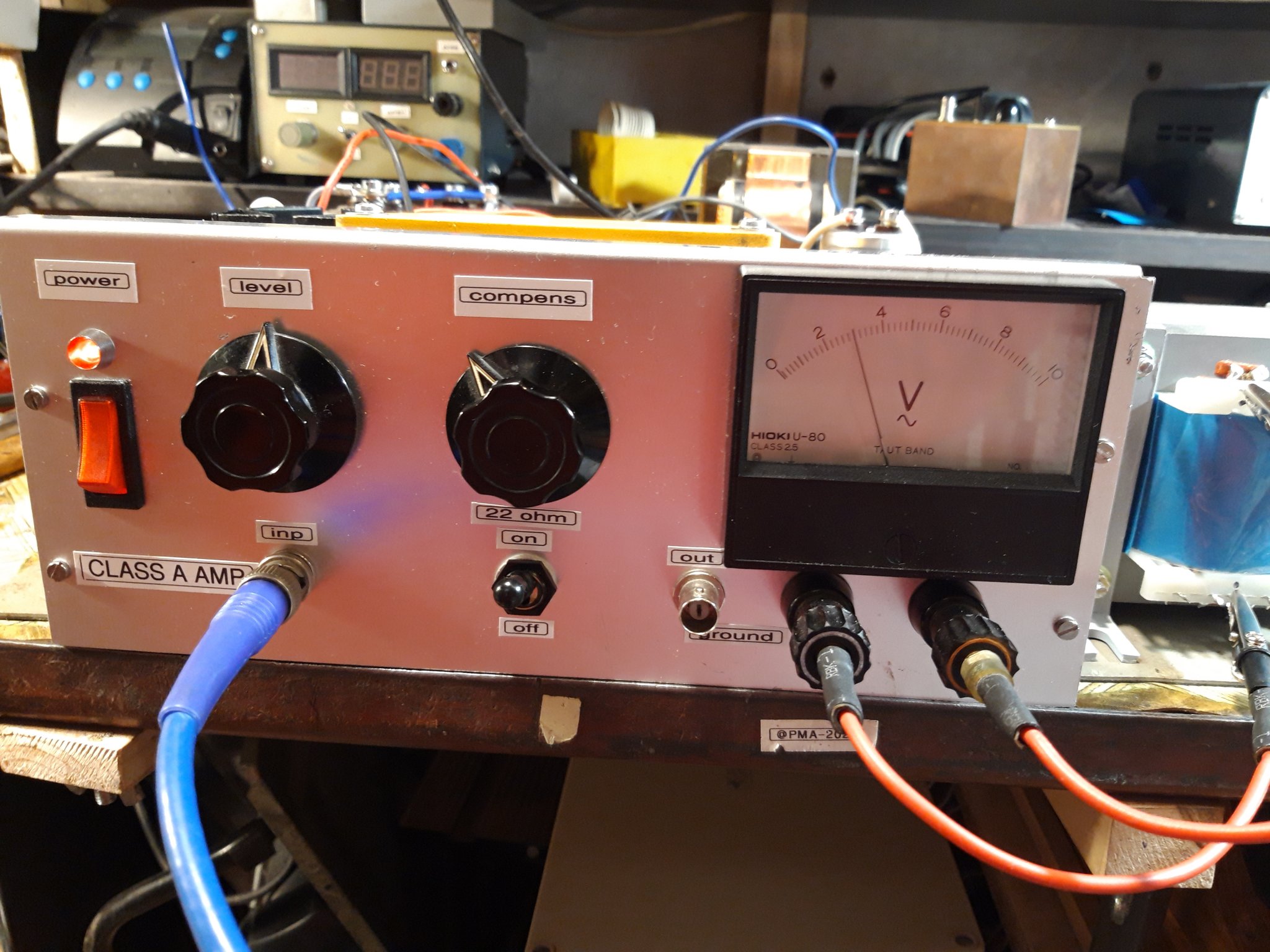

Exactly, the OT used for attack of the tube is identical to the one in the anode and the adjustable resistor of 10 ohm makes the correct Zp/Zs adaption ( sqw 10 Khz so that there are no overcresters on the ascending/descending fronts). The simultaneous two channel verification of the oscilloscope of the inputs signal on Ug and the OT secondary will show the influence of the bias current, the Rp of the tube and with a dB-meter frequency band
Your schematic in post 67 has variable voltage distortion because of the 10 Ω rheostat.
You did not understand, the adjustable resistor only sets the correct adaptation of the transformer used for the attack, after which only level in the generator/amplifier with transistors with an insignificant THD is changed
Right!
It was difficult to explain to some people this concept.
Every OT is a bi-directional device when properly colsed at the terminals with a linear device as resistors.
I suppose that your test set up is similar to mine.
And this helps not only for s.e. but also for pp with proper setting ( and the possibiity to switch or not the dc current)

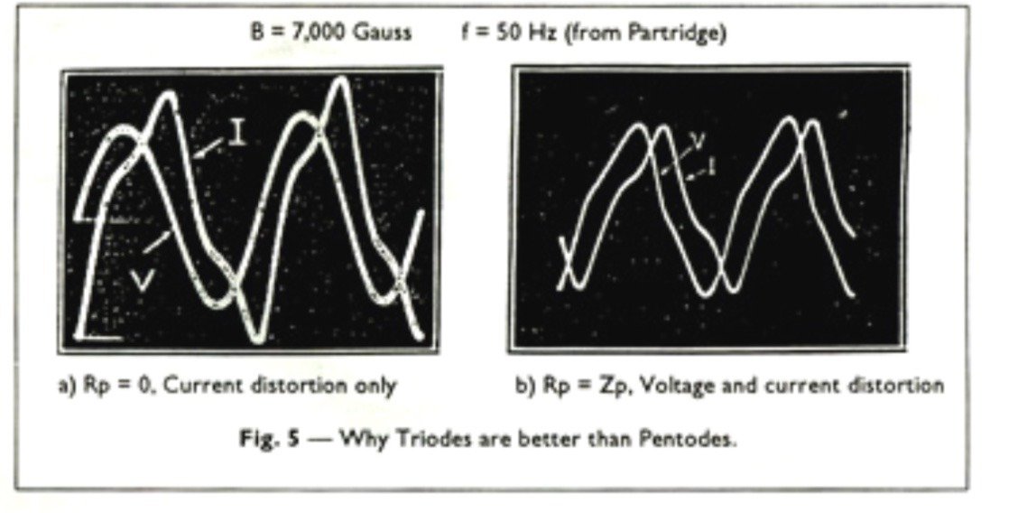

I am reding the document by Hodson; he copied and past some concept fro the Partridge articles ( 4 articles) that I have already mentioned. Then there are some concepts that are hazardous.

Maybe you both read, or tried to read those articles but you both ignore what is written by Partridge. It’s no problem that you don’t understand the theory, you are free to do measurements your way but for me and others it is clear that you do useless measurements.
