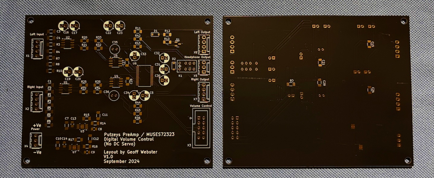

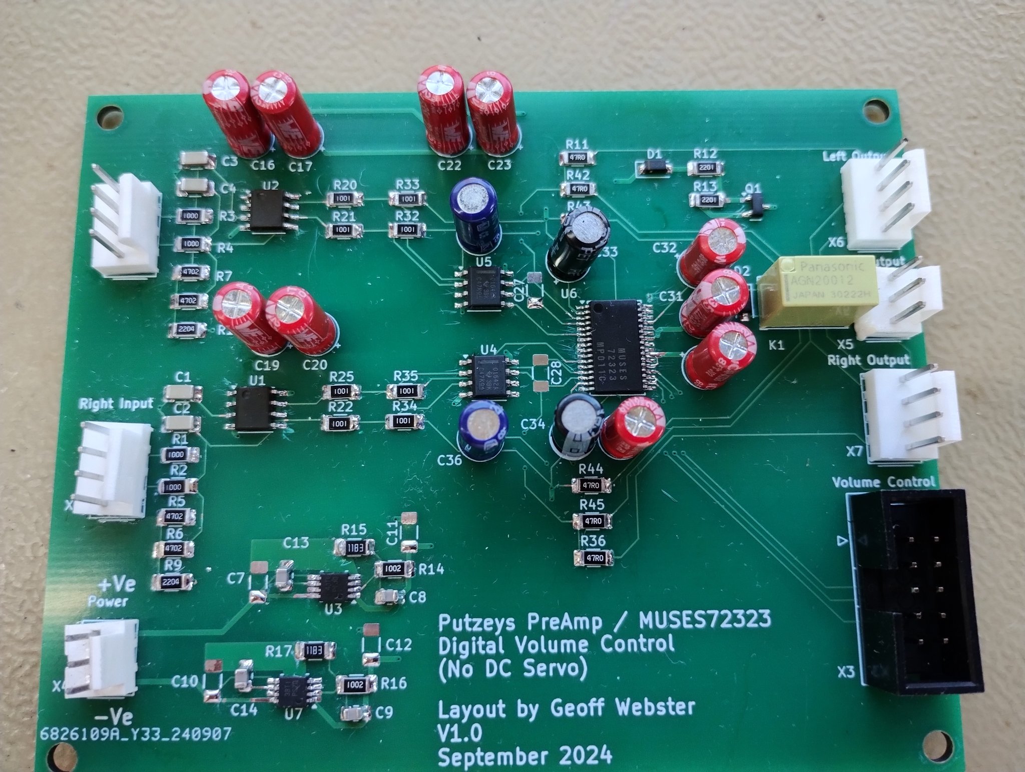

10uF capacitors now fitted and new board with relay and ultra-low noise LDOs fired up. Abject failure as +/- rails measured 1.26V. Looking at the schematic soon showed this week's deliberate mistake - voltage divider resistors between the voltage output, V-feedback pin and ground were the wrong way round. Swapping them over resulted in +V rail now being +14.99V but the -V rail is just not working at all. I can't get any more diagnosis done today as it's the wife's birthday so need to open the odd bottle of fermented grape juice. More soon
Reactions: Deenoo
Reseating the -ve LDO succeeded in getting a negative voltage on the board However, it was the same voltage as the input. Checking all joints, component values and chip alignment didn't achieve anything so the end result was removing both LDOs and associated components then fitting links in their place.
Next discovery was that the diode across the coil winding was fitted correctly according to the schematic / layout but in fact was reverse polarity. This prevented the relay from opening causing no output from the pre-amp. Swapping the diode round appeared to resolve this and the relay now opened the contact across the pre-amp outputs. Switching the power off/on to verify correct muting doesn't yet seem to provide correct muting on switch-off so needs more investigation.
Investigations now completed and highlight a few issues with the relay circuit
  1. Schematic and layout have pins 2 and 3 of the relay, and consequently the right channel output, connected to ground 🙄
  2. With the dc input voltages at +/-18V or thereabouts, the relay driver transistor dissipation exceeds the device spec 🙄
So basically the latest version board is a non-starter and needs the above issues addressed.

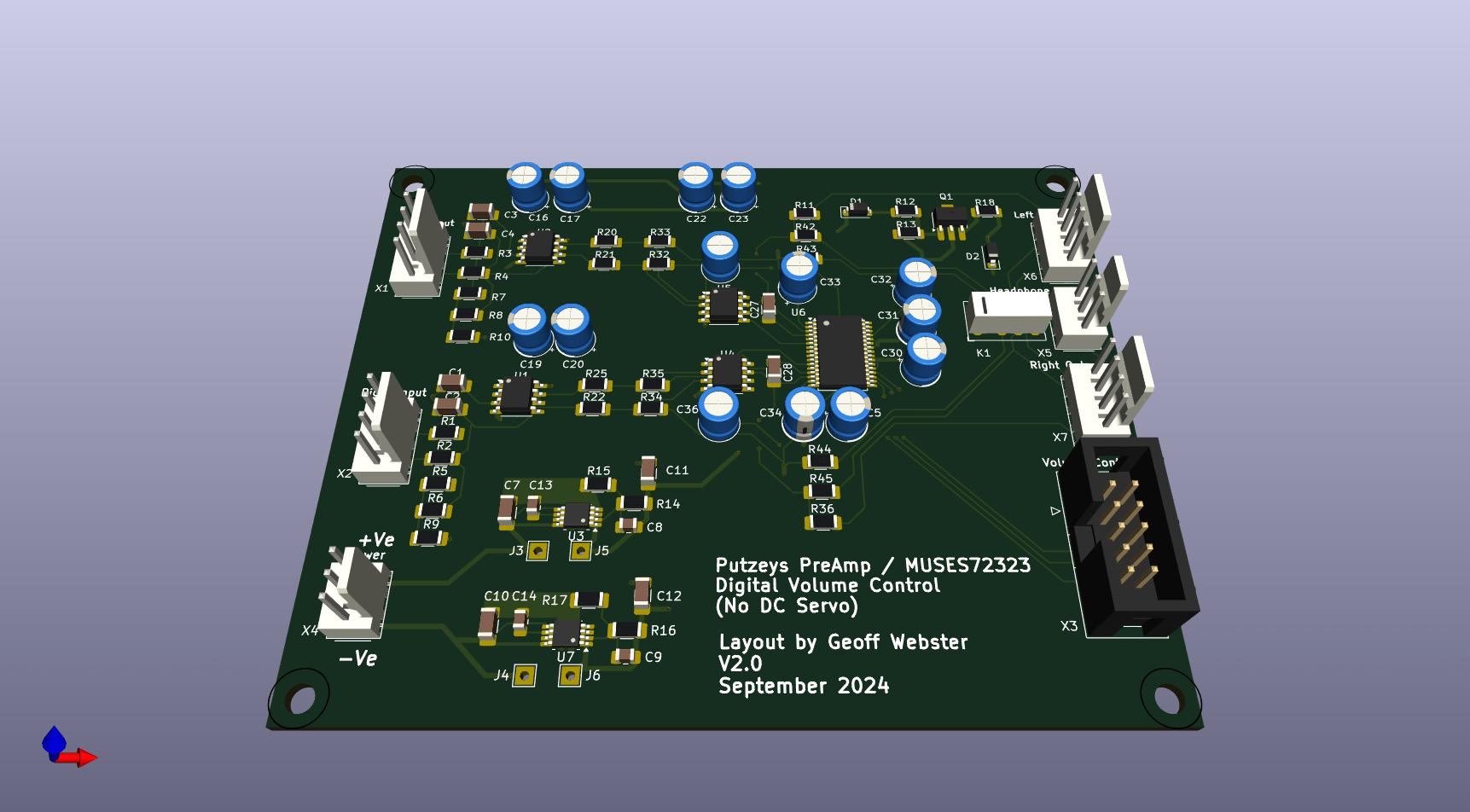

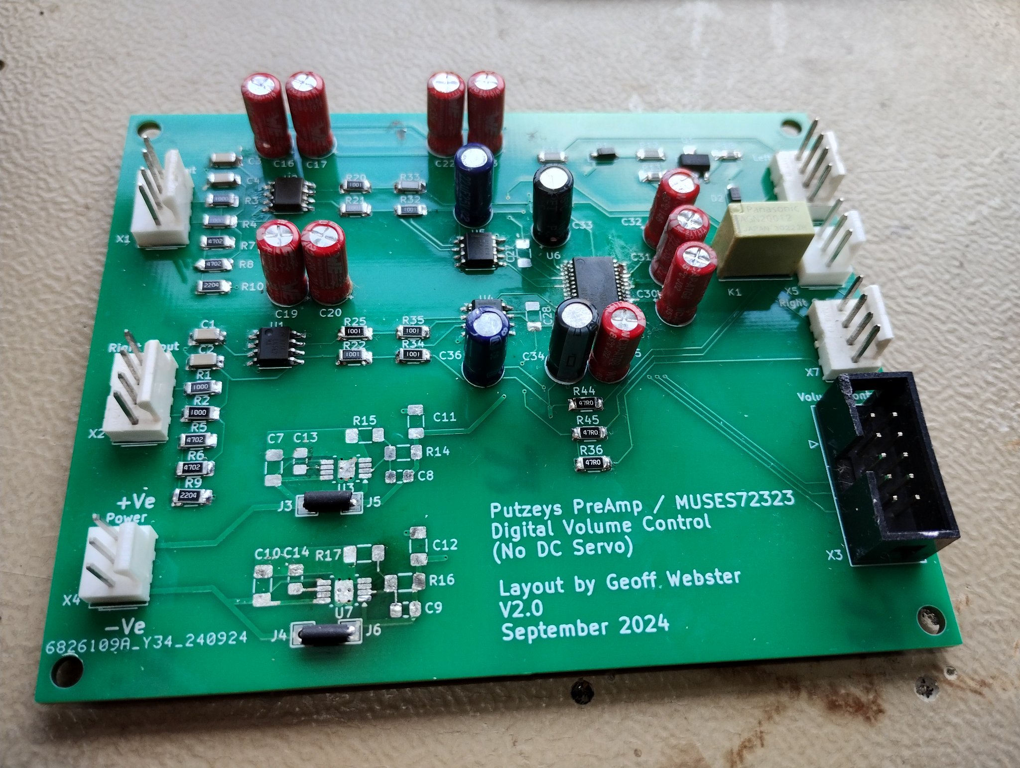

Boards now arrived and built.
Firstly, the ultra-low noise LDOs were assembled with a few solder reflow required before +/-15V was achieved. The rest of the circuit was then assembled and tested.
First issue was that the +15V rail had shut down and the -ve LDO was running very hot. After a few goes at trying to get the supplies working correctly, the on-board regulation was removed and the bypass links fitted instead.
As previously, the pre-amp/volume control sections worked exactly as expected. It should be noted that the pre-amp outputs are very clean and I would suggest that provided a decent low noise regulated supply is feeding the board, the on-board regulation is not needed.
As far as the muting circuit goes, on power-off, the mute relay was not switching fast enough to short out the output and prevent potential speaker thump. Use of LTSpice showed that significantly reducing the value of R13 from 2K2 down to between 120R and 470R would enable the muting circuit to trigger at voltages much closer to the applied supply voltages. The resistance value to be used would therefore require selection so that the muting occurs with only a small dip in the power rail voltage. For +/-18V this would be around 120R. For +/-12V, this would be the original Putzeys G-Word circuit value of 2K2.
From a board rework point of view, the location of the electrolytics between the MUSES chip and the relay makes any necessary touch-up of solder joints on the MUSES pins that are alongside the electrolytics very difficult.
If I were to go further with the board, I would
  • Delete the on-board regulation
  • Consider provision for off-board control of the muting relay (e.g. taking a MUTE signal from a microcontroller)
  • Relocate the electrolytics to provide reasonable access to the MUSES pins so as to enable easier rework of its device pin solder joints
If someone would like to give it a try, I can share the board.

😱😱😱This is Ver 1.0 of the board - it has error on the relay pins such that right output is permanently shorted out. To remove the short circuits on this version 1.0 requires to cut through the ground plane around pin 2 and pin 3 of the relay.
Version 2 (which I'm testing at the moment corrects this along with a few other mods (see posts #94 and #95 above).
